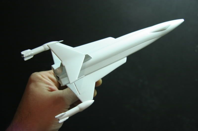

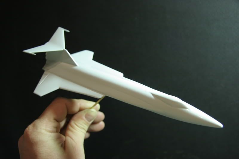

One more coat of paint, and then decals this weekend. Design is based on the Estes "Interceptor" model rocket. Decals will be Estes decals, shrunk to 45%.
Discuss. B)

MMM
It's a 1/72 Revell X-15 from the recent release, with the wings chopped off and repositioned and the extended chines scratchbuilt from laminated styrene. The T-tail is made from the kit horizontal stabilizers, with 1/350 Soviet ship-defense missiles sanded down to make the "spikes". The engine is going to be a spare exhaust from an AMT/ERTL 1/48 X-Wing, cut down and detailed. The belly plow is scratched from styrene and Aves putty.
The Genies are from a Monogram 1/48 F-101 kit. Can't decide whether to make them Italian Red or Day-Glo orange.
