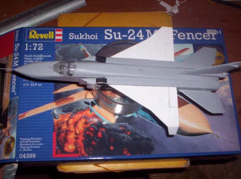

First step to the Su-24 was the T-6-1. Basic fuselage of the future aircraft was already there, but there was two lift jets and... a delta wing with anhedral wingtips.
The lift jets proved disastrous and were deleted on the production aircraft... als, the fixed wing was replaced by a VG system. Lost of time, more weight, complication and in the end, bad handling.
So, whatif Pavel and its team only had delted the lift jets ? The anhedral wingtips were aprently added in the course of flight test.
I think about a straightforward scenario... for the reasons mentioned above, Pavel decide to get ride off the lift jets only. A ballast of concrete replace the engines in the T-6-1, before the T-6-2 makes its maidden flight in late 1968. There's now a fuel tank instead of the jets (or concrete  :lol: )
The rest of the Su-24 history is unchanged... Iraqi Su-24 flee to Iran after GW1.

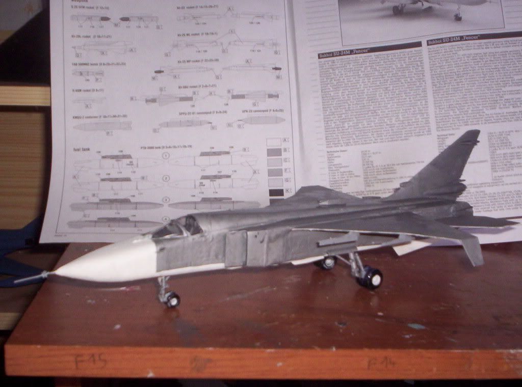

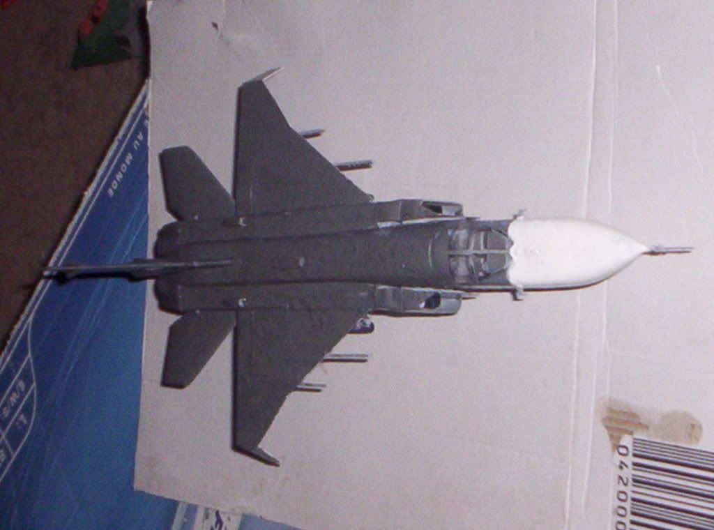

A note on using plastic card for wings, to get the Aerofoil shape you need to laminate a couple of sheets together to build up depth and strength then do lots of sanding and shaping to thin out the trailing edge and to curve the leading edge. They also need to taper down in thickness towards the wing tips. If you check a kit wing them most will be between 2-3mm in depth or more near the wing root.
Use the plastic card to create plugs to extend the intakes rather than tape. Either use a solid block made up of numerous laminations of plastic card or cut a strip of 40 thou (1mm) thick card to the correct width to create the correct shape for the intake plug. Either type can then be sanded/filed to shape to match the rest of the intake and filler used to clean up any imperfections.
