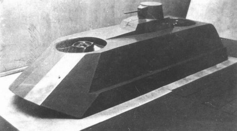

The Levkov L-1 is thought to be the world's first successful hovercraft, though the idea goes waaay back (steampunks please note!)
Link to source of the above pix, with text and the odd extra image: LEVKOV'S HOVERCRAFT - War History.
Hover tank mockup, based on the L-1 work but never built:

And on the historical front, an Austrian naval officer, Dagobert Müller-Thomamühl, built an air cushion vehicle in 1915, quite a bit prior to Levkov. Müller-Thomamühl's craft needed to be moving forward before it generated enough lift to 'fly' clear of the surface though. Neither did it 'fly' over land either, but then neither did Levkov's craft.
Imagine if enough of WWII battlefield's terrain had been such that hovertanks took off (pun intended).
You'd probably see machine-gun turrets progress up to 37mm weapons, but armour would always be limited both by absolute weight capacity and the size of the platform needing to be armoured relative to it's weight capacity. With weight and recoil both intractable issues (try firing an 88mm sideways from a hovercraft... :o ) you might have seen recoilless guns and rockets get more attention sooner, followed more quickly by guided missiles. Visibility and situational awareness would be more important at the relatively high speeds, so cupolas would get more attention too.
Thoughts?

Quote from: Weaver on November 29, 2025, 09:36:24 AMImagine if enough of WWII battlefield's terrain had been such that hovertanks took off (pun intended).
The German invasion of Russia could easily have reached some of its vast frozen-waste-to-marshland-to-cold-desert open spaces. What if the deciding Staningrad tank battle had in fact taken place between German and Russian hovertanks, ekranoplans, and suchlike [what's the Russian for wunderwaffen]?

Although its been a few years I used to be involved in design of the US Navy's Ship to Shore Connector (which I believe are now known as the LCAC 100 class.
One rough rule of thumb about hovercraft that I recall is that due to physics and technology issues an upper limit on design for an air cushion craft would be for the Cushion Pressure/ the craft's cushion Length shouldn't exceed about 1.4 or so (in Imperial Units).
As such, if we try to build a WWII era air cushion vehicle with a cushion" size similar to the hull dimensions of say a Panzer IV, you would have;
Cushion Length = 19.5ft
Cushion Beam = 9.5ft
Therefor Cushion Area = 185.25ft2
Since Cushion Pressure = Wt/ Cushion Area = Wt / (Cushion L * Cushion B)
Or PC/L = Wt / (Cushion Are * Cusion L) = about 1.4
so maximum wt for such an air cushion vehicle would be about 1.4 * Cushion Area * Cushion L = 1.4 * 185.25 * 19.5 = about 5,057lb or abut 2.26LT as compared to the nominal 24.6 LT weight of the Panzer IV Auf H design from 1943.
As such the use of air cushion technology doesn't really seem to reasonable for an armored vehicle.
