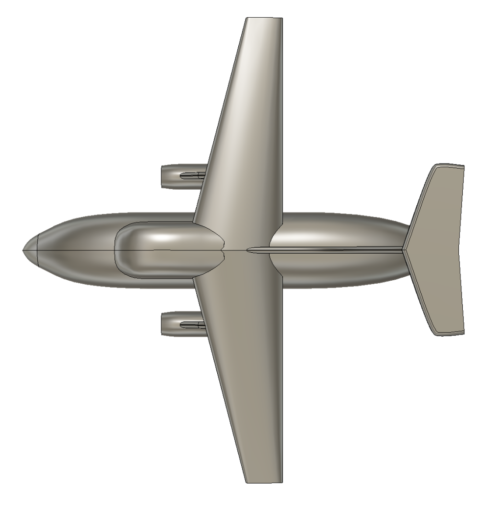

The chosen subjects? the BAC/Dassault AFVG and the Hawker Siddeley P.139B. In scale both work out around 20-25mm long, which means the thin bits would be 'really' thin. The plus side was that all of the usual detail, cockpit stuff, inlets etc etc could be either dispensed with entirely, or paid lip service at best.
So here's the P.139B. It only took about 2-3hrs total for all the design work, with most of that being the couple of iterations to ensure the prints didn't fail due to poor orientation and support location. I generated 3 variants: AEW with unfolded and folded wings, and the COD version.
As you can see, its pretty basic in terms of design, and seemingly agricultural with thick struts and chunky wheels. Anything less means it a) is a pig to print and support, and b) unable to support it's own weight. Plus, even with the best magnifying glass it looks OK in reality.

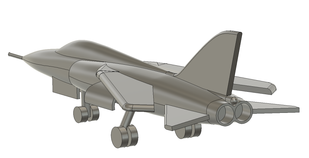

On to the AFVG. Similarly, I generated 3 variants: Unladen with unswept and swept wings, and carrying stores under unswept wings. Although it occurs to me now I missed a trick by not having one with the radome folded too. Easy enough to do another time.
Again, pretty basic really, but again, for something an inch long viewed from even a foot away it looks good. Although the swept wing version is on the brink of being a tail-sitter, but I'm not messing about with it now. And yes, amazingly the pitot actually prints. It doesn't survive handling but I guess you can't have everything....

Another member of the "I paid for this build plate and I'm going to fill it up!" club! They look great! Is there a reason for printing them with the upper sides facing the build plate?  The other direction would have minimized supports on the top surface.
Quote from: Thorvic on Yesterday at 09:39:11 AMGiven the AFVG was at the time envisioned to be RN as well as RAF then by 1974/75 then we would probably see the first squadron start to replace the Buccaneers.
Haven't you done an AFVG in 1/72 already Geoff, or did I imagine that?
scautomoton
Quote from: frank2056 on Yesterday at 10:13:15 AMAnother member of the "I paid for this build plate and I'm going to fill it up!" club! They look great! Is there a reason for printing them with the upper sides facing the build plate?  The other direction would have minimized supports on the top surface.
It's because the cleaning up of supports is less onerous than the breaking of undercarriage when trimming supports
