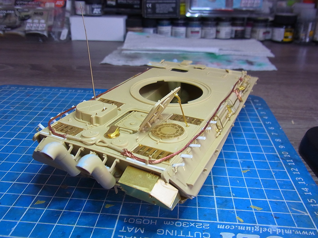

I may be nit-picking here, but your tank can't rotate its turret to the right beyond about 1 o'clock, or to more than about 9 o'clock to the left. This because the cable sticks up above the hull roof, where it will get hit by the bottom edge of the turret. The cable also looks far too thick, more like a standard tow cable than the much thinner cable used for changing the tracks, which was stowed here.
Also, you seem to have shallow U-channel for the spare track hangers. On the real tank, that was just flat strip, bent into a U-shape with the bottom of the U welded to the strip that's on the hull side.
... I know all this and more ...
The Chaos
Hi Thanks for thet, The Kit are very basic and invorrect.
Next i will bought a correct Panther, Meng or Rey Field Kit.
