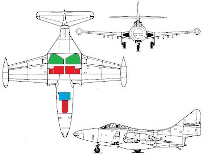

The LANTIRN pod was impossible anyway: you had it over the main gear doors.
There isn't room for anything under the wing root/intake fairings, see below:
Red = undercarriage doors
Blue = airbrakes
Green = inboard flaps
If I wanted to fit a targeting system to a Panther, my inclination would be to fit longer tip pods with a parallel centre section. Fuel in the centre of the tip pod, targeting turret + electronics in the front of one, something else (fixed FLIR? LRMTS?) in the front of the other one, chaff/flare dispensers in the tail of both.
You can still have laser-guided bombs without a targetting pod: the designation just has to come from another source, like another jet, a scout helo, or a forward air controller on the ground.
Spino
Good point.  The F-117 had a laser designator built in, I imagine there's room in the nose for something like that now that two of the cannons are gone...
