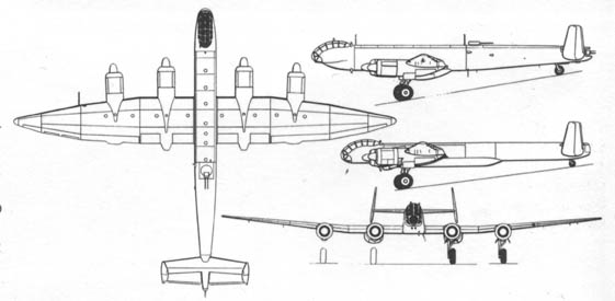

I'm working on the engine installation now, and it's going to be an in-line inverted V12, like a DB 605 or a Jumo 222. The problem is where exactly would it go?
I doubt they'd put it right in the centre of the wing chord as they'd need a massive ring frame to connect the two halves of the spar, and it would have to pass right round the engine. Unlikely but not impossible I think. I'm using an ancient Lindberg Do 335 as a donor for the exhausts and the big engine air intake and they could go in either of the two positions shown below. It'll be a tight fit but there's enough space right under the wing roots, I've checked.
Anyone any ideas about those two positions, or any other ideas even?
I would go with just behind the wing. It puts the engine as close as you can to the cg. Like you said, between the wings would be impractical and would add a lot of weight too. Just put fuel in front of the wing to help counter balance it.

As long as the engine is behind or ahead of the wing spar, you could have it between the wing.  Makes more sense, as you can hang it off the spar for a stronger structure.
The Bv 141 had a tubular main spar, so I'd think you'd have room to put it just behind the spar and use
a propeller drive gearbox that takes the shaft up over the spar.

Kit mounting the engine in between the wings is your best option.
A cyclical wing spar wouldn't be hard to design and done right would be far stronger as a circular shape is a stronger than a square or a rectangle and you could make say 4 or 5 cyclical mounts with the wings spars included as a single casting making for a extremely strong structure.
Mounting the first engine as close to the leading edge of the wing would bring you cg much closer to centre as you want to keep that as close as possible .
The further you mount the second engine backwards the more difficult getting a cg would be ..fact it probably be impossible as the front engine would then have to be moved forward as far as possible to counter the arse end weight of the rear engine which in itself still might now be far enough.
Hmmm, I must have picked the wrong Jumo, that 222 is MEGA complicated. I think I'll stick with the tried and true DB 605.
That spar makes it easier to have the engine more centrally spaced, I'll see if I can graft the exhaust stubs into the underside of the wing root fairings.
