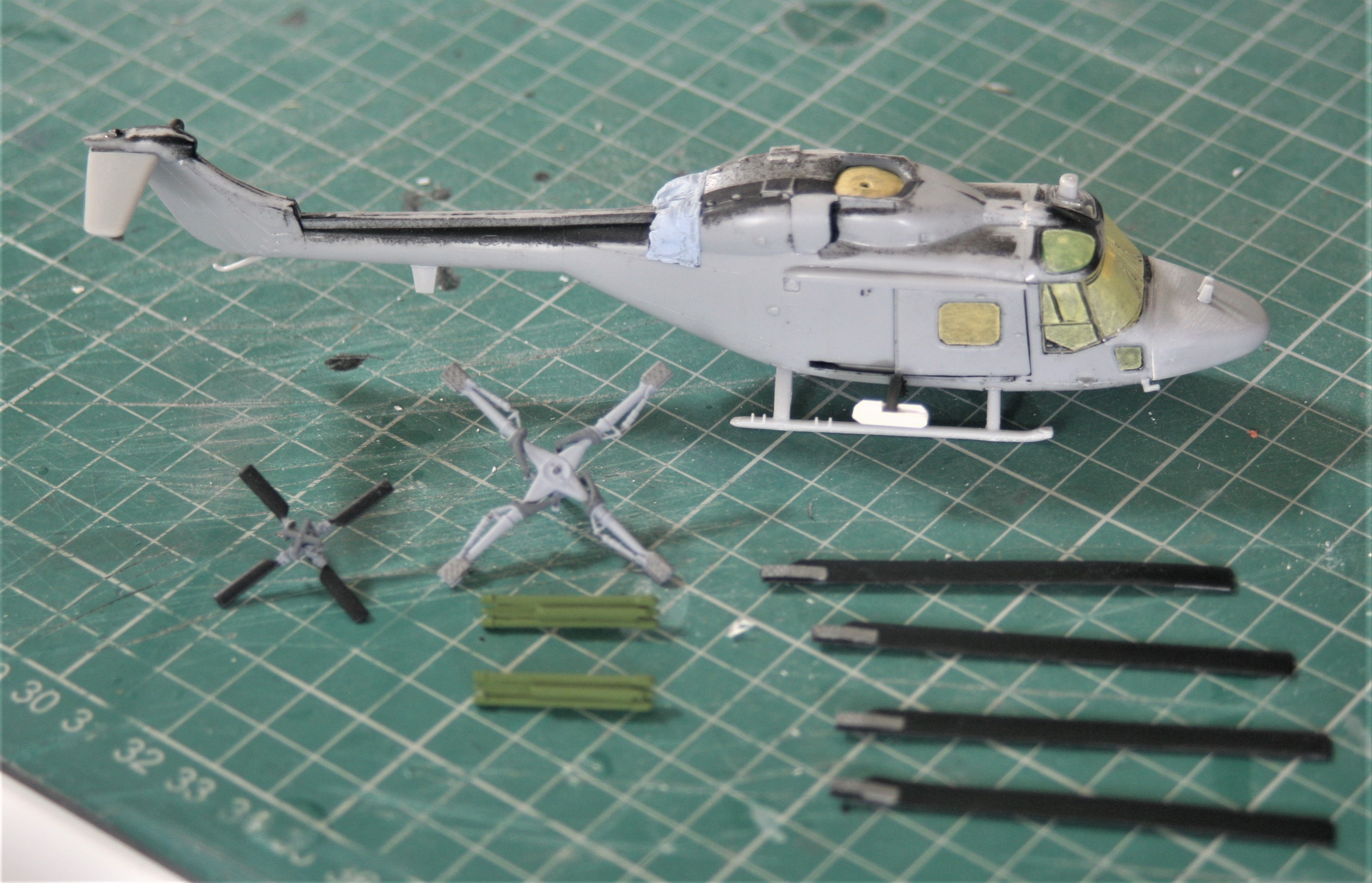

So next set of problems.... :rolleyes:
The fit of the cockpit roof to just about everything around it is poor, so that's meant another round of delicate sanding and filler, the latter eating more drying time. Now that the transparencies are on, I can't fit the doors until all glue and filler is dry, otherwise it risks trapping the fumes in the cabin and fogging them.
The gearbox casing, which is moulded in one piece with the cabin ceiling, and which is now very firmly glued in, turns out to not sit centrally in the engine fairing, to the point where the rotor head won't turn without catching one side of the latter. Of course, the bits that catch are the ONLY separate components on the rotor hub and were therefore at risk of getting knocked off if I, or somebody else, gave the rotors a casual spin. I carved one side of the fairing paper thin with a Dremel, but it still wasn't enough, so I've now put a packer of thin Evergreen on one side of the hole, thereby straightening the rotor head. I did investigate just raising it up, but that brought two new problems:
1. The Lynx rotor head sits very low to the engine fairing, and raising it up just looks wrong,
2. The shaft wasn't long enough to still fit securely, so I'd have had to re-engineer it.
I'm beginning to think that this kit is warped, either when it was made or in subsequent storage. The tail boom isn't straight either... :rolleyes:

Going a little better now.
Missiles in paint.
Pylons designed, built, fitted & drying.
Skids and tailplane fitted and drying.
Next: aerials, then painting can begin!
Turns out that the sliding doors can be fitted or removed with both tracks in place, so I'm using them to block the doors from paint spray. They're pretty loose though, so what I might do is put tiny 'snakes' of Blu-Tack into the top track to hold them in place. I don't want ot glue them in place because it will be MUCH easier to paint French Army-style red lines on the doors if they're off the airframe.
