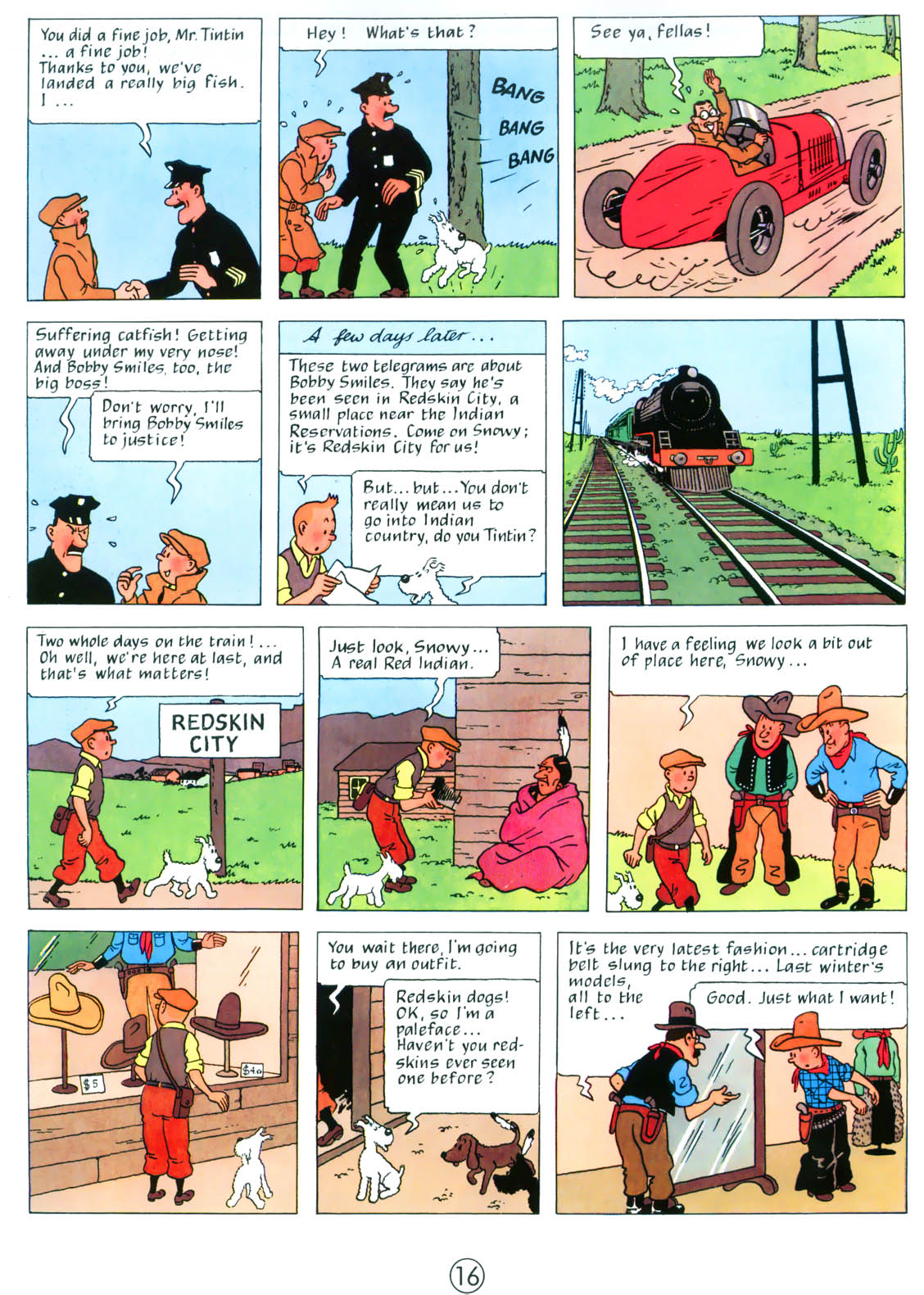

The first one, shown only in the single panel, is the one he takes from Chicago to Redskin City (a subtle foreign language joke in french, but pretty blatant in English)

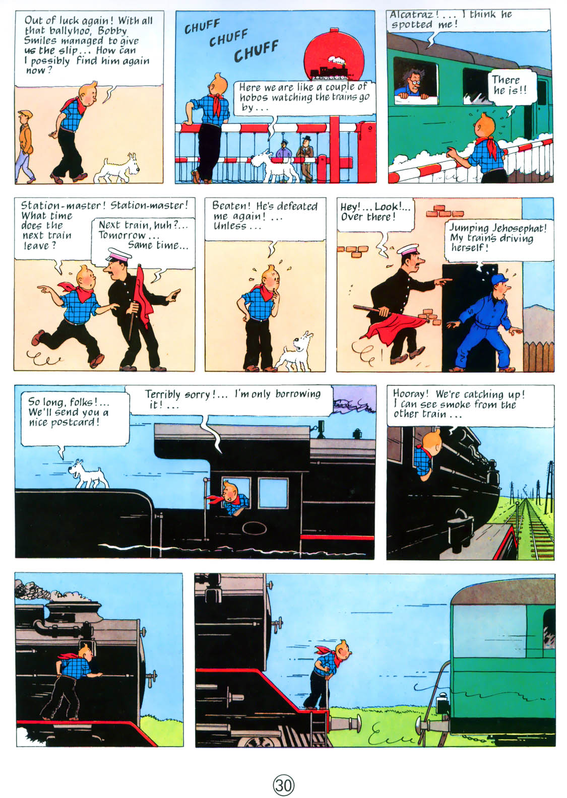

The second one... as we've already seen is the engine he commandeers to chase down the gangster Bobby Smiles...

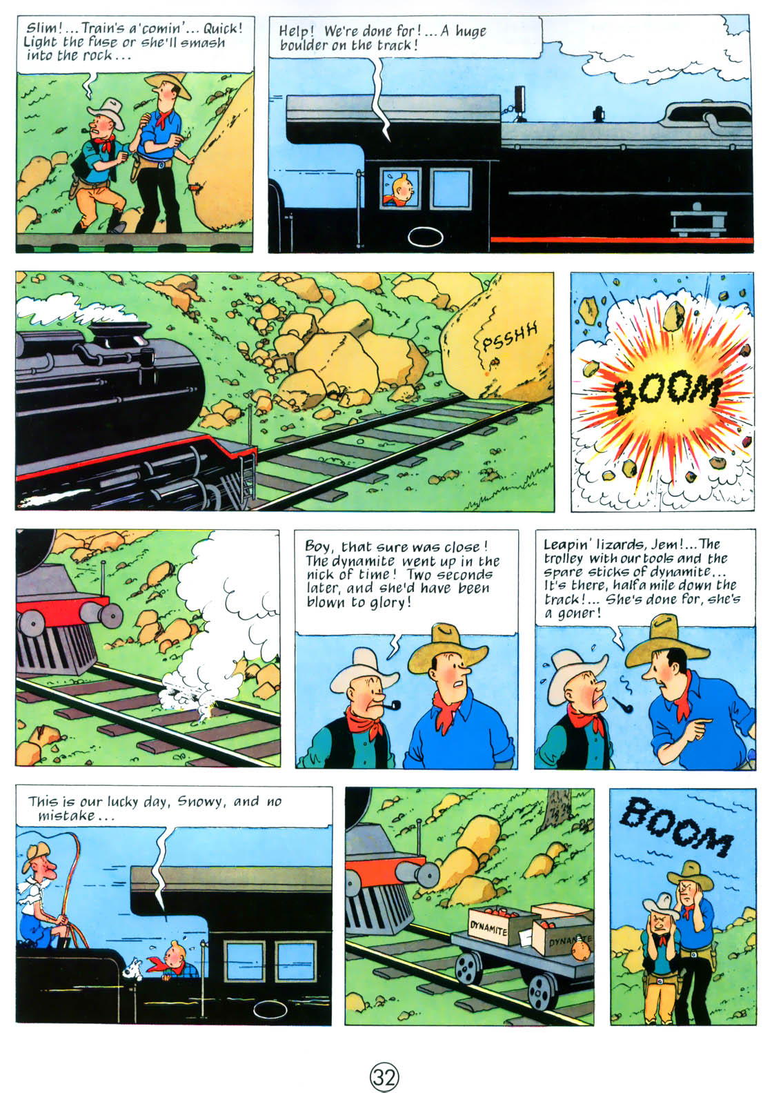

...which ends in disaster...

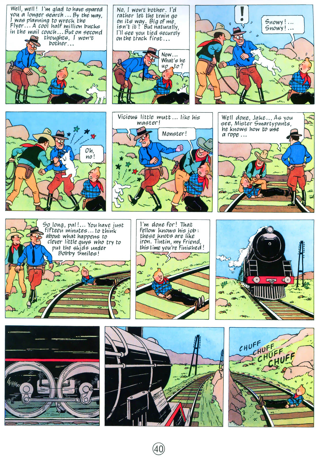

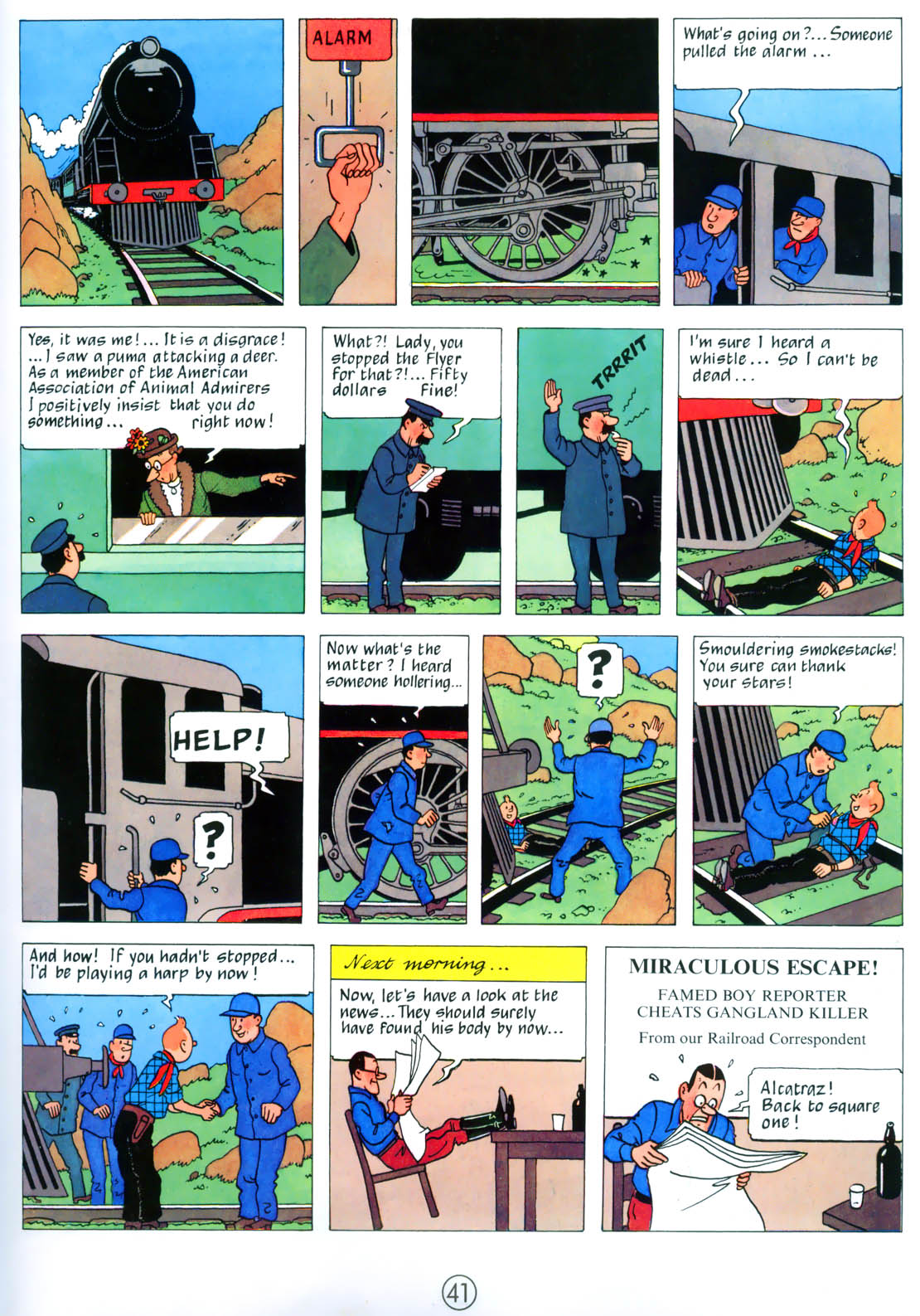

...And the the one that later comes rumbling at Tintin after the crooks tie him to the tracks...
...from which he is miraculously saved.

You can use whatever wheel arrangement you wish, as it's not possible to see it from the drawings.
If you wish to do something realistic/possible, for an american fast steam loco,  I'd suggest using a front bogie, not a single axle like in the Mogul, and a not driven axle under the firebox. So the wheels could be 4-6-2 or 4-4-2. US railrods used 2 driven axles longer than in Europe for light fast passenger trains.
ADDENDUM: form the left lowermost drawing in page 40, it's possible to see that the driven axles are only 2.
No connecting rods in either direction from the 2 shown! Apart from the fact that the one visible ends in mid-air. :o
I'd use a bigger tender then the Mogul, a 4 axles (2 bogies) one is necessary.
