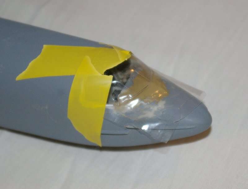

Amongst all the other odds and ends that I'm trying to do on this model, fitting the canopy is one of the more tricky ones. Even though the Anigrand canopy wasn't meant to fit the Mach 2 fuselage in the first place, the mating surfaces at the sides and back fit almost perfectly, but the forward end and the forward curved corners don't fit at all, leaving large gaps to fill.
I've devised a system of bedding the canopy's forward edges into a 'platform' of putty, with a small piece of polythene sheet in between to stop the putty sticking to the canopy. Amazingly it seems to work quite well, and I'm waiting for the second lot of putty to dry off now, and I'm hopeful that it will be all that's needed, after some precision sanding and filing of course.

You might think that I've been swinging the lead on the Monterey the last few days due to the lack of reports. Well to a certain extent I have been, but I've been pratting about doing all sorts of small jobs, like re-attaching the MAD probe, this time with a piano wire core so it won't break again!
Then I've re-cut and attached the forward ECM aerial on the fin fairing, but mainly I've been waiting for the putty to go hard under the canopy front end. There's four layers on there and it's taken for EVER to harden off, but it's OK tonight and I've filed and sanded it to shape, and painted it all matt black.
I've also added a couple of doo-dahs to the canopy and hopefully I'll be able to glue it in place late tonight or tomorrow.
