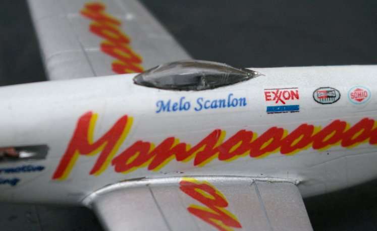

I've got all the decals on this one now, and it looks AMAZING!   ;D ;D
While doing final assembly on this MB5 variant I've come across an issue that doesn't seem to be mentioned in reviews or anywhere else, and it may be of interest to other MB5 builders.

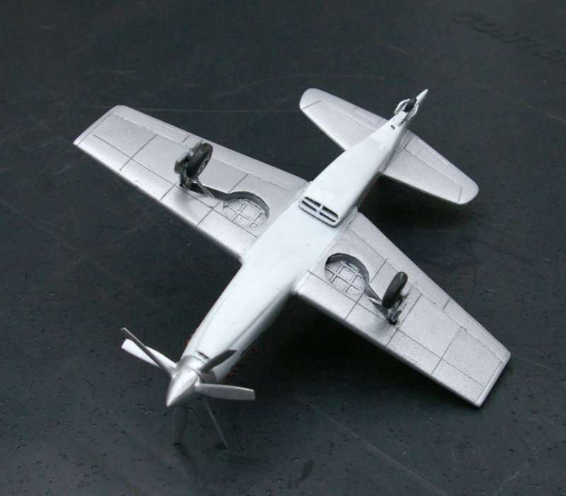

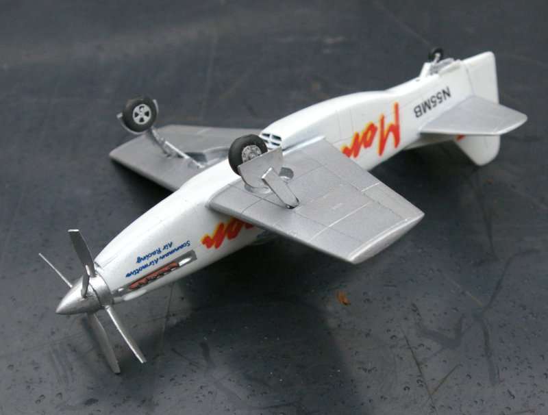

The main landing gear of the MB5 doesn't exit the wing at 90 deg to the lower surface, it leans forward at quite an angle. Incidentally this means the bottom edge of the curved doors is parallel with the ground when the aircraft is at rest, see below.
As far as I can see the AZ model doesn't allow you to do this as the socket for the main gear leg, which is moulded into the upper surface of the wing is at 90 deg to the chord line and the leg itself isn't angled to suit the slope of the main gear leg. I've tried drilling the socket out at an angle but then the upper gear door fouls the slot in the lower wing section and the spigot at the top of the leg won't align with the socket.
My solution was to cut off the spigot at the top of the leg at angle to suit and to superglue the whole assembly into the wing slot. Not ideal I know, but not something I could sort out unless I'd made mods before assembling the two wing halves.
Does anyone else have this problem or have made a right hash of something somewhere?
Perhaps replace the spigot with a pin after the top of the leg has been angled correctly?
This one's sorted now, and I'm embarking on the backstory.

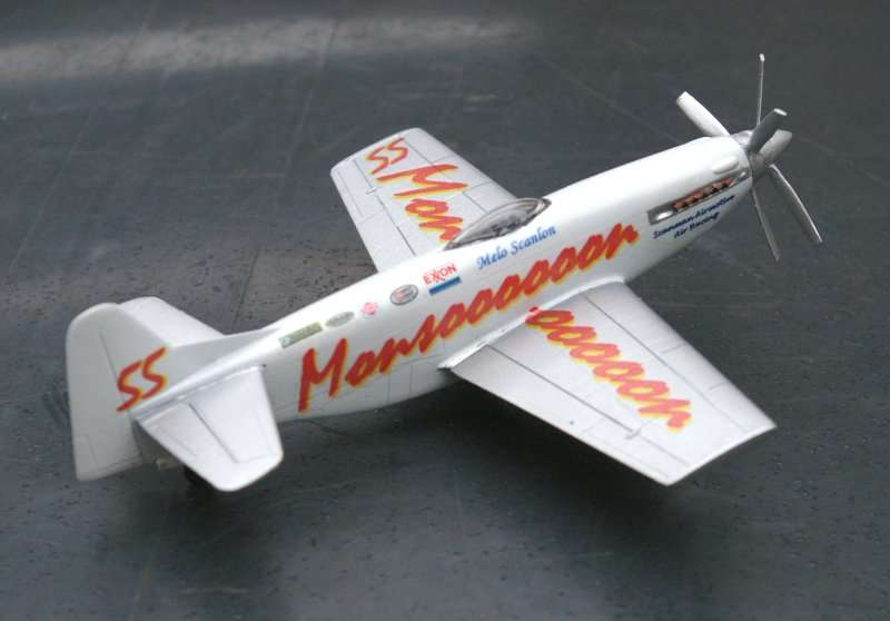

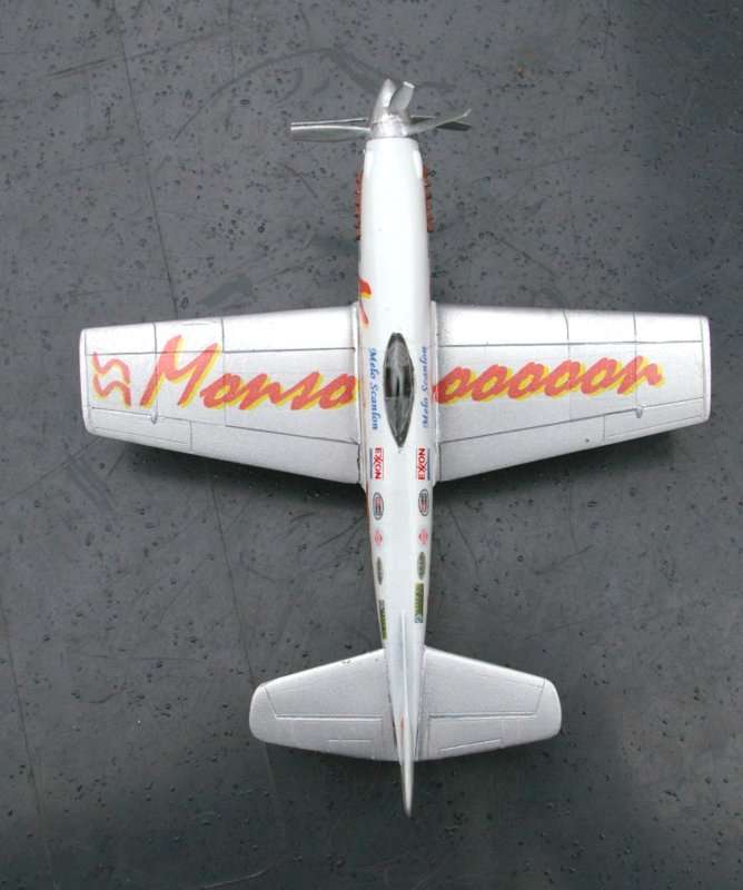

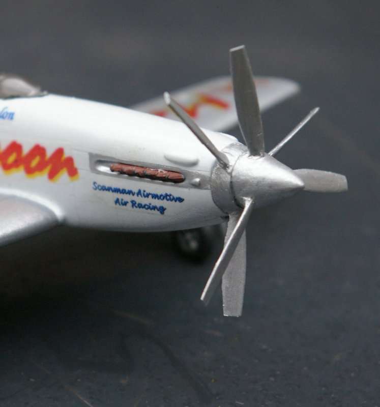

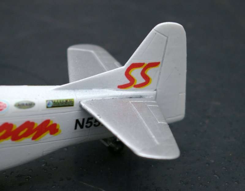

As shown before the Monsoooooon has a blanked off cockpit compared to the fighter version, and has a minute canopy installed (it's a 1/144 scale F-16 canopy.....  ;D) and as well as the dorsal fin it has clipped, Hoerner tipped wings and a clipped prop too. The fuselage is all over Halfords Appliance White and the wings and tailplane are in Halfords Silver with some panels in contrasting shades. I drew up and printed all the decals myself, even the little sponsor decals, which were scanned from pics of RW race aircraft.
Melo Scanlon is a good friend of mine from my flight simulation days and is tickled pink to think that I've promoted him to be Scanman Airmotive's race pilot. Oh yes, Scanman Airmotive is the name of the virtual aircraft design and development company that Melo and I invented back in the 90s.  ;D
It's a bit brighter than the Monsoon PR3 I think, yes?  ;D
I'll link the backstory here when I've finished writing it, but it may be a while as it goes on and on and.....

Very cool, and it looks fast!  :thumbsup:
Oh wow that is great ! Love the look of her, especially from the top. From that view, she looks like a Bearcat doing Mach chicken Louie ! Nice tribute to your pal and your old sim days as well. Very cool.
That's very nice looking Kit! Looking forward to the backstory  :thumbsup:
