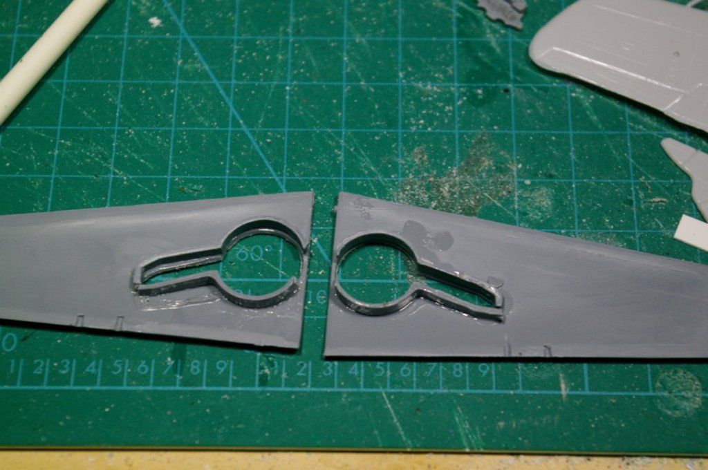

Well I managed to sort out the problem with the wheel well sides. It's the instructions that are wrong. In the boxing that I have AZ 7553, take care with parts 13, 14, 19 and 20 which make up the sides of the wheel wells. As shown the parts listed as 13 and 14 are for the same side of the wheel wells, the leading edge of the wing side of the wheel well with parts 19 and 20 for the trailing edge side of the wheel wells. I think its the numbering of which part goes where inside the wing that is wrong rather than they layout of the parts that is wrong, but which part goes where is as guess. I hope that makes sense  :unsure:
Anyway, the result looks like this
Which looks much better than the previous attempt which looks like this
At least it's some progress.
Nice one Alastair.  :thumbsup:
I've made a note of that tip already.

There I was studiously following the instructions and only removing the parts from the sprue/tree* as required and I missed the visual difference between the parts on the bench and the parts still attached to the sprue/tree*  :banghead:

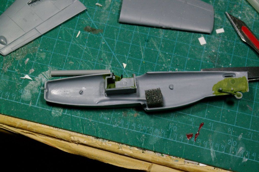

Partly to show that I have not stopped working on this build, here follows an in progress picture for your pleasure  ;D
The idea for the black foam inside the intake I have shamelessly pinched from Dizzyfugu  :thumbsup: Certainly going to save a lot of painting in the area of the radiator.
The rod above the forward fuselage is the interior tubing for the propeller which is slightly too long for the distance between the cockpit and the front of the engine which is to help me make sure I get it to fit at the correct angle. The kit supplied rod to fit behind the front propeller has been left alone as it was not circular and I wanted something a little longer to help stop the propellers falling off the front of the aircraft easily during transit.

EEk that sucks. The foam is a good idea, and it's about time I put 2 and 2 together from all of Dizzy's builds !  :banghead:
