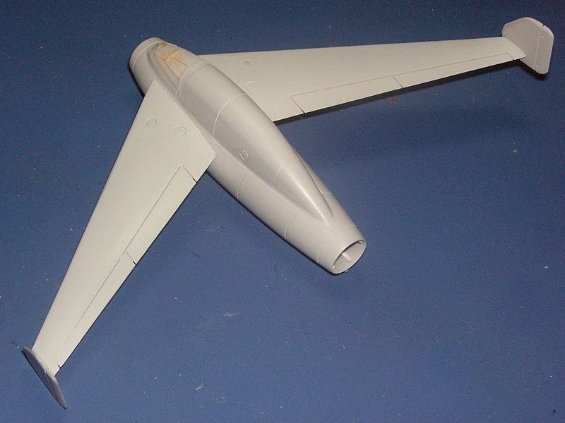

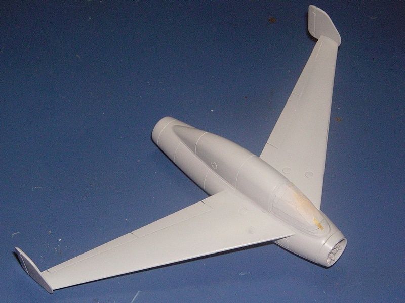

The primer coat is on: Mr. Surfacer 1200 polished with micromesh 3600 to remove any lint stuck to the paint and give it a smooth finish for the base coat.

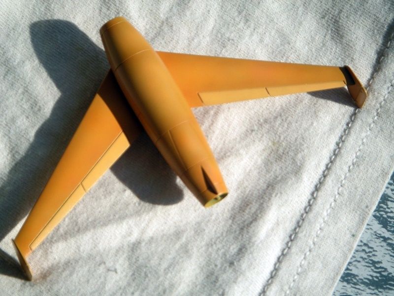

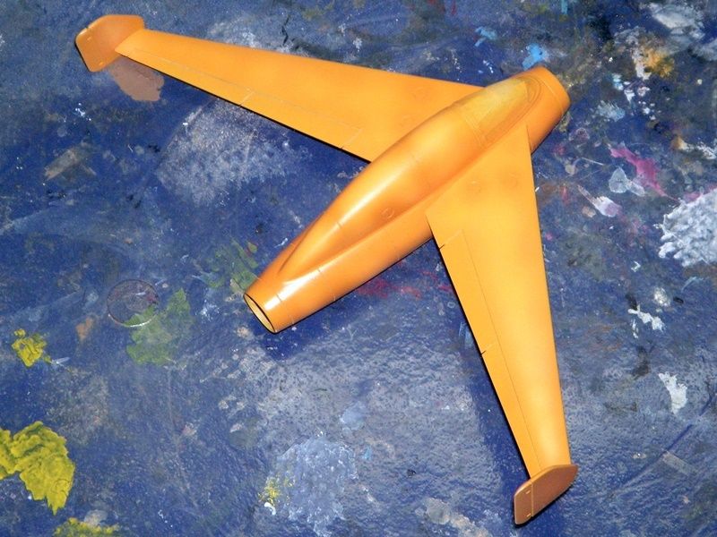

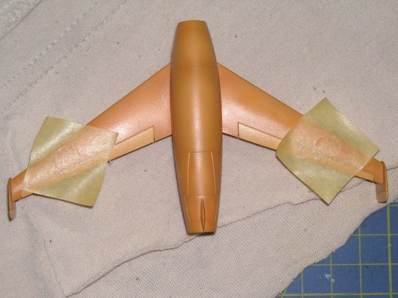

Base coat is on. It went on straight, no pre-shading. The reason for that is because of the base coverage ability of yellow, which results in too harsh a contrast. I'll use post-shading instead.
After doing some research on the WWII Japanese yellow/orange color for trainer and experimental a/c (there's a quite thorough essay by Nick Millman on the subject) I settled for a 95% Gunze H4 Yellow and 5% Gunze H3 Red mix. I'm quite happy with the result. Hope you like it too.

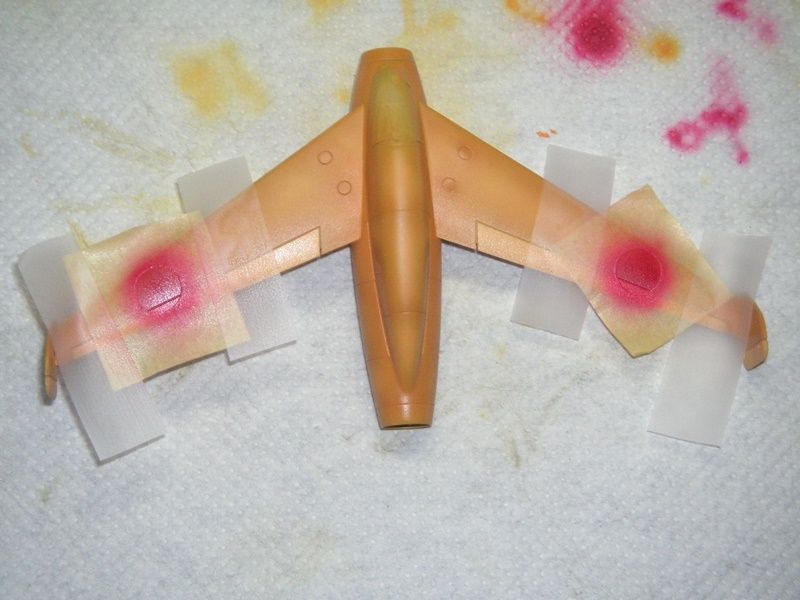

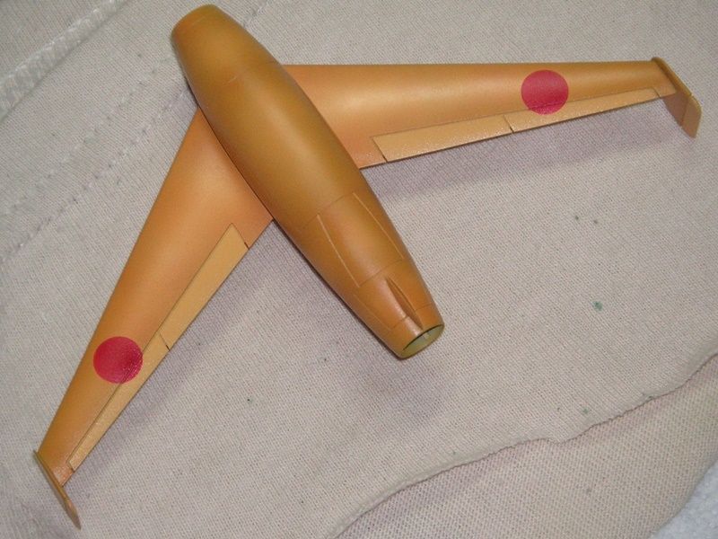

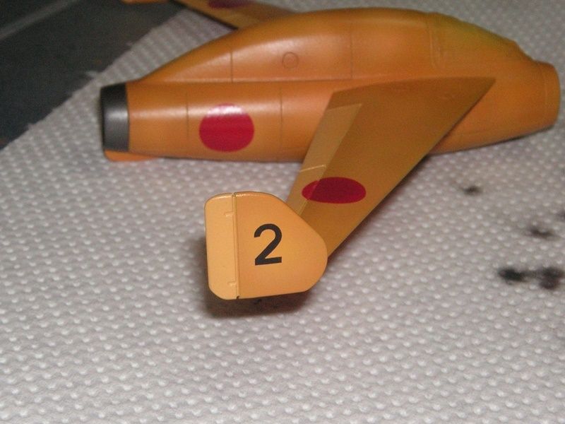

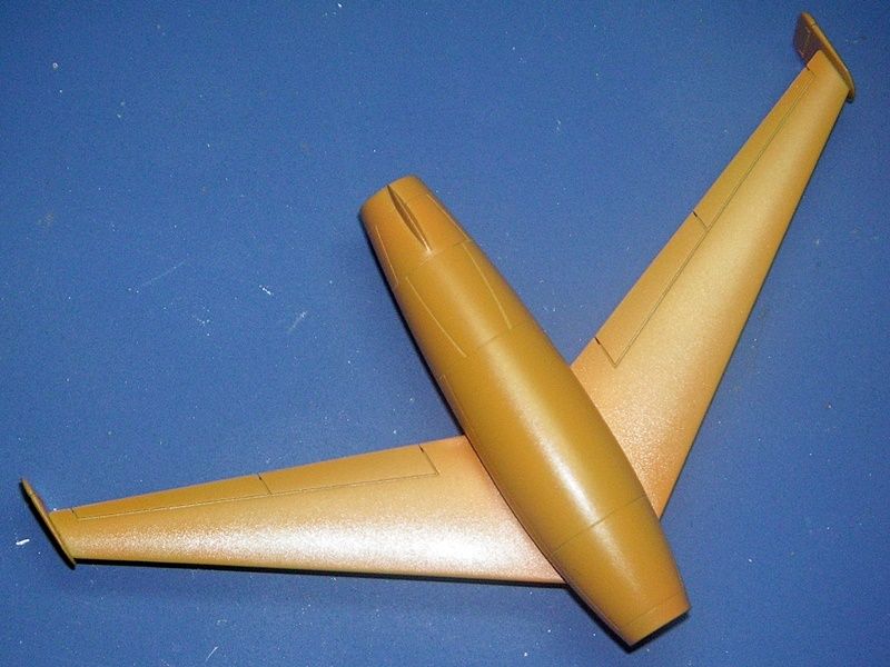

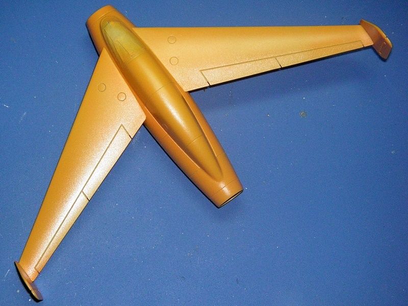

Next after painting came post-shading: base color lightened with white and darkened with orange and brown.
Elevons and rudders were masked off and painted in a lighter shade of the base color.

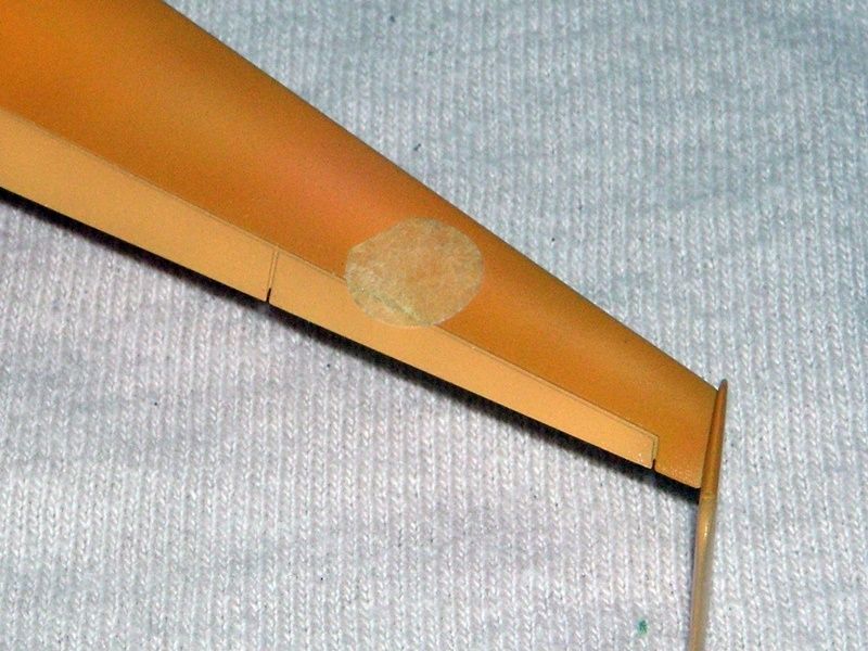

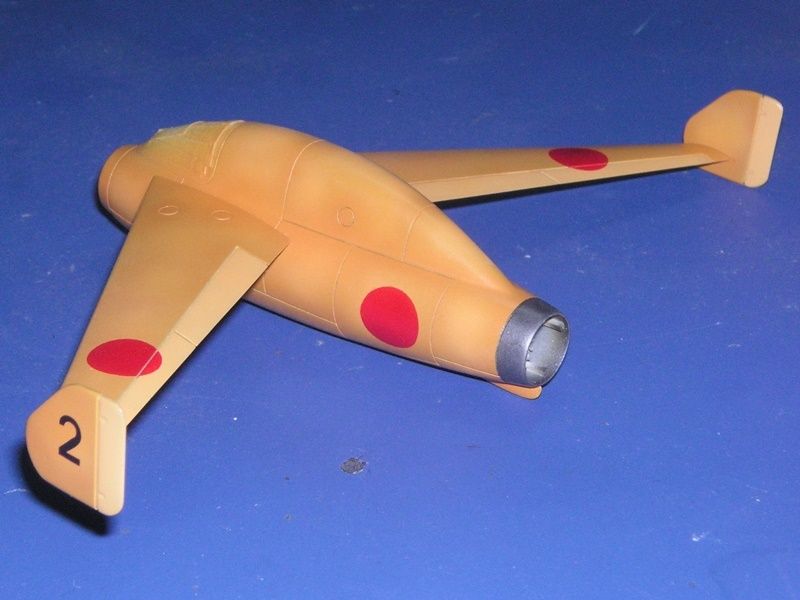

Hinomarus were painted with Gunze H3 Red, using masks made from Tamiya tape.

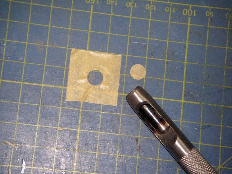

To make the masks a hole was punched into a piece of tape using a hollow punch.
The punched out disc was not discarded but used as a guide by placing it on the model where the hinomaru would go and then positioning the mask around it.
A small section was cut off from the disc to make it easier to lift off once the mask is in place.

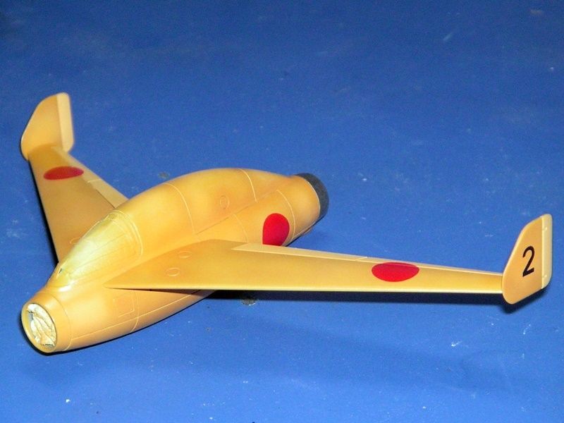

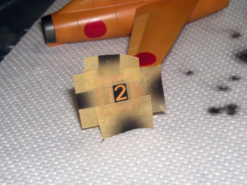

The numbers on the fins were airbrushed using leftovers from an earlier set of Miracle Masks.
The paint is Gunze Flat Black lightened with a little Tire Black to break the harshness of absolute black.
No decals were used at all for this build.
The nozzle was painted with Model Master metalizers.
More to come...
