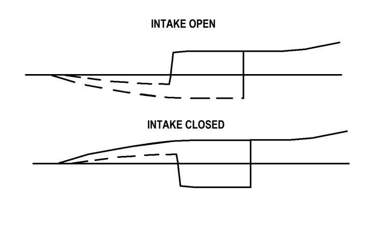

IIRC the #2 engine on the XB-51 was only a 'part timer' which was used for take-off and over the target dash speed. As such the intake was blanked off when the engine was shut down and that rotated just like the bomb bay door.
I think the rotating bit was maybe 6 ft long, only the rear half of which was the bit you can see on the model. The front half had a dip in the top of the fuselage which when rotated became a nice smooth fairing to the fin. It's difficult to explain so I'll try and draw the two configurations. Watch this space....
Offline PR19_Kit
  • Closeted Take That fan
  • What-IF SIG
  • Posts: 33783
  • Whiffing since the 70s
Re: Martin B-51G Panther “Tropic Moon III” UPDATE 02/8
« Reply #22 on: August 02, 2015, 10:53:59 am »
Here's my sketch of how I reckon it worked, and below are a couple of small pics that show the #2 intake in both closed and open  positions.
« Last Edit: March 11, 2018, 09:56:30 am by PR19_Kit »

arrr I was wondering about that, I had seen the top photo but wasn't to sure what the go was there.
Either way the #2 intake as it is is wrong so it does need to be modified.

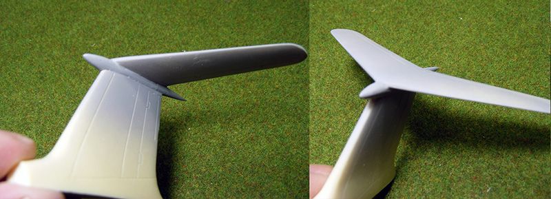

Next up the spike on the tail, it seems some aircraft didn’t had it (suspect early prototype/s) while later ones had different shaped ones. So I’ve made one up, it still needs some tiding up plus I’m probably going to add another fairing as well…hmm think about that one.
