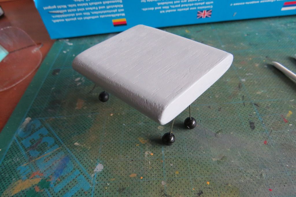

The next bit to do is the Fire Retardent Pannier, carried underneath the Hog.
Here it is in it's early stages.
I originally planned to do this in plasticard but for expediencies sake it is Balsa wood.
(I have lots of Balsa as I am a keen R/C Flyer.
This is it after six coats of Mr. Finisher, there are a lot still to go.

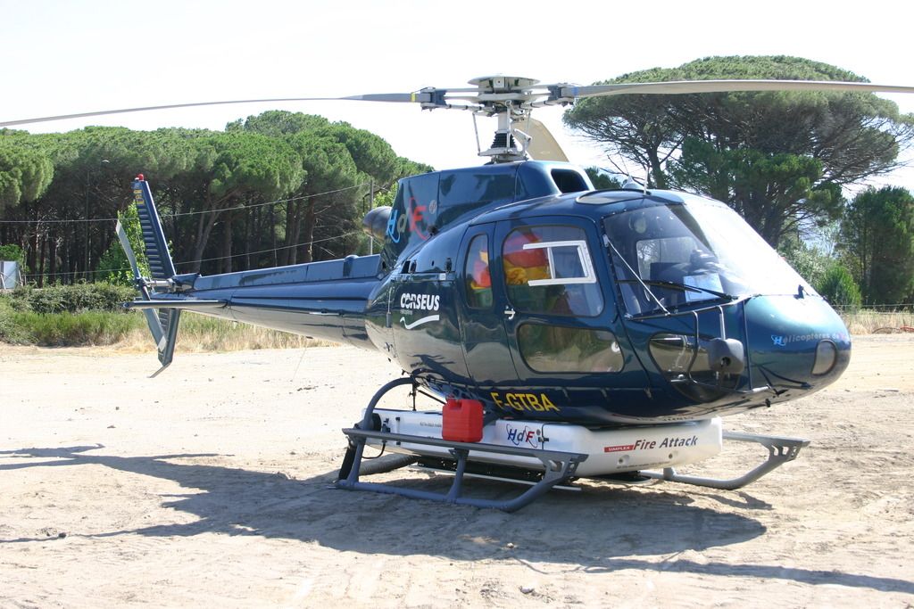

The inspiration for this came from these two Ecuriel,s that I saw in Corsica in 2005.
Nice. But that's after 6 coats ? Wow ! So much for expedience eh ?
:banghead:
yes, balsa's terrible if you want a smooth finish. Best start by dipping it in lacquer or Future a few times to seal it. Then the paint or filler won't be absorbed so much.
Why not skin the balsa in thin plastic card?

Quote from: Gondor on August 23, 2015, 01:21:32 AM
Good advice, give the lungs a break.
I always used the talcum powder/clear dope trick to seal balsa
Me too Chris, but I have not had any clear dope in my possession for YEARS. Modern aeromodelling does not require it.
