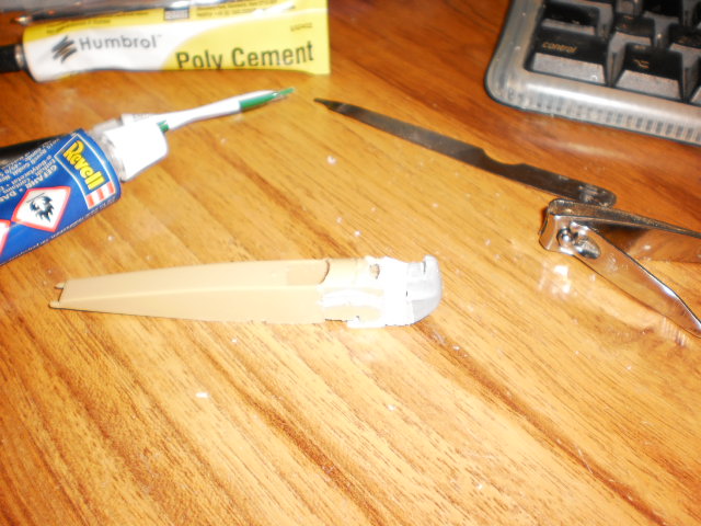

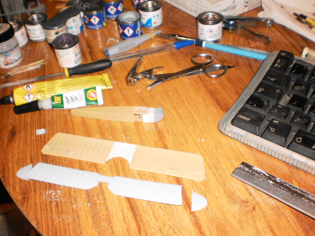

Thanks Guys. Work so far has centred around getting the pieces ready before serious construction begins. The lower wing had sweep back incorporated so the upper was made to match. A slight angle was filed into the butt end of the Fokker sections with the trailing edge end farther back than the leading. When joined to the centre section there is sweep back. Nothing drastic as most examples I've come across seem to be in the 3-5 degree range. The nose section is a remnant from the Eastern Express HB Starstrutter. It was lengthened by laminating three pieces of 80 thou card. When secured I used a small grinding wheel to blend the contours to a match. The hole for the engine was drilled out and I've used a Revell Fokker DVII cylinder head/exhaust part to represent the Mercedes. Rear elevators were designed for a tapered fuselage so had to extend then with card to make them match up to the straight Fokker fuselage. Iron crosses are from Almark and I've used plastic rod for the cabanes. I have some white white metal N struts which I thought would be useful. Problem is that they need superglue which has such an effect on wiggle time that I wouldn't have been able to set them up to accept the location holes in the wing. Far easier using cement and plastic.

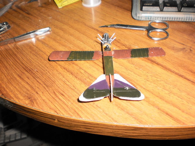

I'm thinking that the white tail is too big and out of proportion to the rest of the aircraft. The false tail pieces were laid out to see how they compared. If I stick with a biplane I'll use the smaller set but a sudden thought has made me wonder how a parasol would look.

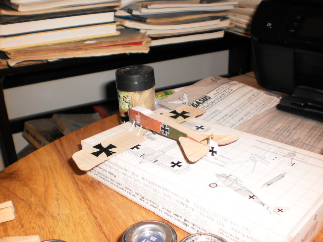

I've decided to go with the parasol version this time but have not forgotten the biplane as I have another E111 in the stash.  The parasol means I can keep the large tail planes for extra lift and will give me a rest from lots of rigging. Top wing is in position and the cabane strutwork will be like the 1918 Fokkers but, hand on heart with eyes skyward, where do you think they got the inspiration from. No cantilevers here though so there'll have to be some additional wing support.

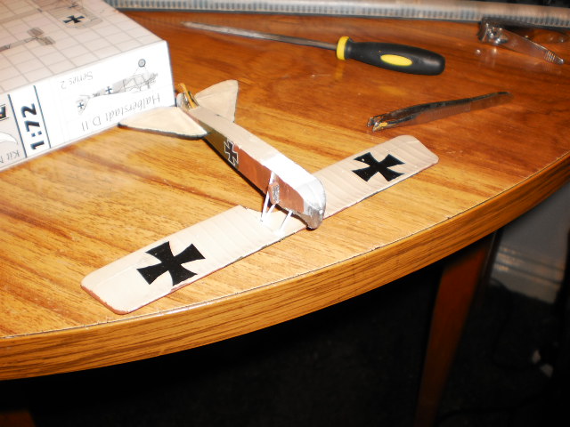

stevehed
Thanks Narses2. I've built several Pegasus kits and they all had short run issues but proved buildable. Most recent was the Halberstadt DII in the aforementioned box and you can see a blue tail in the previous post. This is a Pfalz D111a. Building two Pegasus kits at the same time is not recommended hence my decision to seek calmer waters and sail to Whifland to recuperate.

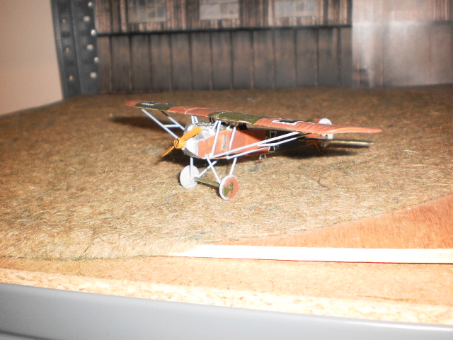

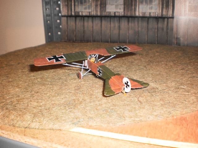

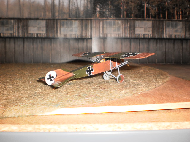

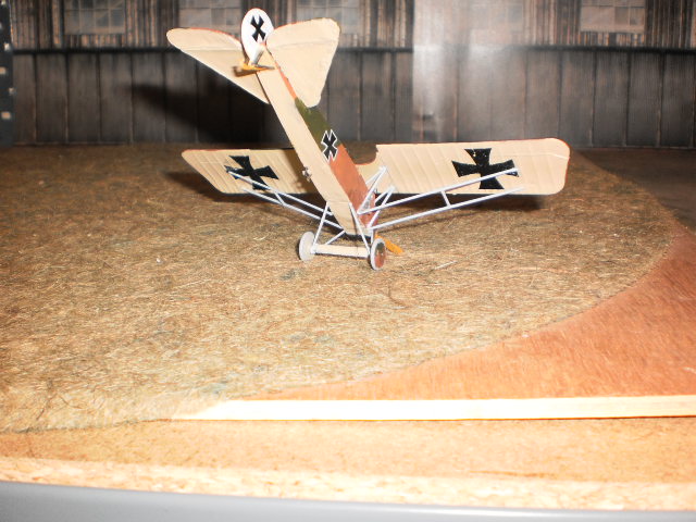

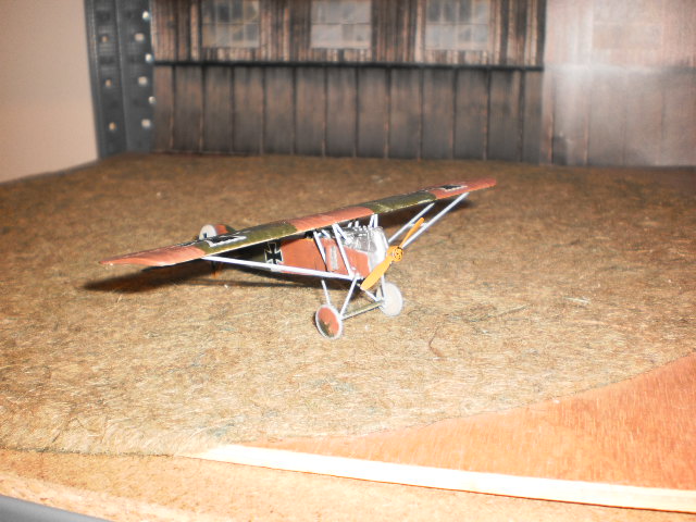

Got her finished. Wing struts are 35 thou rod and the undercarriage, both legs and axle, are remnants from an Airfix Albatros. Wheels are spares and the prop is an Airfix Camel refugee. Side radiators came from the Airfix Roland. This is a Parasol Fokker, one of a small series of aircraft built by Air Park engineers using predominately Fokker Eindekker parts, in response to the wishes of the front line squadrons for an escort fighter with a better performance than the Fokker E111. The Parasol was powered by the 120hp Mercedes and armed with a single Spandau machine gun. It had a top speed of over 100mph and served between March and June 1917 on the southern sector of the Eastern Front. Records are scarce but it is possible that one such aircraft downed an observation balloon during May and Russian records mention Fokker monoplanes during this period.
