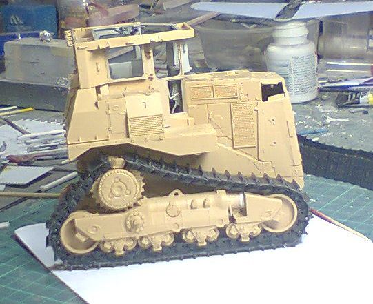

I also added some detail into the cabin of the D9 - a strategically placed map (covers an ejector pin mark I missed) and a poster on the large blank area behind the No.2 seat (there because I lowered the seat to improve driver visibility and because this will be a civilian machine and thus have no need for a gunner).  The map is a very reduced one of the Carrum Poo Farm where I used to work and the poster is a picture of Kari Byron holding an RPG aloft.
I've finished the tracks but had to carry out some modifications to get them to fit properly.  If built as per the instructions the tracks would be super loose.  I took out a link and they still fitted but were so tight I was worried that the thickness of the paint would stop them fitting.  IRL what you do if the tracks are too loose is "pump them up".  This moves the large front roller forwards.  To achieve the same effect in 1/35 I sawed off the front roller carrier and put in spacers which are the white parts in the picture below.  Now I have a realistic amount of slack for an operational dozer.
Don't know why but that looks as though with a painted mouth and eyes it would drive straight into a starring role in a Disney animation ?
Looking good sir  :thumbsup:
Blimey, that's a big thing 'innit?
From the people that brought you Cars and Planes - Disney's Earthmovers.
