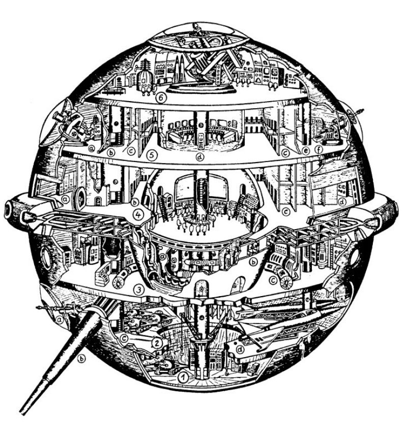

So this is the cut-out I want to rebuild as a 3D model:
(C) VPM, drawing by Rudolf Zengerle, first published in PR 192, 1965.
As you can see, the ship has 6 main decks, for each of the decks I will do one 3D print with a cut-out at the front so that you can look inside. I will only model the visible parts in "detail" of course.
The first tests made in 1:1000 scale showed that it would work, but I won't be able to remove all the support structure of the printing without destroying the rest of the model. So I will do it in 1:500 scale.
I now work on deck 4.

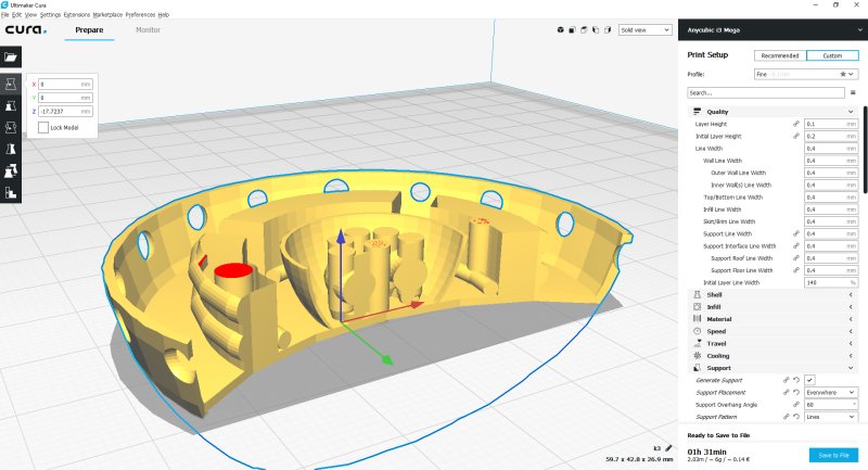

Right now, I am experimenting a bit if things can be printed at all. In parallel, I design the single decks of the Kaulquappe.
For example, this is deck 3, the main engine deck in the slicer to prepare it for 3d printed.

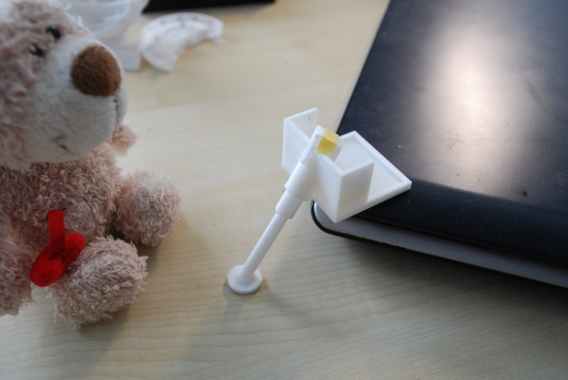

On the experimenting side, I am doing some tests for the landing legs. The problem is that I cannot make them in one piece, otherwise too much support structure would be needed at the model.
So the plan is to have one part build into the hull of the ship, this part does not extend outside, so no support is needed. The landing leg will be printed as its own part and later simply inserted.
Here is a testmodel in the right scale to see if both parts match and it worked :)

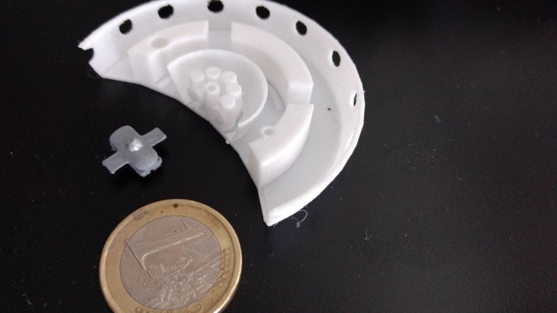

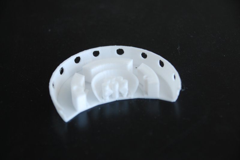

This is now a testprint of deck 3 that I was working on.
Scale is 1:1000, so the "real" print will be twice the size.
On the design side, I see more and more how inaccurate the original drawing is regaring in size. Some things simply to not fit if they are created in the size as they are described. For example, deck 1 and 2, the smaller craft on board. The drawing shows four of the flying tanks named "Shift" whic hare described as 10 meters long. If you compare this to the spaceship which has a diameter of 60 meters, it simply does not fit.
Here is a an example of a correctly sized "Shift" (scale 1:1000) - the little gray thing. This is among the smalles I can print at all. For the real print of the spaceship, I cam make it a bit more detailed because of the bigger size.
