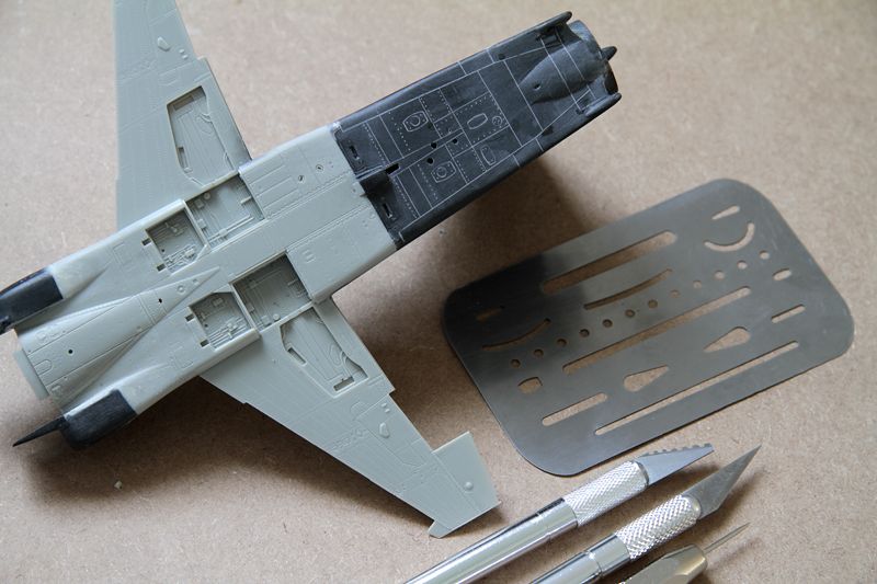

Small weekend update
Time to get her looking uniform. The AFV RF-5 has some amazing recessed panels and the Monogram F-20 has 1986 greatest raised panels. So this weekend I've been off and on sanding the old panel off and scribing in new ones. I started yesterday on the left side and today I managed to work my way to her underside. Working my way rearward, you can see I'm about half done.

Beautiful, clean work as always Steven ! Which tools are those ? The pin vise looks different and what's the serrated job do ?

QuoteWhich tools are those ?
I've been using a drafting eraser shield as a scribing template. For scribing, I use the tip x-acto but not the sharp side (sharp edge facing away from the model). The pine vise is normal. I use it for the rivets and widening out the new panel line. The serrated job is an x-acto blade I cut notches out(Dremel tool & cut off wheel) of as well as cut off the tip. It's a great tool to make straight lines of odd surfaces. It cuts/scribe pushing and pulling.
