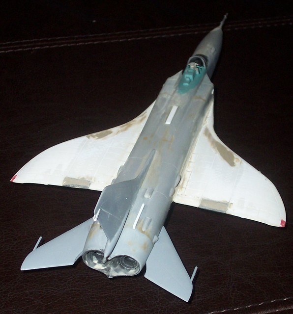

The kit and its assembly:

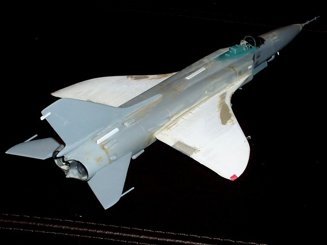

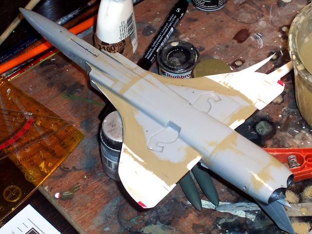

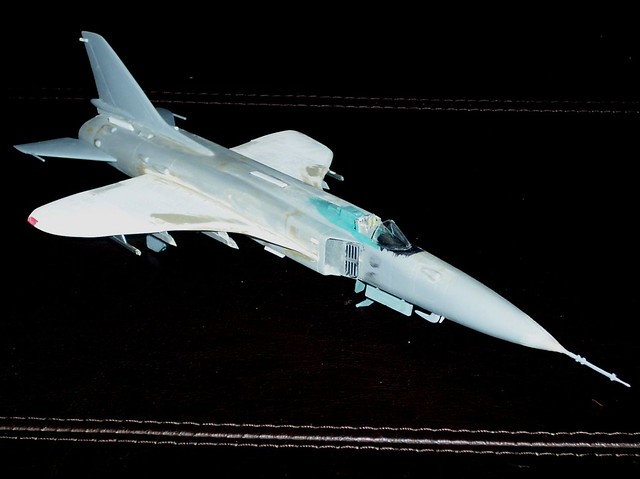

This whif actually has a real background, as outlined above - OKB Sukhoi worked in the late 60ies on several Su-15 derivates, including improved interceptors and even a specialized attack aircraft. The Su-19 was a real project, but it never left the drawing board.
Anyway, since I had a Su-15 fuselage left over, the Su-19 was a potential use for it - even though finding suitable wings proved to be more daring than expected (while I only had a top view sketch of the Su-19 as benchmark). Tough job, and I was not able to turn up with something that would match in shape and size until I finally found a Concorde(!) wing in 1:200, from Revell. It is not perfect, but an acceptable second-best option.
These wings had to be modified, though - I wanted to extend the wings forward, so that the LERX would almost reach the air intakes. But the Concorde wings had to be shortened and its leading edge shape modified to make the parts fit onto the Su-15 fuselage, which was taken OOB.
1:72 Sukhoi Su-19M (NATO code 'Flagon H'); aircraft '07 Yellow', unknown unit, Ukrainian Air Force; Saky Air Base, August 1993 (What-if/PM Model conversion) by dizzyfugu, on Flickr
While working on the wing parts I was also happy to find that I could use much of the PM Model's lower wing piece, which also contains the main landing gear wells. This made landing gear installation much easier, even though still much of the wings ' undersides had to be sculpted with putty. I also had to re-shape the complete leading edge, and had to insert plugs where the Concorde's engine nacelles had been. Lots of work for just two donation parts... But once it was painted, thing started to look better than expected, even though I did not truly hit the "real" Su-19's wing shape.
The cockpit had to be enhanced, too, since the original kit only offers a stubby seat, and the original canopy had also already been used elsewhere. So, a dashboard, a new ejection seat as well as a Matchbox pilot were added, and a new canopy from an F-16 singe seater was used - it fits almost perfectly and gives the Su-19 a more modern look.
The landing gear was taken OOB. It's somewhat simple, but the covers hide much of it, and the wheels are acceptable. The jet nozzles were opened and some interior added, so that the back side would not end in a blunt butt.
Under the fuselage a cannon fairing was added - it actually comes from a Hawker Hawk trainer, but was shortened and lowered, for a more streamlined look. I could not find specifications on the real Su-19's cannon - it probably carried a GSh-23-2 23mm cannon, but I went for the more modern and powerful GSh-30 which would also be fitted to the Su-27. Two underfuselage hardpoints were added next to it, carrying two drop tanks (from a Kangnam Yak-38).
The missile armament as well as the respective launch racks comes from a Soviet AAM set from ICM. I went for four R-27 AAMs (two with radar and two with IR seeker heads, as well as extended range bodies), plus a pair of R-73 short range AAMs under the outer wing root pylons. Together with the ogival wings this creates a really odd look, and a menacing air-to-air ordnance!

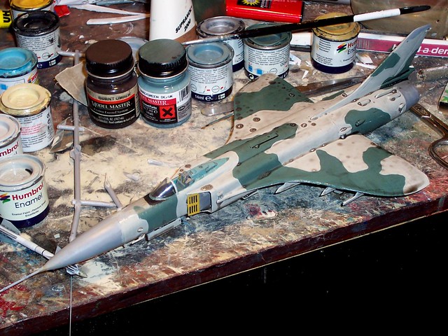

Painting and markings:

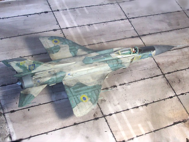

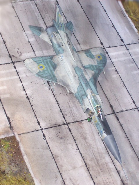

AFAIK, Su-15 were either kept in NMF or wore a tactical camouflage during their Soviet service career. Sometimes you come across drawings of late Su-15TM in a grey two-tone paint scheme, but I have - until now - not found a photograph or hard evidence of such an aircraft.
Anyway, since I did not want to make a Soviet/Russian aircraft from the Su-19, I went for this whiffy option and made it an Ukranian Air Force 'bounty' from the era directly after 1992, when the UAF was founded.
The paint schemes is based on MiG-29 patterns, also used by the UAF, and I used simple Humbrol 129 and 31 (Gull Grey, FS 36440 and Slate Grey) as basic tones, which were later painted over with authentic "Fulcrum Grey" and "Fulcrum Grey/Green" from Testors. The Humbrol Slate Grey turned out to be a bit very dark, so the contrast to the (very pale but intense) Fulcrum Grey/Green is rather harsh - more than I had planned. I tried to tame things down with a black ink wash and even a grey filter was, but the surface ended up with more contrast between the panels than intended. Anyway, I stuck with it, because I can hardly imagine a model in the pure authentic colors. It should hurt the eyes! X.x'
The nose radome became grey instead of the typical, bright green. I used RLM 75 (Braunviolett), also from Testors, since it has a brownish hue which matches the light grey of the model. Some other di-electric panels and covers were painted in the same tone.
The cockpit interior was painted in bright Russian Interior Blue Green from Testors, the landing gear wells were kept Humbrol 87 (Steel Grey) - based on pics of real life Su-15. The wheel discs became bright green - odd, but it adds some contrast to the all-grey machine.
Further colorful eye-catchers are the Ukrainian roundels and the yellow tactical code - both were placed on irregular, grey bases, as if they had recently been updated.
The white missiles also stand out and make the Su-19M look more interesting, distracting from its new wings.

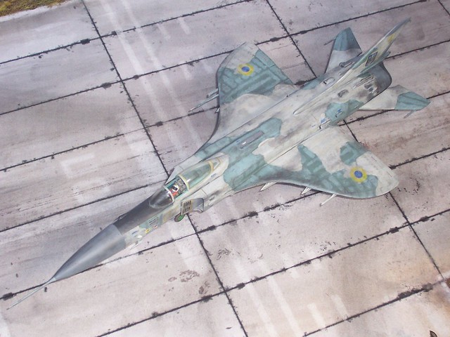

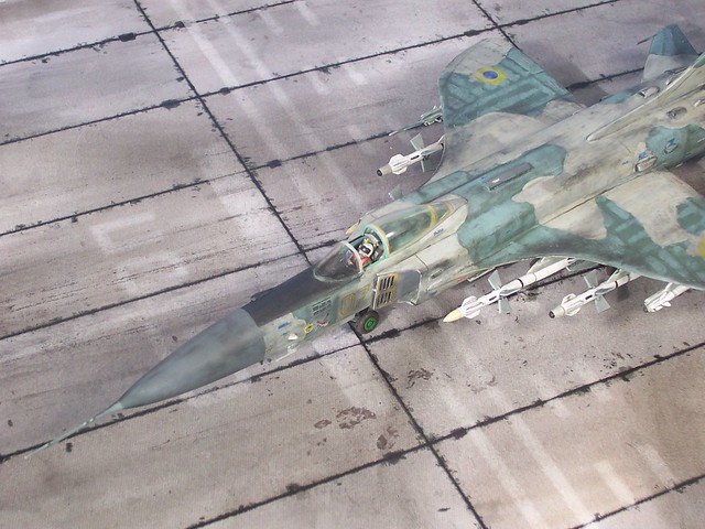

In the end, I am not truly convinced of the result. The wing shape is basically correct, but the real thing would have had more slender and elegant wing tips, rather Su-27-like. I made the best from the Concorde wings, but it's not perfect. Additionally, the cammo scheme ended up with more contrast than expected - the greeenish grey is too dark, even though the resulting look is not too far off and suits the slender Su-15/19 well.
But there's more whiffy stuff to come from the Su-15 genetic pool... ;)
Thanks a lot, even though this one is pretty simple and ...ugly.
Not as good as intended, for various reasons (wing shape, paint finish).
The picture look better than the real thing, though.  :-\
Ed S
Brilliant kitbash. You make it look simple. The fading on the paint job is excellent and looks very realistic.
Ed
The paint job is great, and it's a fair stab at an in-service Su-19: who knows how the wing might have developed once they started flight testing it? IIRC, the Su-27's changed quite a bit from the T-10's.
