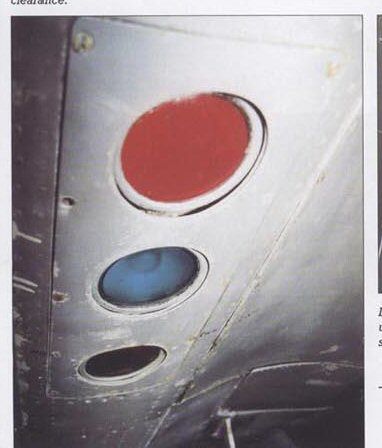

4+ Publications, Mark 1 Guide Spitfire F Mk.22/24 has these:
Which look yellow, green and red.
Interestingly the caption for the 2nd pic reads: ... (front to rear: Amber, Green and Red).
But, to me, the "green" looks blue and the "amber" looks black.
YMMV.

Quote from: Mr.Creak on September 19, 2012, 07:32:12 AM
YMMV.
IIRC, some green lights in the WWII/early post war era were yellow bulbs with blue lenses.  So if that's the case, the 'black' lens could possibly be clear in shadow.  It also could be amber but showing up dark due to the poor lighting.
Not so much yellow bulbs as the fact that the DC bulbs put out a decidely yellowish light.
A bluish/aquamarine glass seems to be pretty much the rule, as I've also seen it on vintage
boat nav lights.

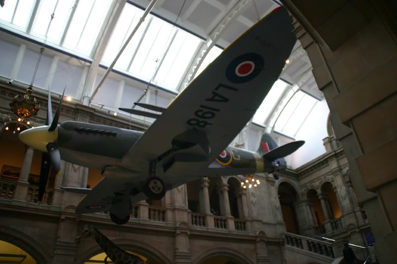

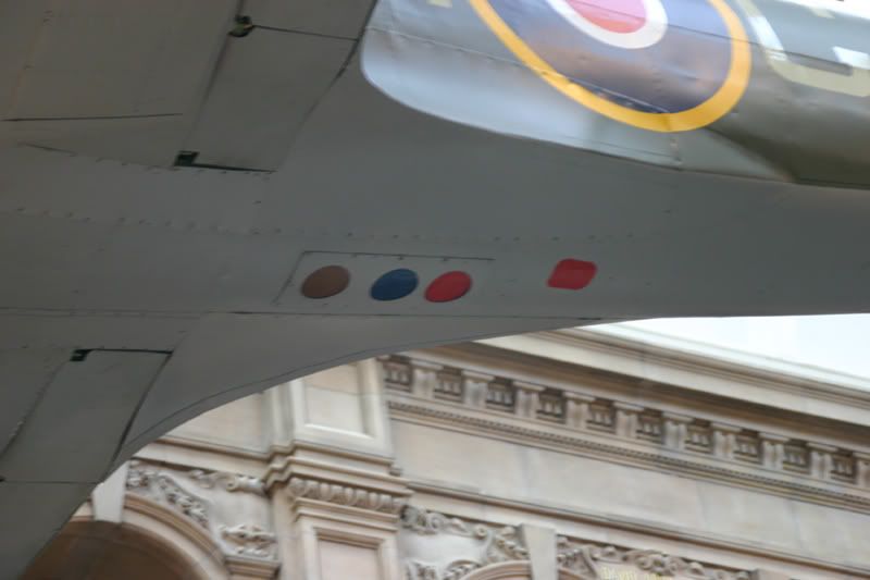

To settle this question I took a trip up to Glasgow this afternoon to have a look at the spitfire F21 that is hanging in the Kelvingrove Museum/Art Gallery.
As you can see from these photos the colours are from the front  Yellow, Green, Red.
This of course does assume that a/ the Kelvingrove Spit is correct, and b/ all Spit's had those lights in the same order.  :blink: :rolleyes: :wacko:
Jim

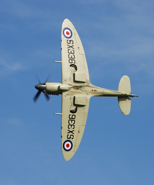

I was just browsing photos of Seafire 17 SX336...
... and the lights on it are red, amber, green, from front to rear  :wacko:
You can get a larger photo at:
http://www.flickr.com/photos/30080678@N04/4136101223
Perhaps each Mark has a different arrangement?
Or maybe Supermarine just installed at them at random?
