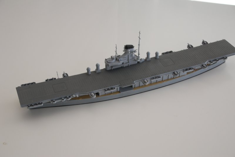

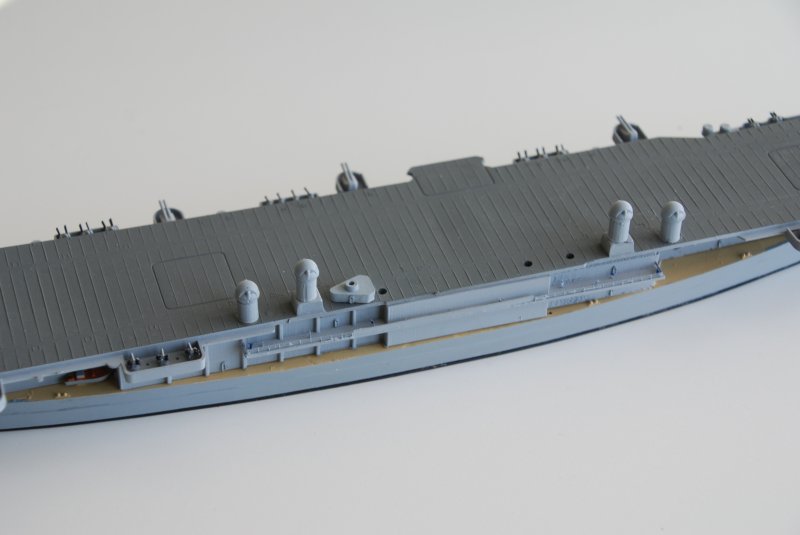

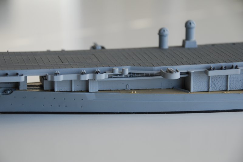

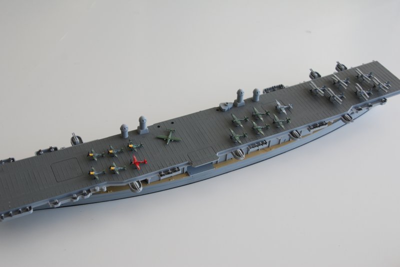

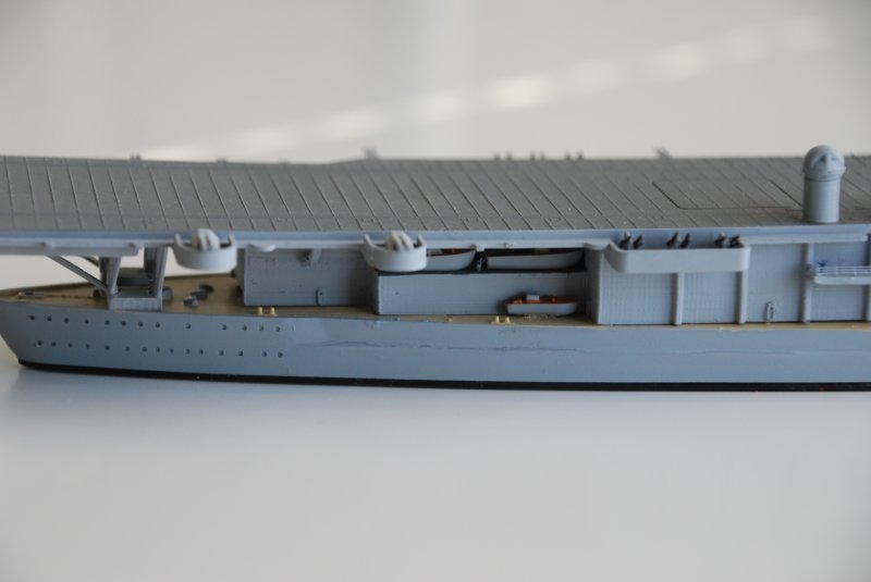

The flight-deck & hangar are now attached to the hull and the rangefinders (Wackeltöpfe) have been added. Almost looks like a carrier now
The air wing has grown, and the flight deck is filling up with aircraft:

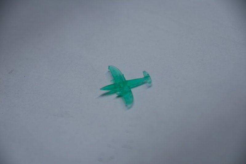

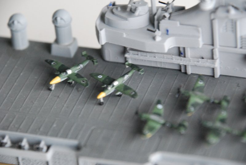

Maybe you have noticed, besides the Me109, Ju 87 and Fi167, there is something new on the flight deck - a He 280.

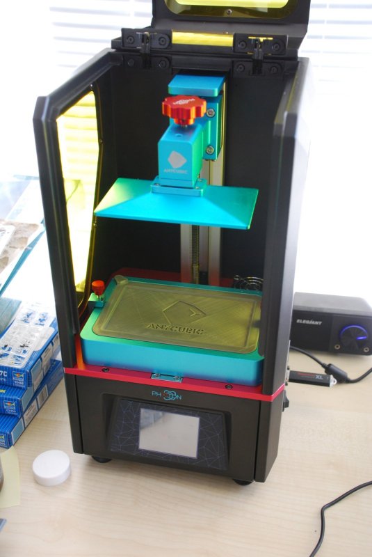

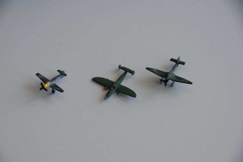

As I mentioned before, my FDM printer cannot print little things in 1/700 scale. So I got another 3D printer, an Anycubic Photon. This is a Resin printer which uses liquid resin to create objects. While the printer itself was about the same price as the FDM printer (less than 400€), running costs of those kind of printers is much higher as the resin is about 50€ / liter.
Working with this kind of machines is much more messy than a FDM printer, a lot more maintenance is required after printing. But the result is quite good, here is the first attempt of the He 280:
Painted and compared with some bought 1/700 planes (Trumpeter)
And this is how the machine looks like that makes the prints:

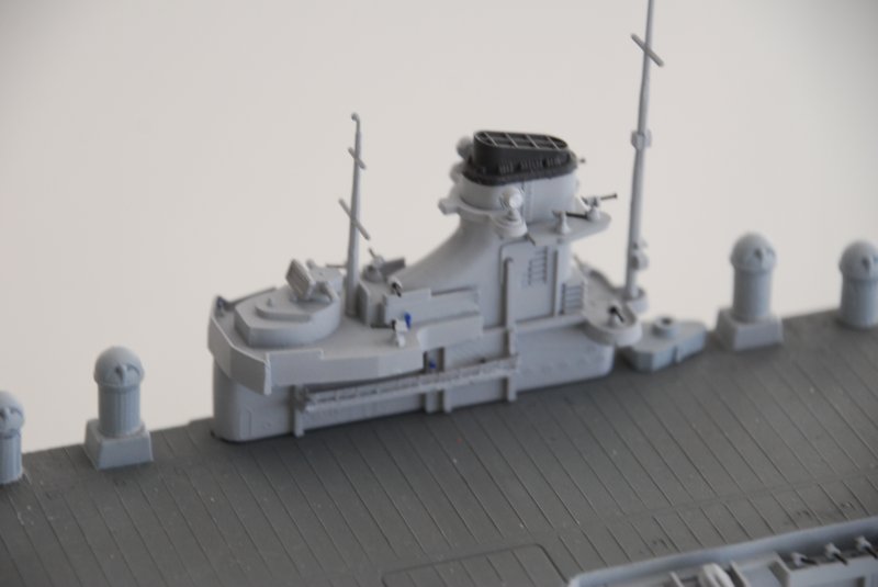

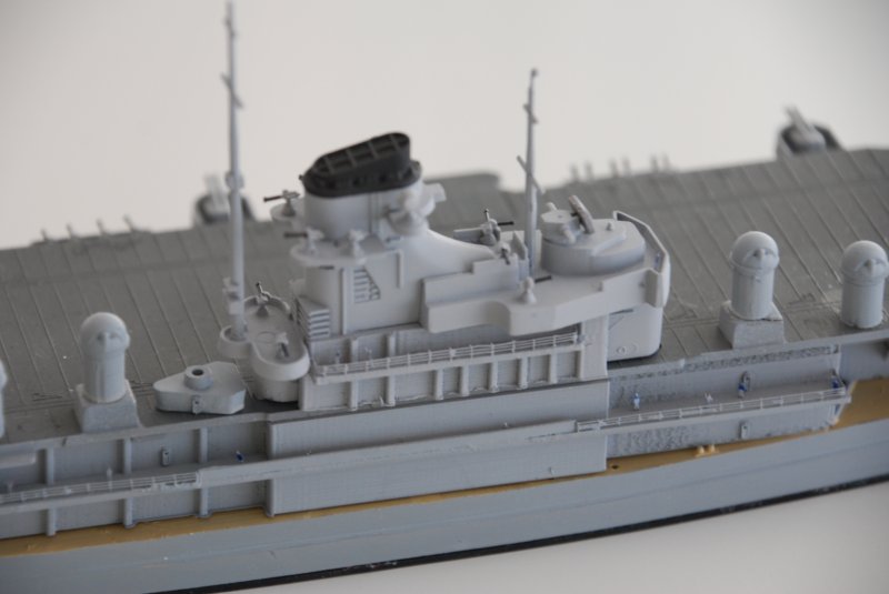

Finally the island is attached to the rest of the ship - and now it looks like a real aircraft carrier.
Only a few smaller parts until the air wing can fly to the carrier. And of course, most of the crew is still missing.

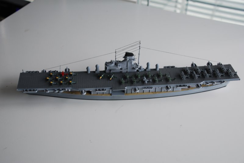

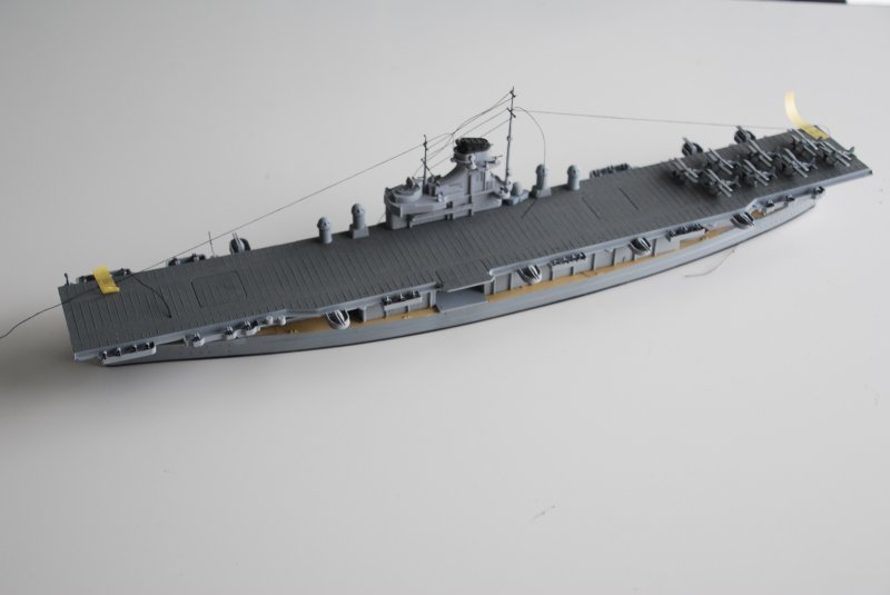

Now starting with the rigging and slowly adding the aircraft on the deck.
nönöbär
Ship: completed
Rigging: done
Aircraft: ready on the deck
Crew: Arghhhh - those tiny PE sailors are missing.....
Besides the Trumpeter Me109, Ju87 and Fi167, I 3d printed a few He 280 jet fighters to add them on board
Working on the crew now....
