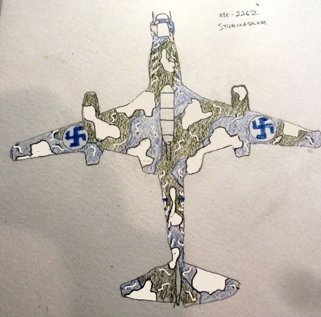

Here is a rough color drawing of my proposed camo scheme--dk. green, med. blue, and white. The "squiggles" are white.They will be used as "mottle" on the sides, and interspersed among the top colors, too. The special top "Hakaristi" roundels will have a slight blue-gray tint to them (NOT white).
I have decided to call this aircraft a "Sturmadler" (Storm-Eagle), that is, one-up from "Sturmvogel" (stormbird---the name of the Me-262 bomber version). I successfully inserted proper nose-weights and bulkheaded them off from view, and then installed wide-track undercarriage. "Proper" noseweights means that if I push the tail down (on a level surface) and let go, it will rock back on its nose--not come CRASHING back on its nose (too much weight).

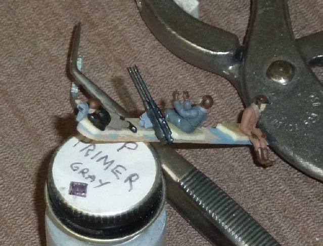

"As promised", each crewmember is wearing a different "uniform" in the "tradition" of the Finnish Air Force. The prone bombardier looking through the bombsight is wearing a shiny, black-leather jacket and brown-gray pants, the gunner is wearing a field-gray tunic and pants, and the pilot has a brown jumpsuit. The thingy in the middle is the twin MG for the gunner.
FWIW-- I like to use a thin "craft-stick" to put double-sided-sticky "foam" tape on, then position my crew on it (sitting or whatever) as they would be in the aircraft. Then I can paint them without having to use my fingers to hold them (I just hold and turn the stick while I paint). The thing in the background is a curved, soft-jawed "jar opener" that I find indispensible.

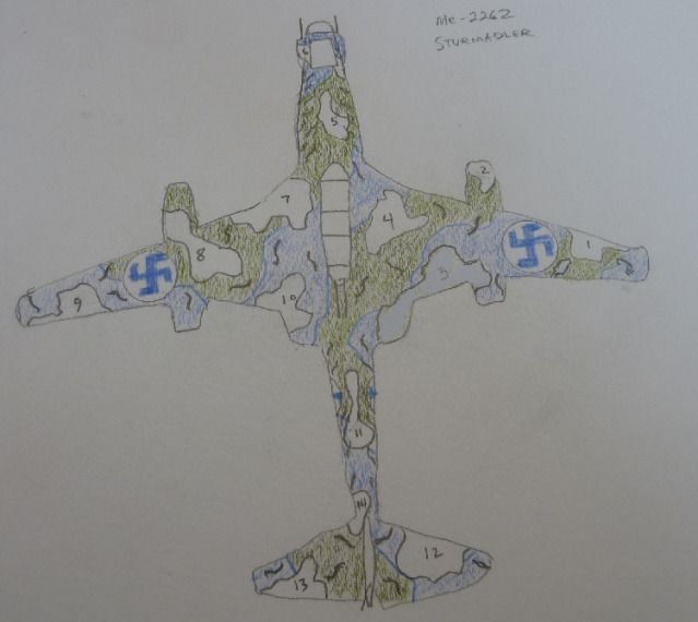

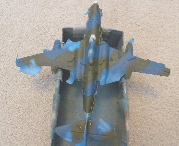

Hoo boy! Courage and process needed here! In order to get the multi-colored camo, with white substantial but not dominating, I had to find a way to get the three colors without all the repainting of "errors", especially since white is SO HARD to make look good. So....I decided to paint the whole upper surface of the 2262 white, then mask off the regions I want white, and THEN spray the darker colors over it. So I drew a rough outline of the aircraft and "assigned" the white patches with numbers on them, as such:

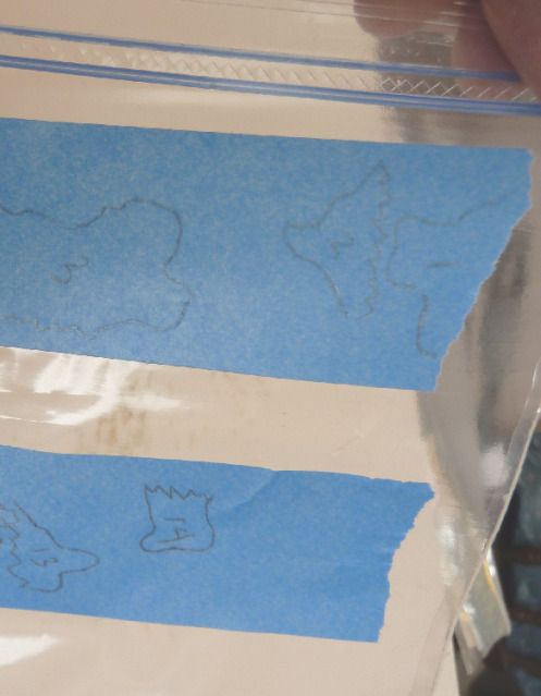

Then, taking 3M light-tack painters tape, I put some strips down on a "baggie" (wanting a clear, but somewhat thick backing to the tape), put the strips over the drawing, traced the outline of the patches, then marked down the corresponding number on the tape patches (the serrated parts are "overhang" that don't need to be exactly cut). The baggie will hold the tape for scissor-cutting (woe betide the person who tries to cut designs in "raw" tape, curling and sticking to everything!).

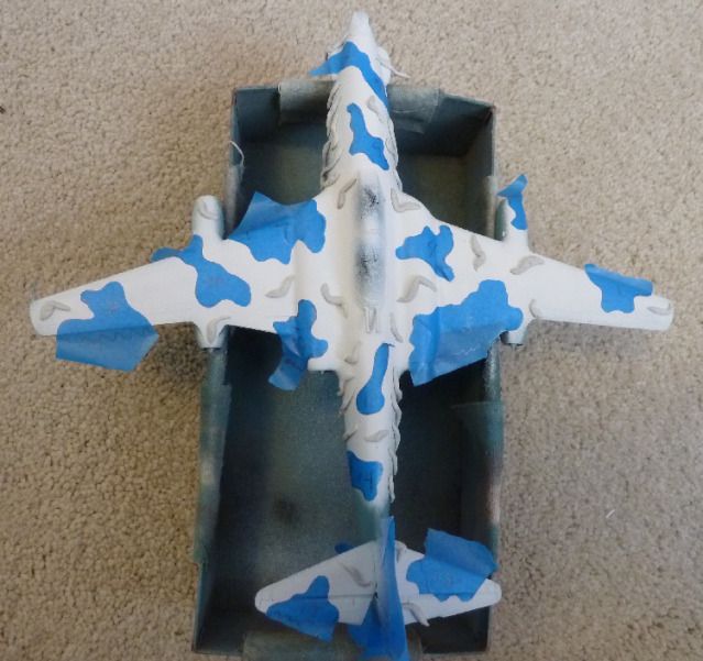

Then, using my "plan" drawing, I carefully peeled the tape off the baggie backing and affixed to the model. I also added "Fun-Tack" squiggles, especially along the sides that would normally be "mottle" on a Luftwaffe plane.
So there it is.  Now I will spray the blue and dark green of the upper camo in waves over the topsides. HOPEFULLY, when I take the mask off, the white patterns will appear underneath and the whole thing will look like my original color drawing!
#41

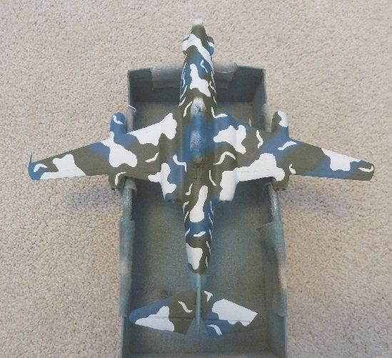

After all the masking was in place, I airbrushed the two chosen top colors:
Then....the magical moment when all the tape and fun-tack come off:
Now it is how it is SUPPOSED to look, with minor touch-ups. I will be adding the pre-decalling gloss coat soon, and get on with the decoration!!
