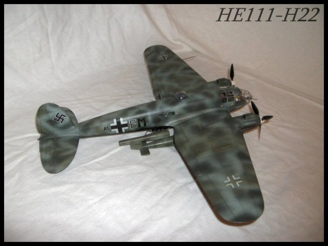

I think this system looks complex, prone to failure, etc.  I think a simple pylon would be a much better operational use setup.  The primary issue with this arrangement is the exhaust from the V1 against the 234 C's tailfin.  My thinking is a pylon slightly offset to one side so the exhaust misses the tail, or angles at a 45 degree angle, etc.  Insofar as the exhaust issue, look at this picture of the mounting on the He 111:
Now that certainly looks like the V1 exhaust will hit the horizontal stabilizer, so why be concerned about it hitting the tail on the 234?  The other question is this: did the v1 engine start while still attached to the parent aircraft and was THEN released, or was it released and THEN the engine started?  If the latter, then the exhaust issue is null on the 234.

AFAIK the He-111s did start the V-1 engine before they dropped it, there was an article about them in an aviation magazine a few years ago, and it said pretty much that.

The exhaust of the pulsejet wasn't as hot as that of a jet engine.  The system depicted is what was intended to be used.  The engine of the Fi103 was lit before launch but the tail wouldn't be in the efflux for very long.   On the He111 the usual method was to start the Fi103's engine and then drop it.  It would recover and fly in what ever line it was pointed until it's fuel ran out or the autopilot told it to switch the engine off.   I expect that the Ar234 would light the Fi103's engine and then allow it to fly up and off the arm.  The arm's only function was to make sure that the Fi103 cleared the tail.   Personally, like many of the hare-brained schemes they came up with, I suspect it wouldn't have acted quite as well as it was advertised.

a V-tail or a Lancaster twin fin would overcome the problem and both conversions would be fairly simple.  I also assume the gantry on the image probably served two functions - one is to isolate the vibration (I didn't think of that) and the other would be to provide some clearance between the two craft.  If the V1 deceided to do something unpredictable, the higher gantry would provide some chance of survival for the Arado.  The pilon provides virtually no room for error.  And the He111 dropped the V1 - if it went dead, it just fell away.
