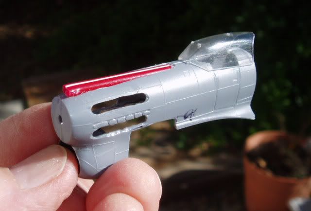

« Reply #20 on: November 15, 2010, 01:28:40 pm »
Progressing rapidly (comparatively), I have added some features to the forward fuselage.
I wanted the "car door" look of the early Typhoons, but the aftermarket kits from Ventura are prohibitively expensive. I had thought of vac-forming some of the fuselage and attaching a canopy piece, and having the "car door" slightly ajar to "show off" the car door, but I have so many "issues" right there with trying to match up different fuselages, wing parts, and cockpit parts, that instead I have gouged out a "doorframe" and handle to give it the look without the work (heh, heh!). I may change the camo on the door slightly, as if it were a replacement off a different Henley, and to bring attention to that detail.
I wanted the early Tornado dorsal carburetor look, so I found a double-barrel stirring straw for a "pig-nose" double intake.
The "dual exhaust" holes for the two rows of Hurricane "horn" exhausts are evident--I need to putty and obliterate the old exhaust area.
« Last Edit: November 15, 2010, 02:08:15 pm by sequoiaranger »

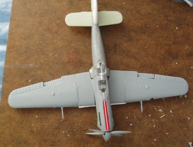

Henley Divebrakes
« Reply #23 on: November 16, 2010, 08:42:59 am »
In one of those RARE instances of whiffery, the divebrakes were EASIER to make and install than I had thought. I found I did not need to make inner wing structure to keep the airfoil, as I had previously feared, and the thickness of the dive brakes corresponded EXACTLY to the place they would occupy. WHEW! The dive brakes come from the injection-molded Brewster Buccaneer (expensive kit, and merely parted out for other models!). I carefully cut out sections in the Henley wing, then cut and matched the Buccaneer pieces to fit. In the pic below, I pasted the new look onto an older photo. On the left, of course, are the dive brakes mounted in the wing. The inner dive brakes are "half" flaps (no holes in the wing above it), and will be mounted dropped down on the finished model. the outer flaps are presumably the "butterfly" type (holes top and bottom, split, top half opening upwards, the bottom half opening downwards). I'm also going to have only one 20mm per wing.
I included the tail assembly so you can see the hodge-podge of color--white for vac-form Henley, light greenish for the modified 1/48 Fw-190 horizontal tailplanes, and the dark gray-green of the Revell Tempest fuselage. Still a lot of work to blend everything together and shape it properly, though (ain't there ALWAYS!?).
« Last Edit: November 16, 2010, 08:51:55 am by sequoiaranger »

Mocking-up the Henley
« Reply #25 on: November 17, 2010, 02:34:03 pm »
Here's the Henley a little farther along. I got all the parts of the wings mated (no small task), and worked on the "gap" behind the original Heller Tempest coolant radiator (added Revell's) and how the turret well matches up with the wing beneath it. I had added white sheet plastic spacers to the thin Tempest inner wing to match up to the Hurricane outer (and Henley) airfoils, and now am considering making the protrusions wing-leading-edge oil coolers (as seen on later Hawker products, and already on Mossies and Whirlwinds). I have kept design elements of the Hawker line of products, more or less substituting available injection-molded products for the cumbersome vac-form that would have been the Formaplane Henley. I still have some issues with the underside fuselage, and may add a top fuselage strake to the tail, kind of like the Aichi D3A (Val). Maybe.
Now it looks kind of like a Hawker Tornado elongated into a two-seater and given a four-bladed prop. Yeah!! That's EXACTLY what I wanted!
