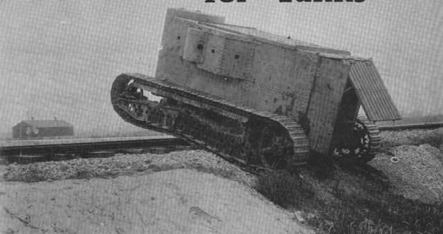

The origin of the tank as such during World War I. Is usually credited to the British, but the French were working on such a device at the same time, with neither knowing of the other's efforts. But what is not generally known is that the idea for this type of weapon appeared during this period in other countries as well. The Italian Pavesi-Tolatti or Pavesi-Cassali two-turreted tank probably pre-dated both the British and French designs, but it seems not to have progressed beyond the mock-up stage. The Russian Lebedenko was a huge tricycle, which seems to have been built but was not found manageable.
In the United States, Cleve F. Shaffer of San Francisco had tried unsuccessfully in 1914 to interest the German consul there in arming and armouring hundreds of little Fagcol orchard tractors. Norman Leeds of the Automatic Machine Company of Hartford, Connecticut built two mock-up hulls on the chassis of the firm's commercial 'Alligator' vehicle, calling them the 'Automatic Land Cruiser I. and II.'. U.S. Patent No. 1,161,267, issued to W. T. Taylor in 1915 covers an amphibious tank bearing a remarkable resemblance to the modern LVT(P)5. The inspiration' for the British and French tanks was the American Holt tractor, then in use in both armies. It therefore was natural that Holt would capitalise on the fact. The Holt plant at Stockton, California built several mock-up hulls called 'Special 18' or 'Scat the Kaiser'. One of these later was refitted with a Cadillac engine, thereby doubling its speed. There also was a tiny HA 15 one-man tank powered by a motorcycle engine and resembling the British heavy tanks of the period. Another Holt vehicle was the G-9, built at the Peoria, Illinois factory. This was a standard 10-ton tractor with an armoured box surmounted by a small revolving turret at the front and another larger one at the rear. It was tested at the Sandy Hook, New Jersey Proving Ground, predecessor to the Aberdeen Proving Ground facility.

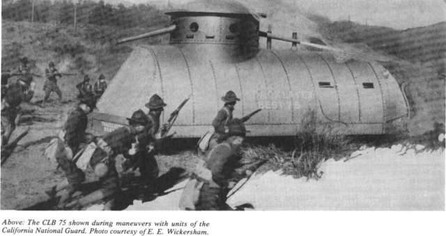

The C. L. Best Tractor Company of San Leandro, California built two mock-up types on their CLB 75 tractor. One had a semi-cylindrical hull with a turret and the other was similar but the hull had flat surfaces. These two machines appeared at a Fourth of July celebration in San Francisco in 1917, in manoeuvres with units of the California National Guard. Another Best vehicle was a tiny cable-controlled demolition tracklayer known as the Wickersham Land Torpedo, which pre-dated the German 'Goliath' of World War II. by almost 25 years.

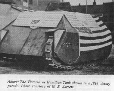

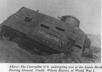

Designs from other manufacturers also appeared. One was the Skeleton Tank, a vehicle made up of plumbing pipes and connections and bearing a general resemblance to the British heavy tanks of the period. It was submitted by the Pioneer Tractor Company of Winona, Minnesota. A simple smaller version of a British heavy tank but with a small turret was the Victoria, also known as the Hamilton, built by the Oakland Motor Car Company.
Still others included the Holt Gas-Electric Tank, a boxlike affair somewhat like the German A7V of World War I., and built jointly by Holt and the General Electric Company[its picture appears at the head of the article]. By the time the United States had entered World War I., mobilisation and production problems were tremendous and decisions regarding armament had to be made in order to make American power felt as soon as possible. An Army armament board in Paris recommended that, insofar as tanks were concerned, we should adopt two types, a light and a heavy. But it was not until three months later, in September, 1917, that a final decision in the matter was made and there was no follow-through until December of that year.
Industrially from then on, all was confusion. There were optimistic estimates as to production. The French furnished us with the first Renault FT light tank off their assembly line, which we were to produce as the 'Six Ton Special Tractor (a code name). In February 1918, the AEF was told that the American copy would be in production shortly and that the first six vehicles would arrive in France in April. However, in February the drawings had not yet been converted from metric measurements and not all contracts had been let. Order did not come out of chaos until October 1918, and the first few tanks did not reach France until after the Armistice in November. For heavy tanks, the British Mark VIII. design was adopted, although none had yet been bruit. The plan m tins case was to divide construction between England and the United States, with assembly to take place in a new factory to be built in France. A few of these tanks were completed in England and 100 were built at Rock Island Arsenal in the United States from parts purchased in England, but not until after the war was over. The Mark VIII. and the Six Ton Tank remained the standard U.S. tanks for years following World War I.

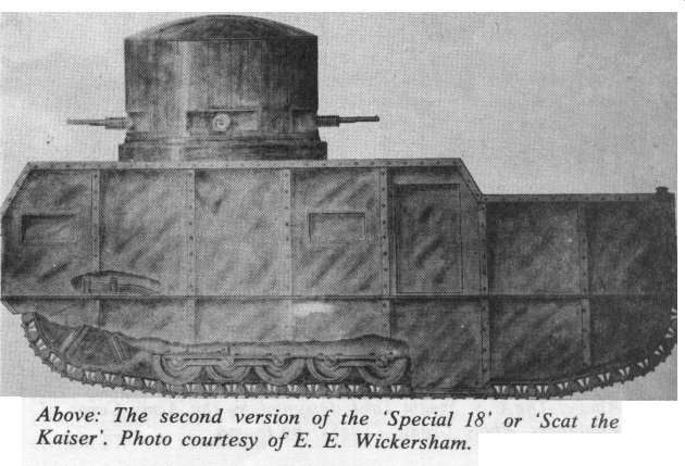

However, part of the confusion over tank production was due to other designs being urged on the Army. Besides the vehicles already mentioned, there was the Mark I., or Ford Three-Man Tank, built by the Hudson Motor Car Company, then owned by the Ford family. This tank had resulted from a request by the Service if Supply in France for such vehicles for security purposes. Ford also proposed the little two-man tank which utilised many standard Model T parts. This vehicle was so well received by the Ordnance Department as a machine gun carrier and tractor that 15,000 were ordered, however, only some 15 reached France before Armistice Day, 1918, and the remainder were cancelled.

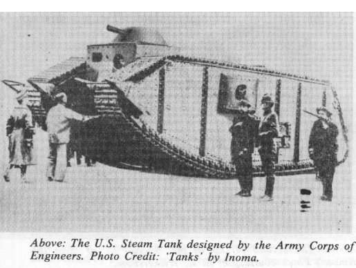

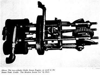

The Steam Tank was a project of the Corps of Engineers. A flame-thrower demonstrated in November of 1917 was so successful that the Corps of Engineers decided to build a tank to carry it. There was some reason for the Engineers to become involved in tanks, since the U.S. Tank Corps originated by converting the 1st Battalion, 65th Engineers into tankers. The Engineers had no funds for the project, but a firm of bankers in Boston financed its building, which was accomplished at the Endicott and Johnson Shoe Company. Its design closely resembled that of the British heavy tanks of the day, and its armament comprised flame-throwers and machine guns. The Steam Tank weighed 50-tons and it was powered, like the Steam Wheel Tank, by two Doble steam engines. These were not the first steam-powered combat vehicles ever built, however. In 1900, two unarmed steam-powered cars mounting Colt machine guns had been built by cadets at Northwestern Military Academy. then at Highland Park, Illinois, under the direction of the Commandant, Colonel R. P. Davidson. These cars were used by the cadets in manoeuvres for several years, and were driven to Washington. D.C. over the very poor roads of the time. The Russians also built a steam- powered car in 1900. This was the Dwinsky armoured car, designed by the Imperial Artillery Committee. It was found to be too heavy and was underpowered, and it was abandoned. The first successful armoured steam tractors used in war were built by the British Army during the Boer War in South Africa. These were commercial steam driven Fowler tractors enclosed in armour and drawing armoured trailers in train. They were used to carry artillery and personnel.

Some of the Doble four-cylinder steam powered cars are still running today and at least one has logged over 600,000 miles. However, through no fault of their own, the Doble firm became bankrupt early in the Great Depression of the Thirties. By this time, other American firms had sprung up to build steam cars, but these also disappeared from the scene, after building only a few cars each. They included the Brooks, Coats, Delling, Gardner and Gearless. General Motors built a steam car but dropped it. From 1897 to 1925, there actually had been some 80 different steam car manufacturers.
Abner Doble became associated with A. & G. Pierce in New Zealand in 1931, where an A.E.C. bus was successfully converted to steam. He and one brother went to England the following year, where they spent two years acting as consultants to the Sentinel Waggon Works. The Sentinel steam powered truck was then dropped because the firm decided that it could not compete with diesel powered trucks.
At the same time, the two brothers travelled back and forth to Germany, where they licensed two companies!es that made steam powered railway cars. buses and trucks. Little money was available, however, since Germany was beginning to pour money into arms production. During the same period, the former Allies were still suffering from limited appropriations for military purposes. Hugh stocks had been left over from World War I. and, although experimental combat vehicles were being built in almost every country, money was tight because of the world-wide depression.

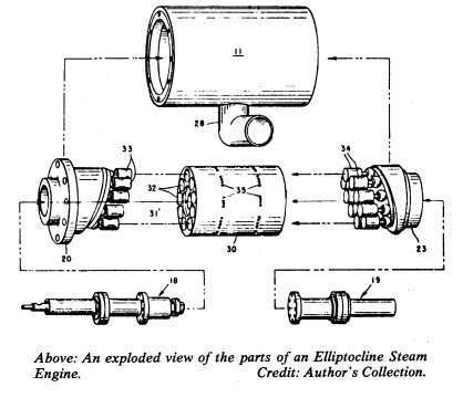

Testing the engine with compressed air proved it to be in perfect working order. Layouts showed that installation in the M4A4, which had a slightly longer hull to accommodate the five Chrysler engines around a common crankshaft, was feasible. However, the project was killed. A long list of young Ordnance officers in the Pentagon, most of whom in peacetime were employees of the several automobile manufacturers and oil companies, killed the request with their sarcasm writen on the 'buckslips' so common in the Pentagon during World War II. I still have them. Most are humorous, some of them painfully so, but none showed any real thought having been given to the proposal. The rejection was a disappointment, especially in view of the millions of dollars then available for research, with so much of it visibly squandered.
Later, it was learned that Henschel in Germany actually had been making layouts for a steam power installation in a Tiger tank at almost the same time. They found that existing boilers and condensers occupied too much space, and since the OKH was disinterested, the project was dropped.

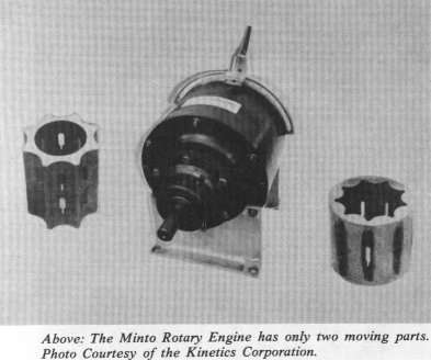

There have been other firms which have developed experimental engines or actively build and market a range of steam engine designs. Among these is the Williams Engineering Corporation of Huntingdon Valley, Pennsylvania. This company each years sells a few cars of standard makes in which their four-cylinder engine has been substituted for the original engine. Other William's engines range in size from 10 to 1,000 horsepower
Some of the other post-World War II. steam cars include one with a three-cylinder Paxton Vapor engine (not the McCulloch engine) by Paxve, Inc. of Newport Beach, California. A thermo-Electron one-cylinder car is made by a firm of the same name. A Volkswagen Microbus with a Kinetics Corporation rotary Minto engine is another. This engine is a positive displacement rotary type, with internal reversibility, and has only two moving parts. It is a vapor engine, using Freon gas instead of water.

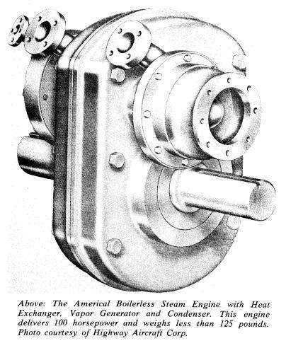

Even later is the 'Fascination' sports car, which is being marketed by Highway Aircraft Corporation of Sidney, Nebraska. This car is powered by a 100-horsepower engine measuring only 5x6xl2-inches in size, called a vapor generator steam turbine engine. The engines are made by American Boilerless Steam Engine Corporation.

Man, you gotta love that CLB 75! Apparently highly impractical as an actual AFV but it just looks so cool in a weird sort of way.

Looks like it should be fighting "aliens" who wear gorilla costumes and diving helmets and fly cardboard spaceships..... ;D

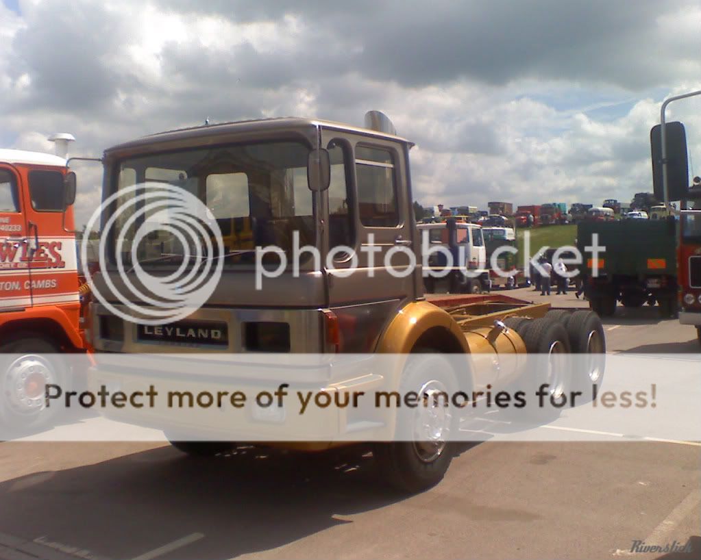

A somewhat related development was turbine engines. Here's one Leyland experimental turbine truck from the '70s, recently restored:

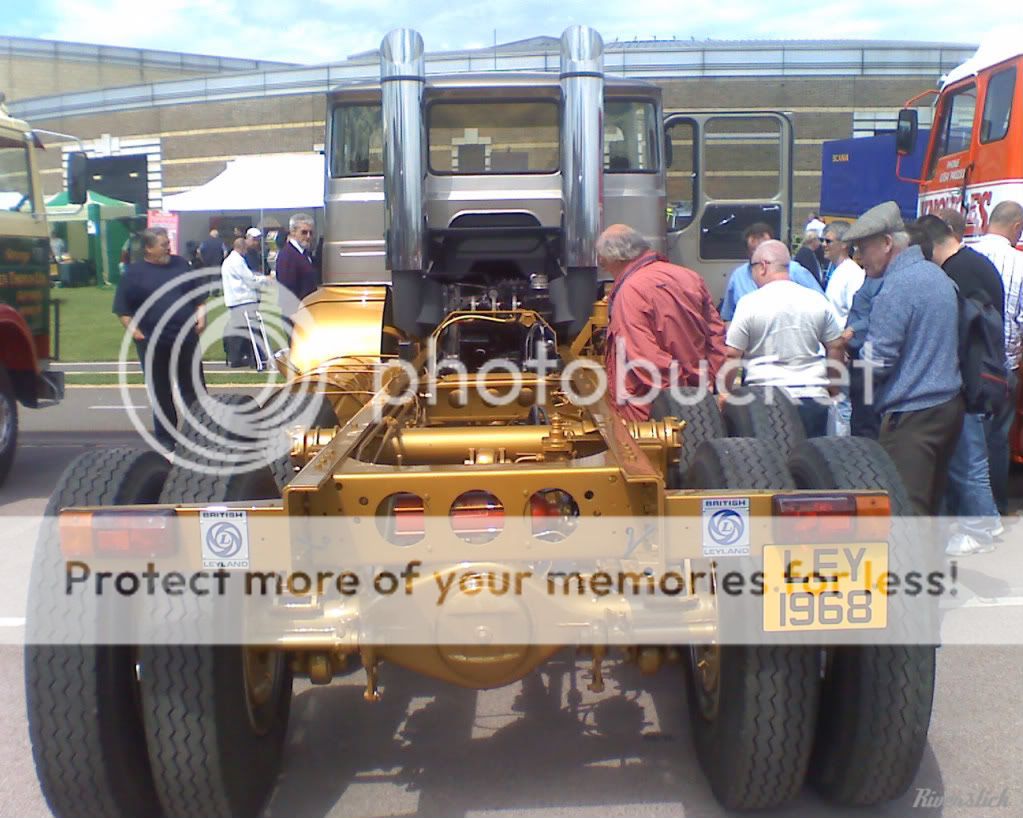

and from the rear, note the size of the exhaust stacks:
(searching for "Leyland Turbine" turns up more photos, plus some Youtube videos)

Steam or gas turbine?
That's a gas turbine, but you can imagine a similar arrangement with a steam turbine.
Mainly, it's an excuse to show a nice photo of a very unusual truck.
