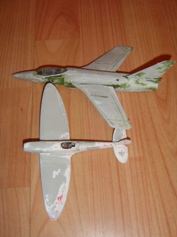

I've had more problems with Fairy Power Spray.  It doesn't appear to like the new Humbrol Acrylics.  I've had two models that I've tried to strip with the Power Spray & I've used Humbrol Acrylics on both.  At first I thought it might be a dodgy batch so I got a second bottle (can always use it as oven cleaner I suppose!) but it didn't make any difference.
Firstly was the Spit that I was doing up in Spanish Republican colours, I'm still trying to get to grips with the air brush & cocked up the underside.  Not to worry I thought, Fairy Power Spray will do the trick, but no.  It softened it but didn't shift it easily.  Same with my F11F that I did earlier in the year, after seeing Spinners CGI RAF Tiger I thought I could do it in time for Telford, but same result.  It took several hours of scrubbing with a green kitchen scourer (tooth brush just wouldn't touch it) to get to the point shown in the photo.  Both attempts have used at least three dowsings of the stuff & the Spit I left for 24 hours at one point, to no avail.
Looks like I've ruined a perfectly good model in the Tiger, broke several pieces of it whilst scrubbing. >:(  Might be recoverable if I can find something else that strips the paint better.
Is it just me or what??? :(
