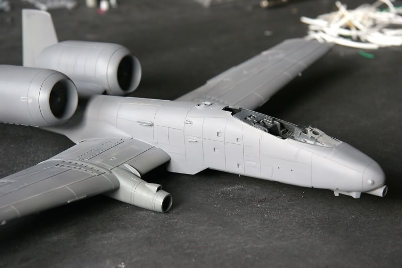

Here's another little update on my SandHog.

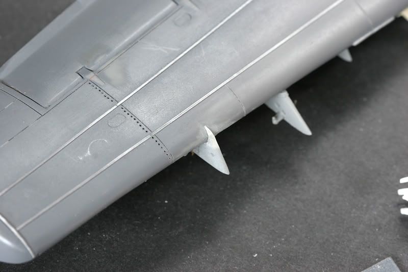

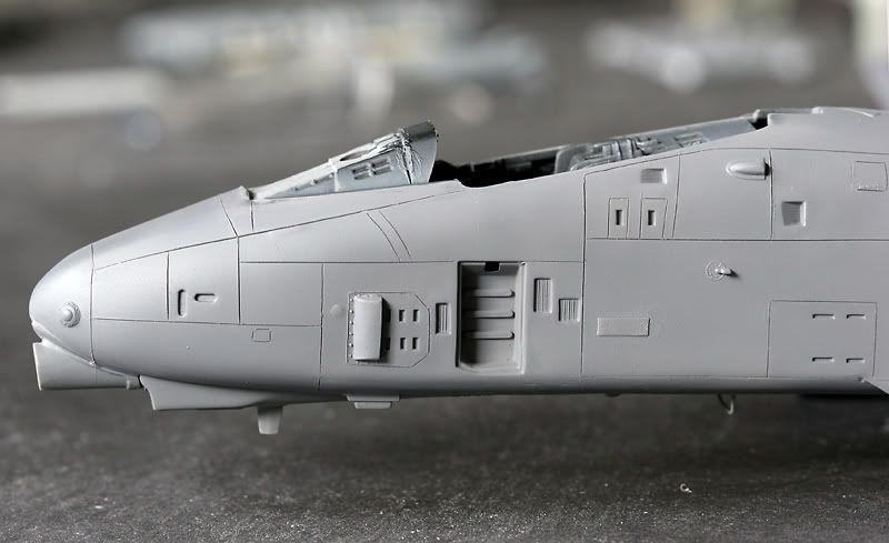

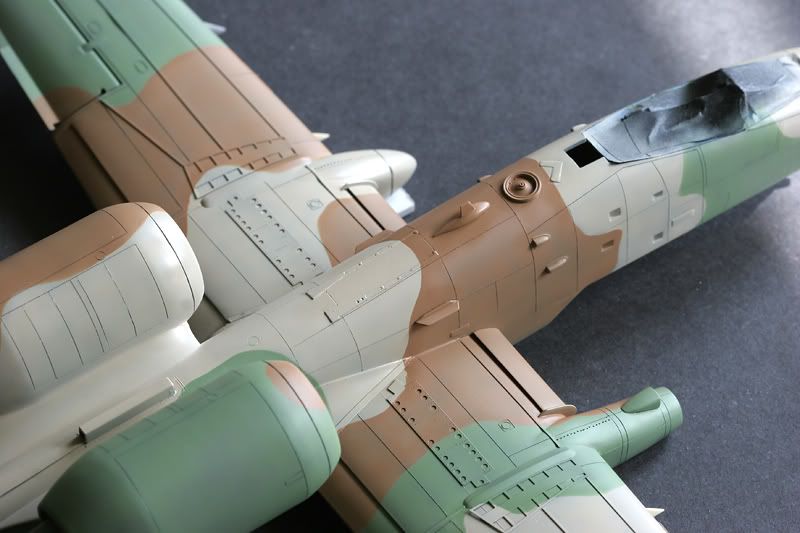

Well I rescribed the Fuselage from nose to engine mounts not going to rescribe the tail area. I save alot of raise rivet detail that will look great after some dry brushing. <_<
And here's the other side. You can see my pile of used graphic tape in the background. Not knocking scribing templetes but I like to use graphic tape when scribing. Using graphic tape V's scribing templetes.... well it's easier to conform to surface and  I did not have to try to hold the template in place as well as holding the model and whatever scribing tool I was using. Just tear a piece off, place it where you want, start scribing and when your happy, peel it up and move on. I like Chartpak graphic tape, it's cheap, it stick well and it's think enough to use as a guide.

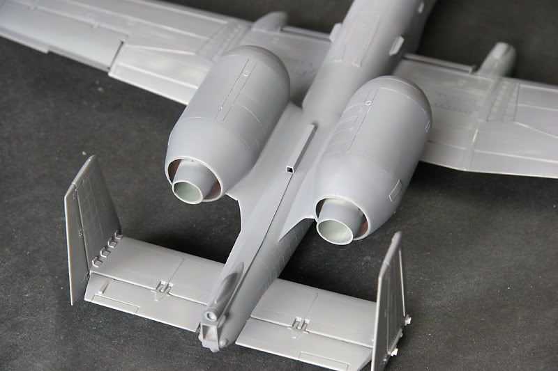

Had some work to do around the engine to airframe area. after a little putty/sand/putty/sand/ prime, look pretty good. :thumbsup:

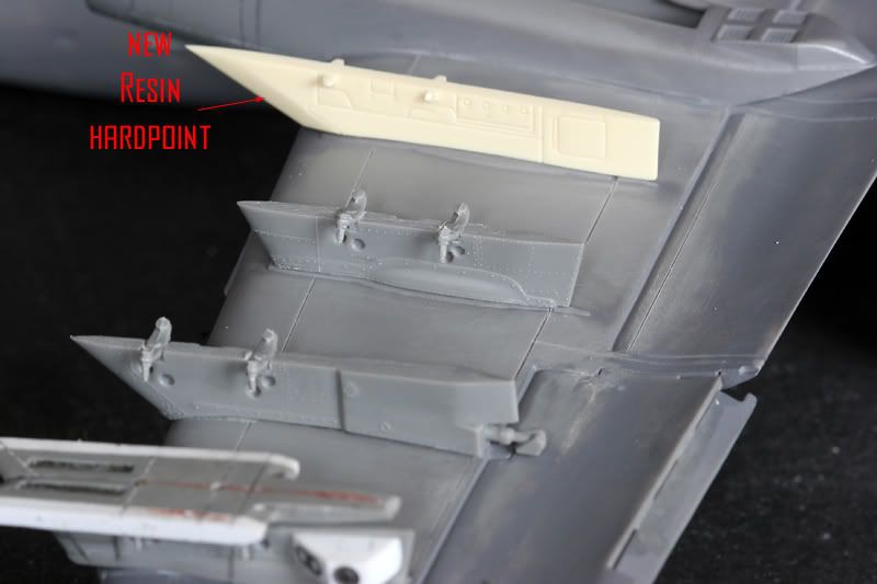

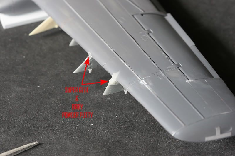

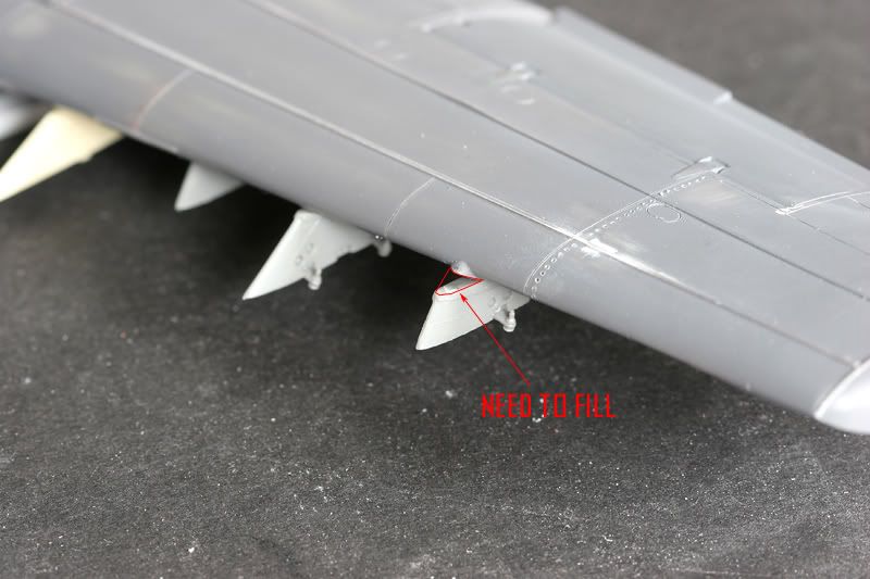

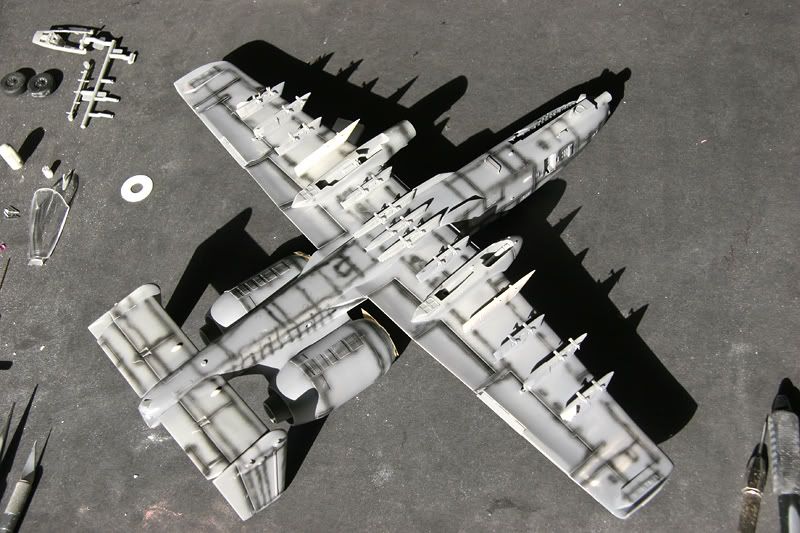

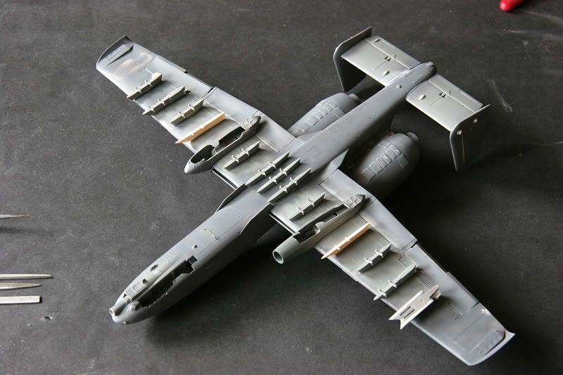

She now got all 13 hardpoints glued to her wing. It took some time to clean up and glue all those sway braces in place. Still got some filling to do on hardpoints 1 and 13.
I used my favorite putty(super glue and baby powder) the fill above the hardpoints
and after a bite of filing and sanding...

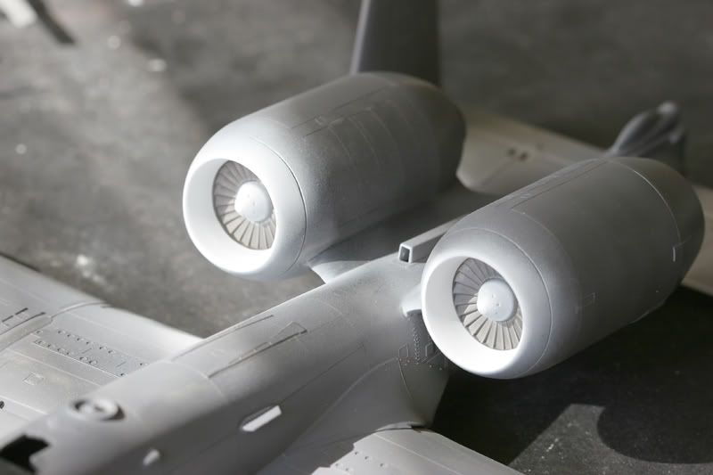

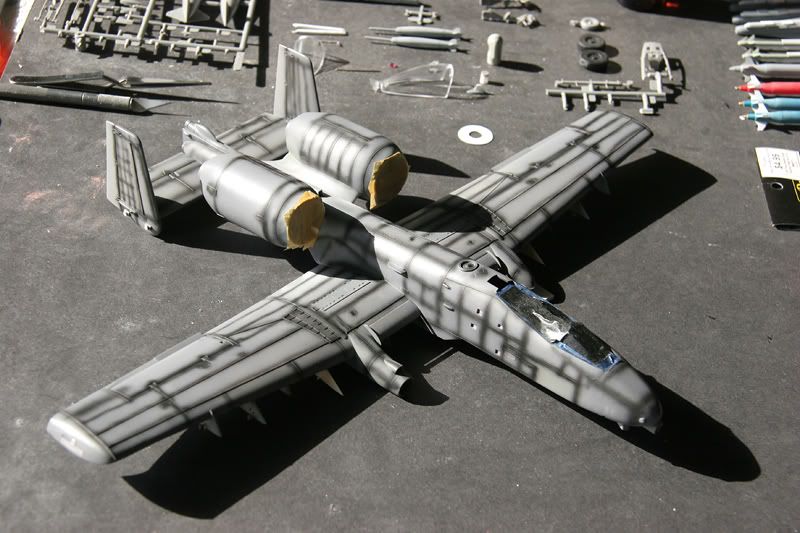

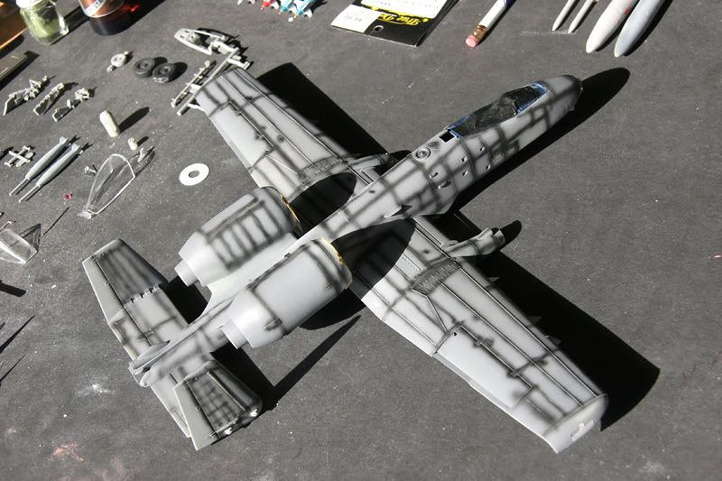

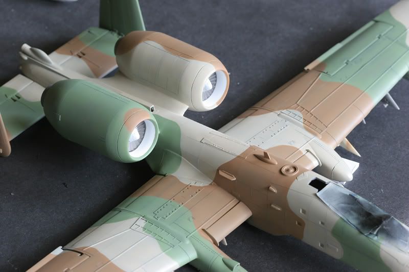

Painting of my Sandhawg has started.

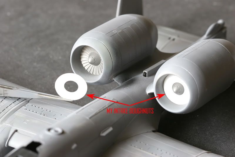

It is slow going, getting use to my new set up. I started with one of the hardest things first, the fan blades and the inside of the intake. Heres how I did it. With a pair of caliper I measured the diameter of the inside of the intake as well as the cone at the center of the fan blades. I then transfer those measurement on to a piece of .02 styrene. Making two intake Doughnuts(like Homer, Mmmmm....Intake Doughnuts)
I first shot each intake with Testors Burnt Metal Buffing Metalizer, not worry about over spray. I then let dry and buff then seal it. Next, I put the intake Doughnuts in place and shot flat white around the walls of the intake and once dry I pull out the intake Doughnuts.
FAR148
Here's a list of the major changes I have made to my Sandhawg
*Targeting pod added to the landing gear fairing
*Wing and fuselage reinforcement strips
*Wing extension
*2 extra Hardpoint, Total handpoints now is 13
*Scratchbuild/kit bash engines
*Brake parachute housing
*IR jammer
*rescribed panel lines
*Extra chaff/flare boxes under wingtips
*Close the decelerons

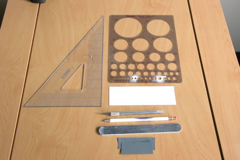

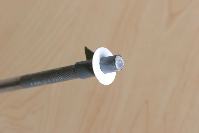

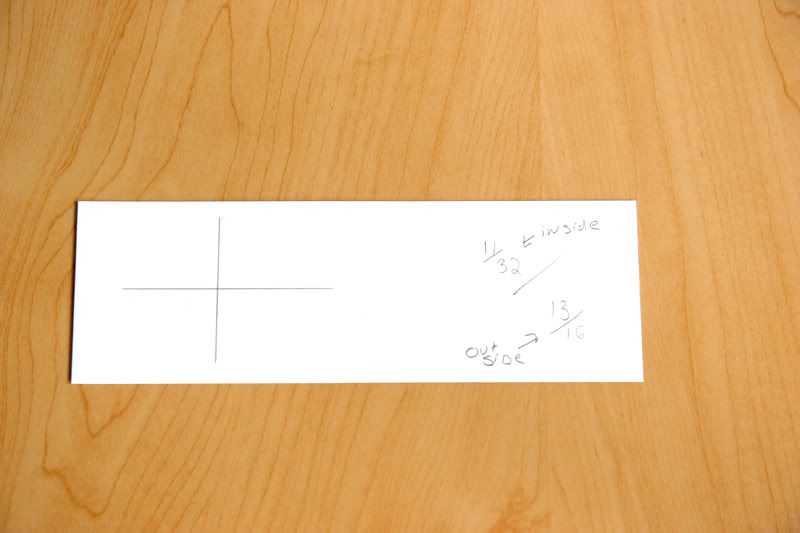

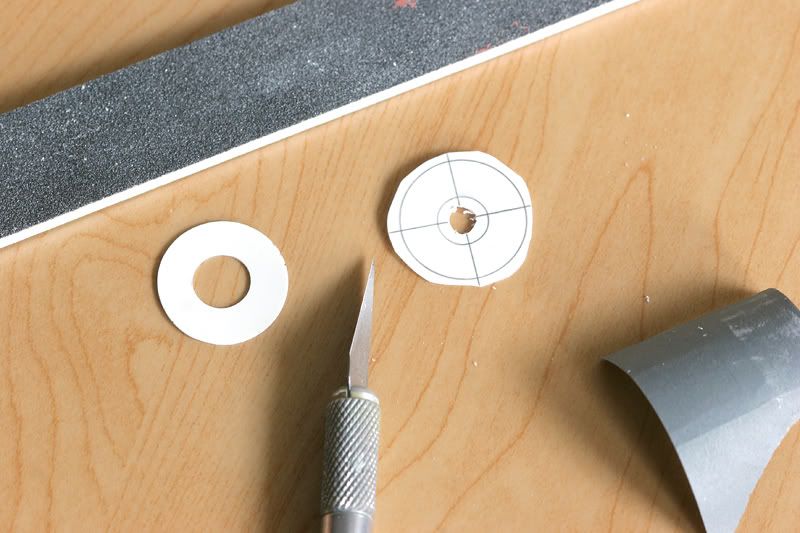

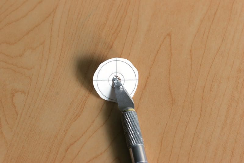

Here's how I made the mask for the fan blades. First you'll need a few things, a cicrle template, a triangle, a exacto knife with a new no#11 blade, a pair of scissors(not showed) a pen or pencil, a piece .20 of sheet styrene and your favorite sanding tool .Me , I like a sanding stick (rough/med) and sheet sand paper(320 or 400).
With my triangle , I drew a cross hair to guide for the two circle. For the Monogram kit, I used 11/32 circle for the inside diameter and 13/16 for the outside diameter.
Lets start with inner cicrle. With a new and sharp no#11 blade, I pushed the tip of the blade through the center of the cross hair and then slowly begin the twist the blade around in a cicrle. Starting a small hole and slowly carving. Getting larger but, I stop close to the line not going to it.
I then wrap a strip of sandpaper around the handle of the exacto and slowly sanded to the line.
And for the outside diameter. With a pair of good shape scissors, I cut close to the outside line but not right on. Now with my sanding stick, I can sand right to the line.

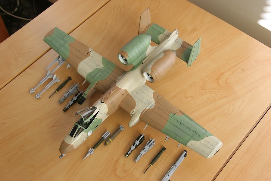

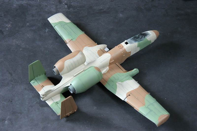

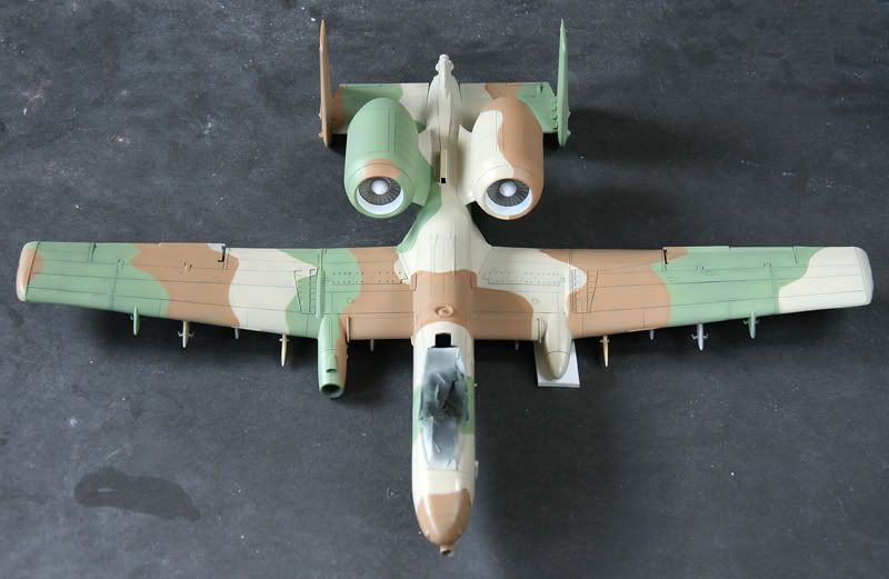

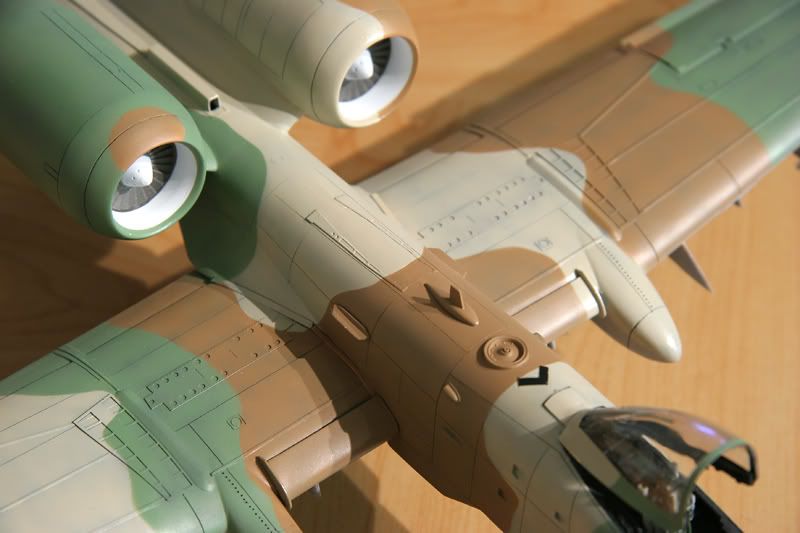

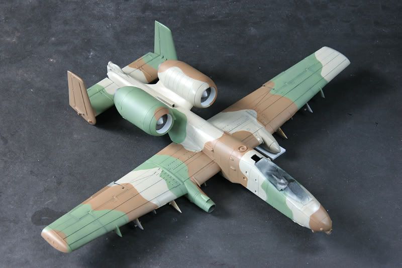

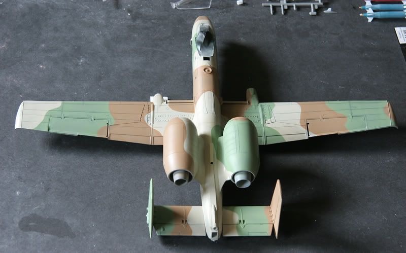

Here's a post I know many were waiting for, including me. Still have to paint underside and other detail.
Enjoy!

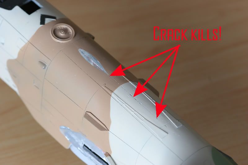

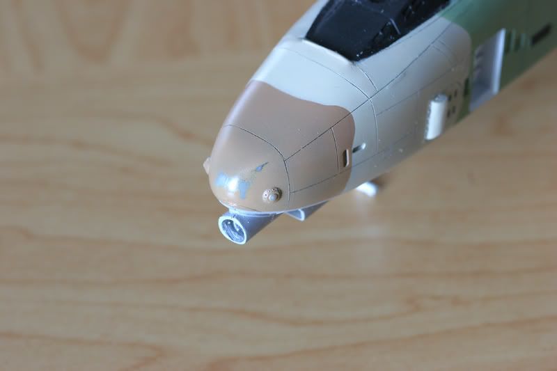

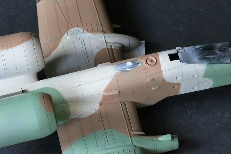

During paint, I dropped my Hawg....Like all model tragedies, it happened in slow motion. Breaking off the whole right tail assembly!   :o :angry: I finish spraying whatever color I was shooting. I than super glued the tail back on without any problem and without having to go though the putty/sand/putty/sand routine. After I finished the camo job, I was admiring my handy work and notice a new panel line running straight down the center of the fuselage! after a bit of   :banghead:  I let the paint dry for a day and then I hit the crack with some Proweld to seal it. After that I applied some red spot putty and let it dry.
After sanding and resrcibing a few panel lines back. I than reshot the sand color. Even those the crack repair is a pain in the ***, it give me a chance to add one of my bumps and antenna combo I forget to add before paint. With a bit of superglue, I placed the bump and antenna combo.
I then remasked the sand color with silly putty and shot the light brown. Good as new!

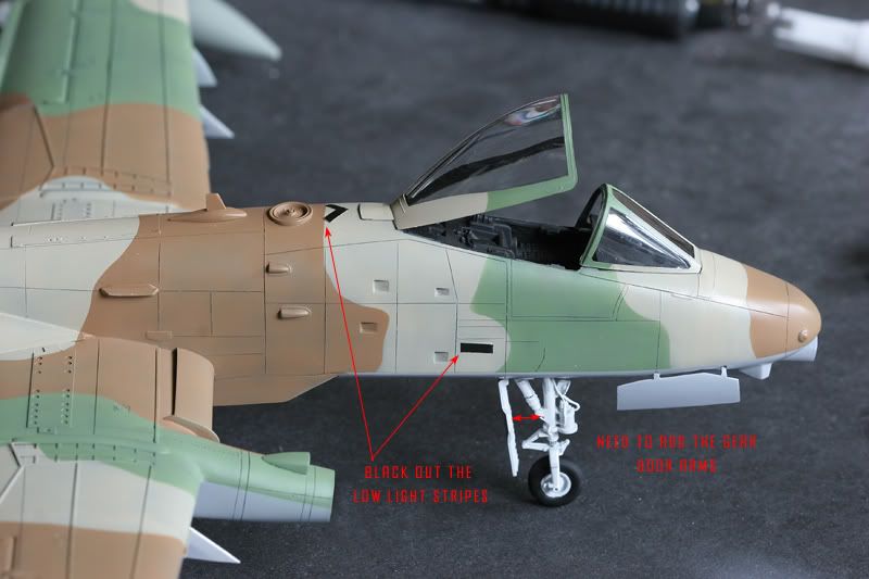

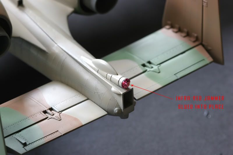

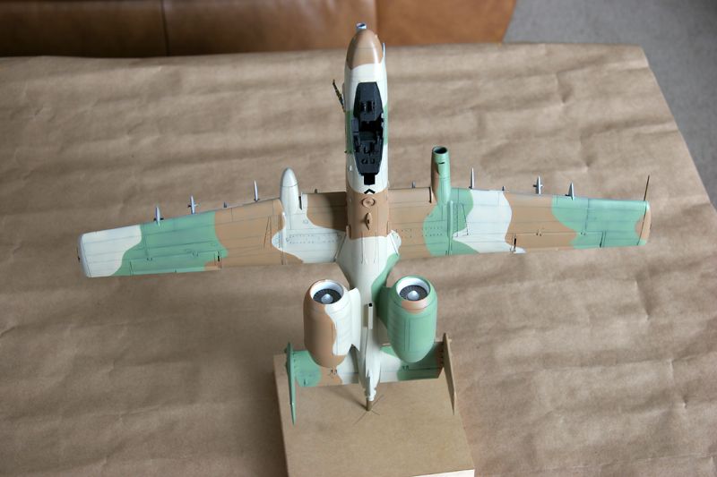

I got the IF jammer glued into place.

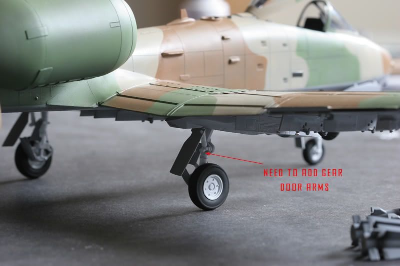

This pass weekend I did manage to get her up and on her own legs! I all so painted the canopy as well as black out the low light stripes.
I drop the scratchbuilt LGB idea after destorying two trying to cast them. So I'm going with two GBU-12 and two cluster bombs. They is a tonmore detail I'm going to do but just not now,

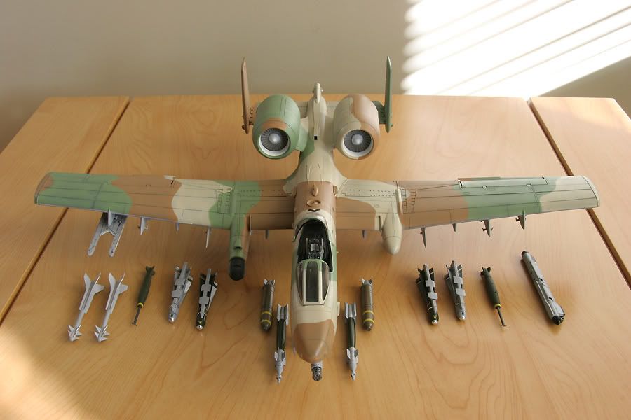

Here's my IAF A-10I "Chazir" as of July 3, 2008.

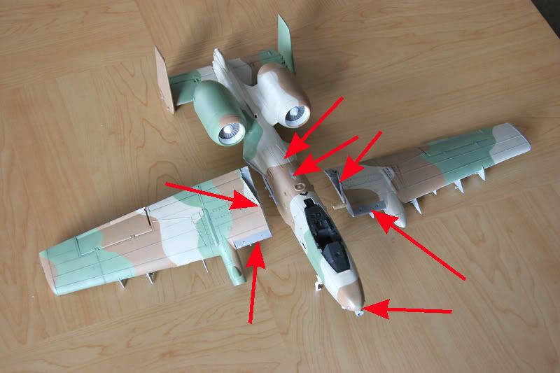

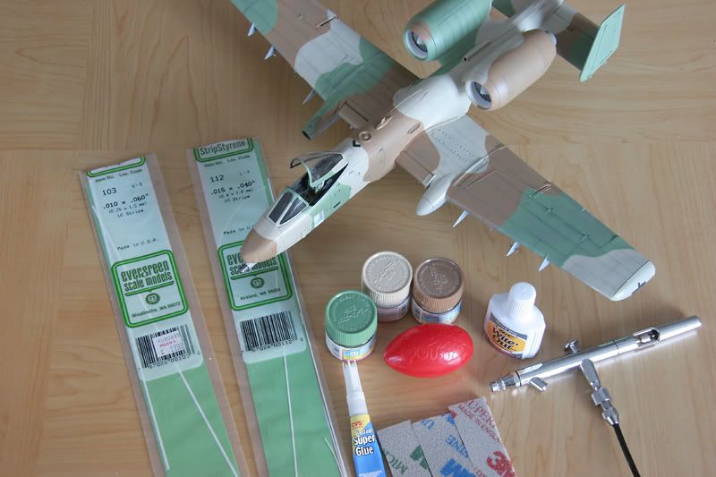

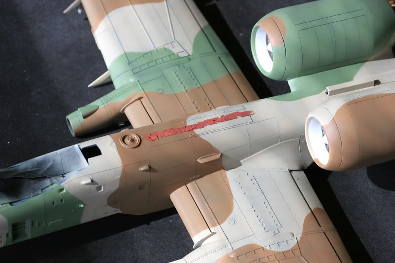

A lot has happened since I last posted anything about my "SandHog". I loss my job of 8 years at Ford Motor Company, got a better job at Toyota and moved to California! After losing my job, working on the hog was not happening and had to put my energy into getting a new job. But after I got the job, I had to move from Detroit to SoCal. So I pack up all my modeling stuff and very careful packed up the hog. She was pack in a $hit load of packing peanuts but when I unpack her, this is what I saw....  :o :angry:
Wings removed for the fuselage, one landing gear off, the blister with the fin on it came off,  the slats above the wing were removed, paint was worn down to bare plastic in a few spots and that crack on the top of the fuselage, which I had filled and fixed before, was back!  :angry:  Needless to say four months went by before I wanted to work on her again. I was inspired by "Scale Model Addict" on one of his shows; he said the build was about completion and not perfection and I like the sound of that. So this past weekend I bust out my modeling gear and got my SandHog back on the table and back to where she was before I moved.

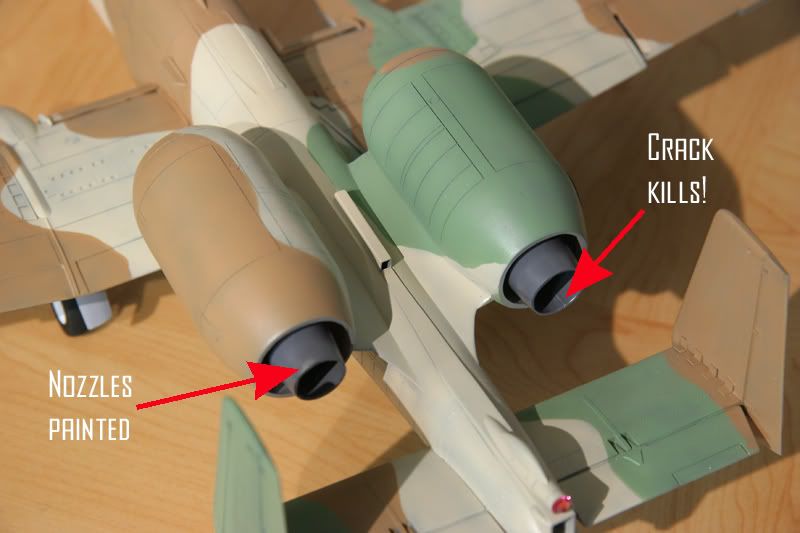

I finally got the nozzle painted and noticed a crack in the right nozzle  :angry:

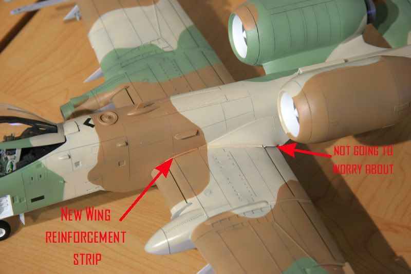

After super gluing the wings back on, I had to address the new joint. I just added a strip of styrene over the joint. By the time the IAF gets the A-10's the wings are close or at their service life. I added reinforcement stripes to the wing early, so why not add a new one to cover the joint? The fit in the rear is larger then I like, but I'm going to open that can of worms to fix it. I can live with it.
After some white out, some sanding and alittle paint, that crack in gone... for now. I also placed back the slats on top of the wings as well as the blister with the fin on it.

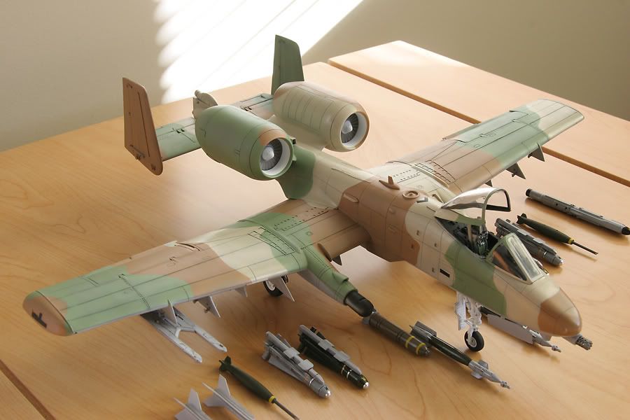

With a few supplies and a few hours, My Sandhog is back!

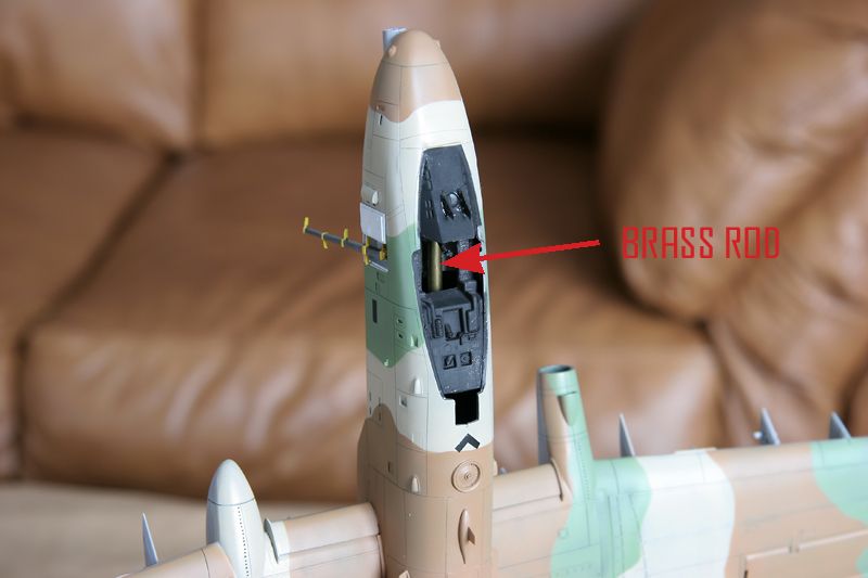

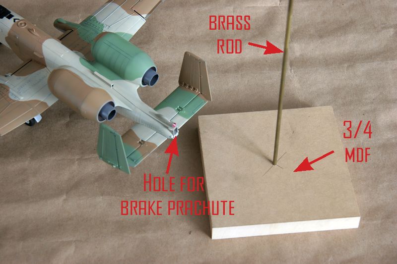

It's time for my Chazir to get her gloss coat(a few coats of future). I was trying to figure out how I was going to shoot my hog and not have to hold her a risk putting finger prints in her gloss coat. So, I got a piece of 3/4 MDF, drilled a hole for a piece of brass rod.
The break prachute has not been install, so I can slide the rod in the prachute housing, one hog on a stick.
Here you can see the rod going through the cockpit.
