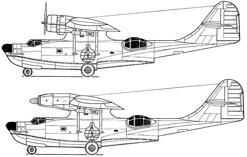

The Conroy Albatross
close enough for a shave!
I wonder if you could gain a few inches by mounting them a bit further aft on the wing. Though eventually the spar would be in the way of course...
Those nacelles come straight off an Andover but the engine could go backwards as it sits mostly over the spar.  There'd be a problem with cg though which is why they are so far forward.

How are these:
I like it.  A few real world worries with a DART however, that proposed drawing puts the blade arcs nearly directly in the path of the pilots-noise, spray, debris and throwing a blade would be of concern  :-\  Perhaps mount them a little further back.  Weight is not much of an issue-pretty close to the original engines.  Also worried that the DART might be too much power for such a high thrust line.  Changes in thrust would cause massive trim changes, and engine out performance might overwhelm the flight controls.  Perhaps throw some additional vertical surfaces on the tail like the CL-415.  Another high thrust, high thrust line aircraft, the AN-32, seems to be quite a handfull and has done poorly in engine out scenarios.
But this being WHIF, DARTS on anything look great- go for it. :thumbsup:
All of which are probably why the Avalon proposal mounted the Darts below the wing.  ;)
[/quote]
Below the wing does look good.
