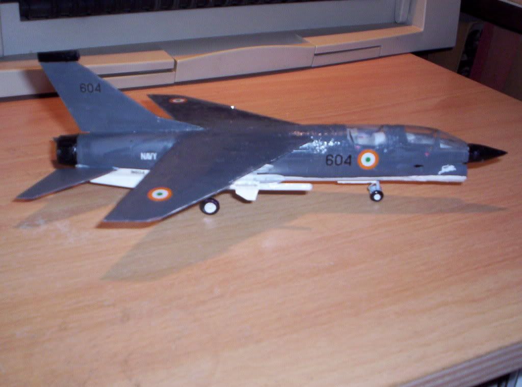

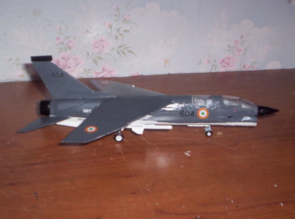

Archie, you work way too fast for a human!   :lol:   How did you blend in the second canopy in the back seat?
Archibald
As I said, it's blister pack ! I used strong glue... (this explain why there was fumes!).
In fact I glued it very carefully.. I glued only a side at first, then, carefully, the other side. With very few glue... it worked, and this time the plastic stayed clear. I also sanded and cutted some plastic after glueing the "blisterpack "canopy.
At the beginning, I planned to use a butchered F-16B canopy. Alas, after digging the second cockpit, I saw that the F-16 canopy was much too narow for it... god bless the blisterpack!  :lol:
I recognize  that digital photos mask sins  ;)
Thank you very much for the tip, Pollux and JHM ! I'll try that ASAP.
I carefully enlarged the intake (I supposed a turbofan needed much more air than a J-57).
In fact I compared F-8 and A-7s air  intakes before building(I can tell you that a 1/72 scale
A-7 intake is 1.7mm larger, against 1.4 mm for a F-8. This gave 21 cm in 1.1 scale )
alas, the exhaust is not from a spey (hard to find a F-4K!) it's from a M53. I shortened the fuselage (circa 1 cm) and build a new tail (I never liked the Crusader tail ).

Wow Archie that one's sharp as a tack! I particularly like how cleanly the upper and lower colors meet.
Archibald
Merci... this is the most difficult part. Damned white and bloody blue, which always tend to melt  :lol:
This time I used tape to have a straight limit between the two.

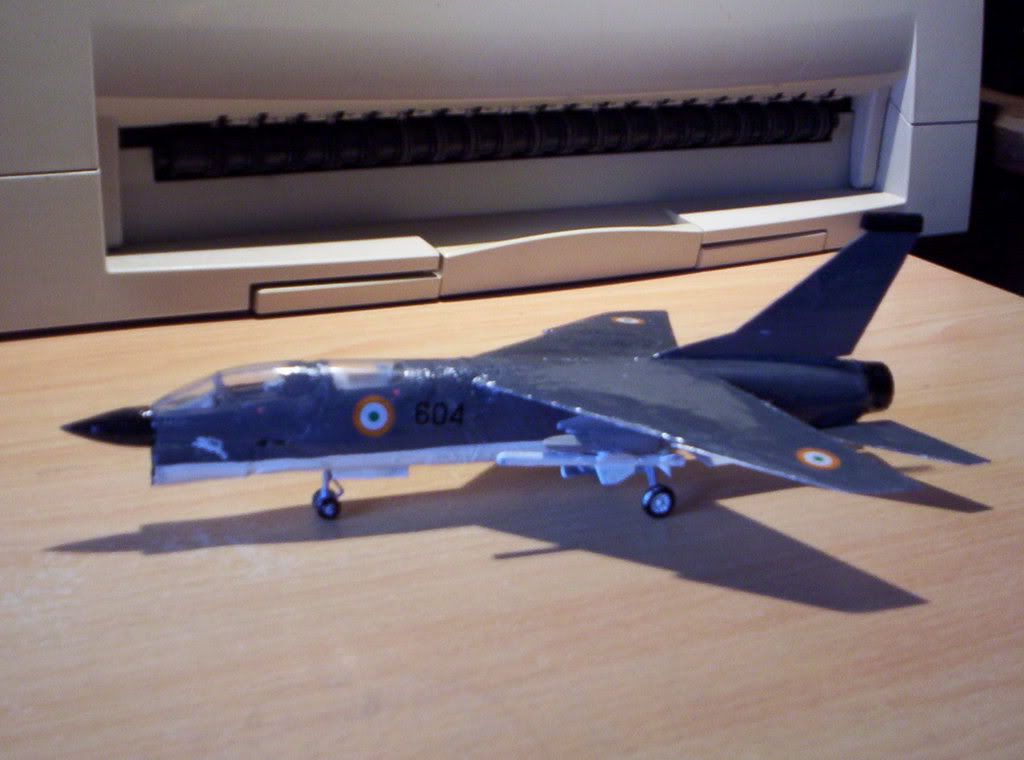

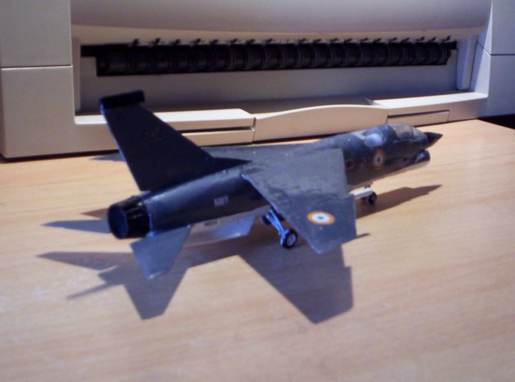

More pics!
Rafael
Archi, the pics are stored :rolleyes:  ;) . Now I'm only missing a pic from the front, capturing that gaping intake and the radome. I love its shape!! :wub:

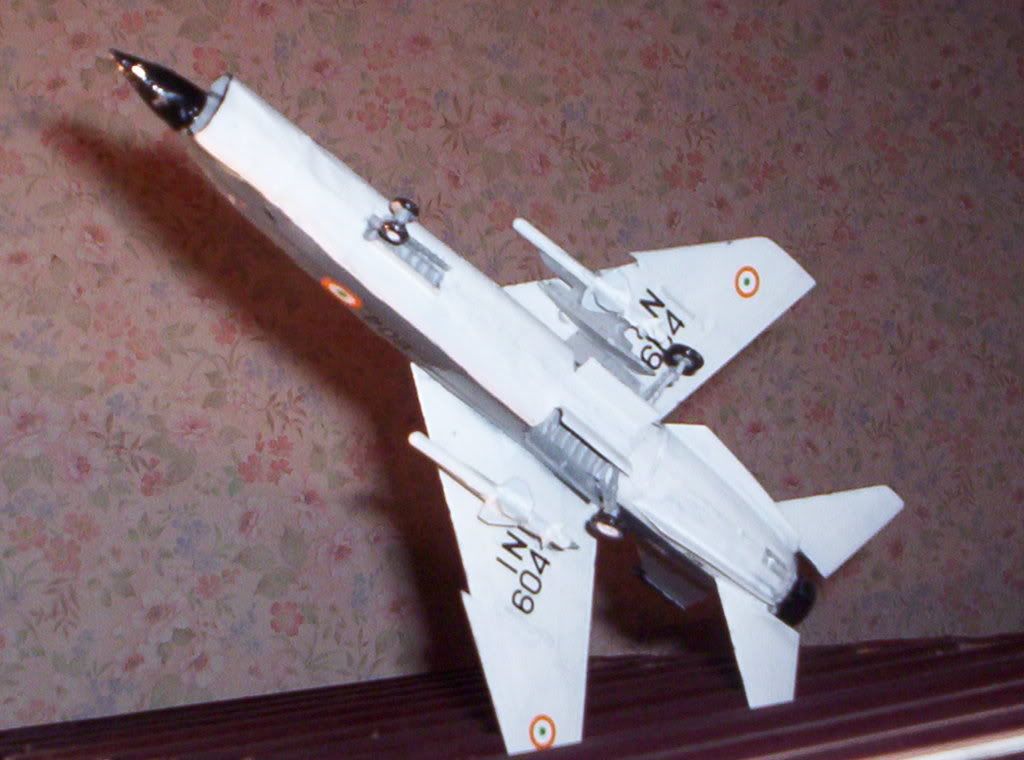

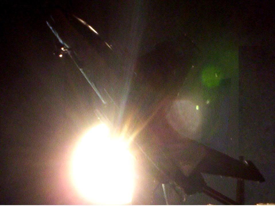

Indian Navy Crusader mk.1 IN.604 climbing over the sea...
Hmm I have to make some pics of the intake  ;)
