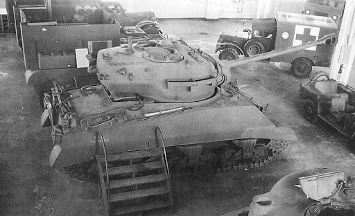

One thing that I have seen mentioned here, although I might well have missed it, is the practicality of some of these proposed turret swaps. Most "Shermanaholics" are aware of the proposal to mount the M26 turret with 90 mm gun to the hull of an M4A3. You've probably seen the well-known line drawings in Hunnicutt's Sherman and possibly even the known photos of the actual test conversion. (Apologies for exceeding 700 pixels with this image.)
(EDIT: A bit of a "D'oh" moment when I realized that the test vehicle in the photo is a late production M4 rather than an M4A3. I believe that the proposed "production" version was meant to be an "A3" with HVSS, however.)
The basic story for why this conversion was never carried out for operational use is that the Pershing was simply a superior tank to the Sherman and by the time sufficient quantities of the M26 turret would have been available, so were sufficient quantities of the entire tank! It's technically feasible to mix and match a number of US turrets and hulls, since the M4 family (including the M10 and M36 TDs), the M18 Hellcat TD and the M26 Pershing, not mention a number of experimental, limited production vehicles, used the more-or-less US standard 69 inch turret ring. What gets overlooked is the relative weight and size of the turrets and hulls. A big problem with the M26 turret on the M4 hull is that it made the resulting vehicle considerably more heavy over all, as well as considerably more top heavy with a higher and much less stable center of gravity. Although this bit of information seems to get over-looked, the top heavy and high center of gravity problem was also an issue with Shermans equipped with the T23 76 mm gun turret and the problem was greatly exaggerated with the experimental M26/M4A3 combo. Some relief could have been found in using the HVSS for production vehicles, as well as modifying the transmission in manner similar to the E2 "Jumbo" Sherman. However, the better solution was to fit the turret to a lower, longer and wider hull and, as we know, they already had that.
