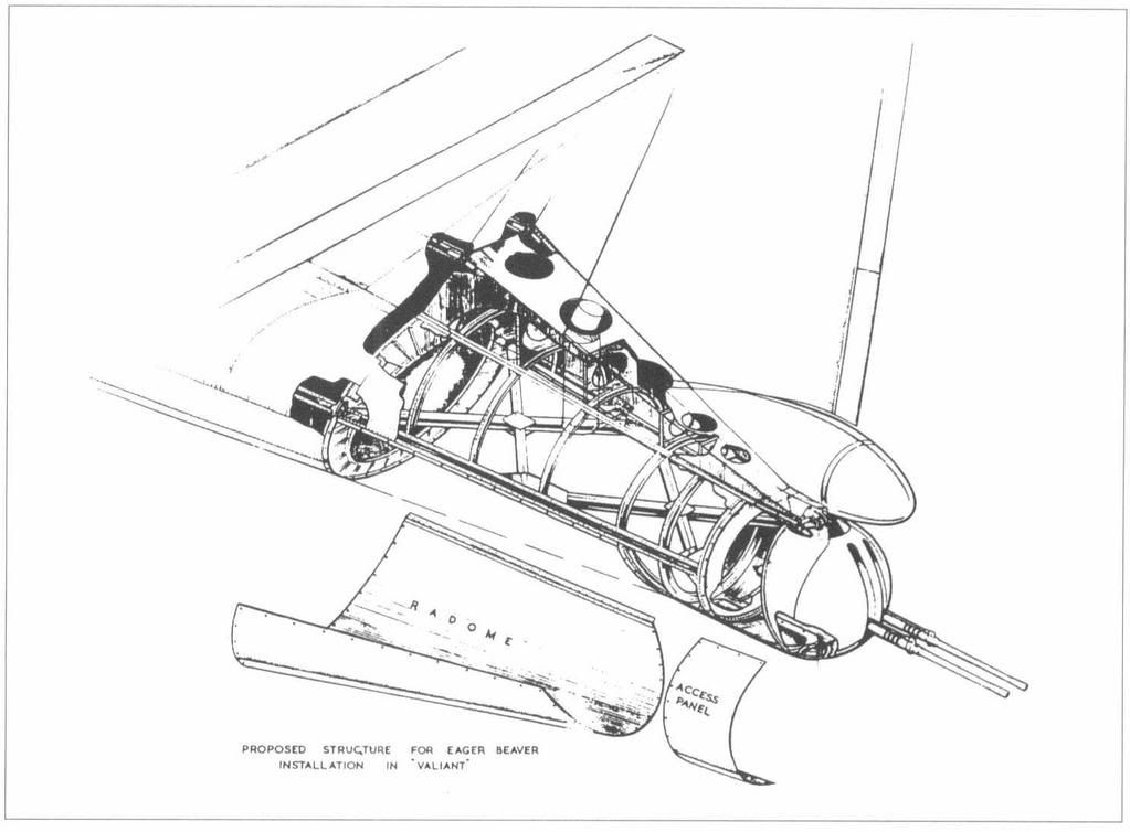

Does anyone know if there were proposals to fit the Victor (or the Vulcan for that matter) with a similar tail gun as proposed for the Valiant with the "Eager Beaver" arrangement:

The HP 98 was a proposed Pathfinder version of the HP 80 Victor and was to include radar-layed tail guns, no details.

I knew the pods were never trialed but I thought there might have been drawings.  Not to worry though - I've got some drawings of ones for the Valiant, so will do something similar.  Any idea where they would have been mounted - I'm thinking where the slipper tanks are.  Alternatively I could go the easy way and use some external TERs from a B-52.
Re the gun - same story.  I guess there is no reason why I cant use the Eager Beaver set up.

That gun system looks not unlike the setup for the B-47.  Maybe an old Hase 47 can be a donor?

Finally, re the tail gun - no pics, but I did find the following intriguing comment in the Ministry of Supply's Specification (No. B. 128 P - reprint from 1 Sep 1954 incorporating amendment 1 - 6):
                "Tail Armament
                     4.07  Deleted by Amendment No.4."
I wonder - did the original specifications (at least up to Amendment No.4), include a tail gun?  Any information?
