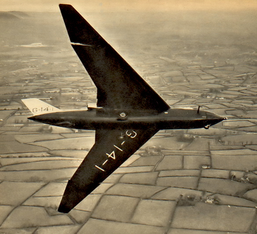

After a spell at London University, where he became a professor, Hill went on to work at Short Brothers post war, where he designed the SB.4 Sherpa tailless jet-powered research aircraft. This demonstrated that the tailless layout was suitable for a high-speed monoplane, implying that a piston-engined stressed-skin monoplane Pterodactyl-ish aircraft would have been possible and practical in the late 1930s:

The purpose of the SB.4 was to demonstrate the aero-isoclinic wing and as such isn't a
good model for a usable 1930s/WWII design. The aero-isoclinic wing ended up as a
curiosity because it wasn't any better than anything else.

The Sherpa still exists, but not flyable at present. It's in the Ulster Aviation Society's Museum at Long Kesh, and I saw it a few years ago.  It's in reasonably good condition as well, but in bits at the moment.

QuoteThe purpose of the SB.4 was to demonstrate the aero-isoclinic wing and as such isn't a
I only brought up the SB.4 to demonstrate that Hill's concepts were amenable to cantilever monoplane, all-metal, stressed-skin construction (i.e. "1939 modern"), to head off somebody saying "but the Pterodactyls were parasol monoplanes and that was obsolete by WWII". I am in no way suggesting that you could just stick a piston engine in an SB.4 and call it a 1939 fighter. Any actual 1939 Pterodactyl fighter would have been at some point of development between the Mk.V and the SB.4.

Back in the UK, he continued to promote his Pterodactyl VIII transatlantic transport, now with Short's. in due course the Short SB2 Sherpa became the last tailless swept machine in the Dunne lineage - built by the same company who had built his first successful tailless plane, the D.5, back in 1910.
