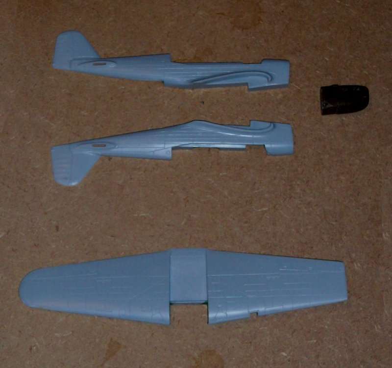

The basic components, with one wing tip already sawn off and resin engine ready to be grafted on

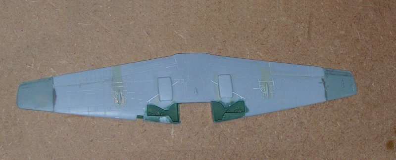

Modified wing with Spitfire type underwing radiators and extra fuel pumps. Note original square wing tips.
