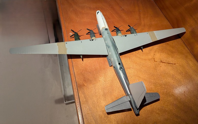

Here some first pictures of the test fit and testing of the overall layout. This is in 1/72.
PXL_20260222_174223477 by Buddy Holly, on Flickr
PXL_20260222_174306963 by Buddy Holly, on Flickr
PXL_20260222_174334682 by Buddy Holly, on Flickr
PXL_20260222_174404963 by Buddy Holly, on Flickr
PXL_20260222_174419274 by Buddy Holly, on Flickr
There are now 4 engines on the wings as the 2 outer nacelles are curing. So it'll have 6 engines when finished. Fuselage is still taped together.
I started this project about four years ago when I found a cheap 1/100-ish VEB antonov-12. It's fuselage was splintered as the brittle plastic was smashed by something heavy. It was like a puzzle.
While rebuilding the fuselage is found out the diameter of it's fuselage is the same as an 1/72 B-29. Besides this funny coincidence I figured the VEB AN-12 nose looks more like the G10N nose (dependant on  what source you follow) than the AN-12 nose. By grafting the AN-12 nose on the B-29 I could build an G10N! Now what wings to use? I figured an Messerschmidt Me-323 wing would fit the bill. So found an Me323 to donate it's wings. I figured some Mitsubishi J2M3 Jack fuselages would be great for nacelles extended by some He-219 aft nacelles beyond the trailing edge of the wing. Just like an XF-12 Rainbow the nacelles will be of the "straight through" type and the flaps (not installed in the pictures) will be cut to fit around the nacelles. Exhausts will be centralized to the extreme end following the additional trust ruling often used by late war japanese aircraft. Props are B-29 units with P-61 spinners.
I'm working on and off this project for quite some time now and it's taking shape. The fuselage is almost ready as a third bombbay is installed. Bombay doors are positionable. Bombs need to be installed, gunpositions will have remote aiming gear from an B-36 and reargunner will be put in aswell.
PXL_20260222_174854496 by Buddy Holly, on Flickr
Anyway, hope you like it..Keep on modellling!
David aka 63CPE

63cpe
Well, with those de six engines on, the proportions look more correct. Still it's got some serious wings as it needs to have. It 's bigger than a B-29.
Will post pictures with all six engines on soon.
David aka 63CPE

63cpe
#8
As promised here some pictures with six engines on.
PXL_20260223_201654827 by Buddy Holly, on Flickr
PXL_20260223_201721012 by Buddy Holly, on Flickr
PXL_20260223_201734455 by Buddy Holly, on Flickr
It's span is 76 cm which is in real life 54,72 meter.  Still 15 meter short of an B-36 span an about 10 meter short of the "real" span of the G10N.
Length is 49,5 cm without rear guns. That's in real life 35,64 meter. Again about 10 meter short of the "real" length of the G10N.
So, it's big but not as ginormous as the "real" G10N or the B-36.
Then again as it's a tad smaller than the "real" G10N it seems to me more realistic to a war industry that is short on stategic materials. Another argument are the engines the J2m3 nacelles can take the 1,34 diameter Kasei engine. So can easily take the smaller (1,23 meter) Mitsubishi Ha43/MK9 engine of 2200 HP which were readily available than the planned but much more complicated Nakajima Ha54 36 cilinder 5000HP engines.
David aka 63CPE
