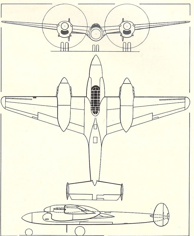

Interesting looking proposal from 1938.
Twin Merlins, quad cannon either side of a pressurised cabin and an internal bomb-bay.
http://s37.photobucket.com/user/GTwiner/media/XP-65%20etc/scan0001.jpg.html
http://s37.photobucket.com/user/GTwiner/media/XP-65%20etc/scan0002.jpg.html
I can't find much online except for postings on forums mentioning it in passing.  Apparently the Air Ministry were dubious about GALs ability to produce it.
Wow! Looks like a love-child of a Moonbat and an Me-110.

And lateral visibility that ain't worth spit

It was a high altitude interceptor, that could perform bombing and recce missions also.  I was a competitor to the Westland Welkin which won the competition.  It's mentioned in BSP Fighters and Bombers, if there's any more info in there I'll dig it out.
Quote from: Flyer on May 29, 2015, 03:12:47 AM
It's a very pleasing shape. :cheers:
I thought that when I first saw it.  It looks quite muscular compared to other high altitude fighters with their long, thin wings.
Very cool. And start with P-40 wings. Nice find !

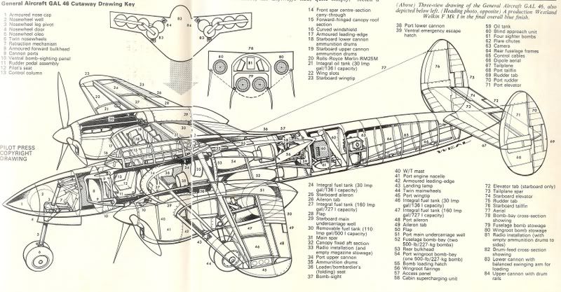

Quite a lot more than I remember, a whole page.  From British Secret Projects: Fighters and Bombers 1935 to 1950
Crew:  2
Length:  52ft 0in (15.8m)
Wingspan:  41ft 6in (12.6m)
Gross wing area:  385ft2 (35.8m2)
Max Weight:  Fighter 15.704lb (7,123kg), Bomber 17,845lb (8,094kg)
Max Speed:  395mph (636km/h) at 20,800ft (6,340m)
Rate of Climb at sea level:  2,940ft/min (896m/min)
Rate of climb at 9,000ft: 3,185ft/min (971m/min)
Time to 20,000ft (6,096m):  7.1 min
Time to 30,000ft (9,144m):  14.0 min
Service Ceiling:  37,200ft (11,339m)
Range (recce mission):  2,250 miles (3,620km)
Internal Fuel: 190gal (846lit)
Armament: 4x 20mm cannon (two could be reversed in their mountings to provide rear defence), later 6x 20mm, 4x 500lb bombs
Engines: 2x Merlin RM.2.SM at 1,295hp, later 2x Merlin XX at 1,1750hp
