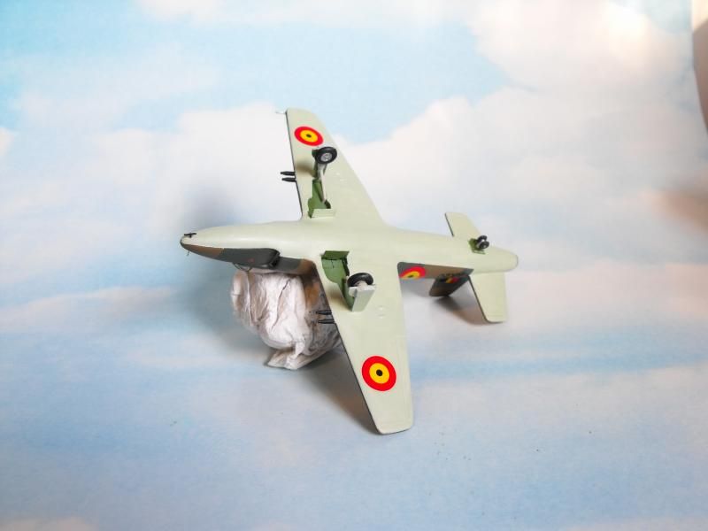

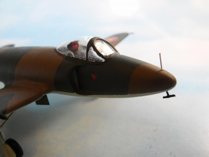

This was the Frog/Novo model, and shows the typical short-comings of Soviet era plastic. The canopy is thick and streaky, and the plastic is rather brittle. Despite this, it seems an easy build, and I would do one again. It was purchased from a show, partly built, and for a couple of bucks it was worth every penny (but not a penny more!). the previous owner had carved out the main landing gear bays, saving me a bit of time. I removed the solid cockpit, and scratched a minimal interior, not much can be seen through what masquerades as a canopy. The molded-on tailhook was removed, it would have been too much work to construct an acceptable one. The kit's tailwheel is a single unit, rather than the double wheel of the actual aircraft, so that was scratch built. Rather than construct a tiny little well for it, I just painted that area in interior green, looks okay from a distance. Even better if you don't look at all. The main wheel inner doors, and the tailwheel doors, were replaced with plastic sheet. If scaled up, the kit parts would be about a foot thick. The nose aerials were also a bit of scrap and some stretched sprue. Paints were mostly brushed Model Master enamels, and didn't go on very well, not impressed with them at all. The decals came from a Hobbycraft CF-100.
That looks impressive in Belgian colours, nice job, especially from such a poor original kit.  :thumbsup: :bow:
