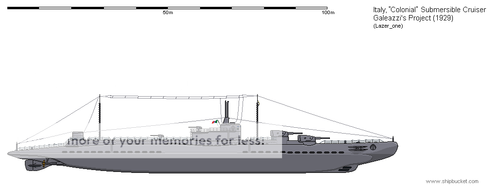

QuoteThe only steam subs to see service were the British K class which were notoriously problematic
On the contrary the French operated a number in WW1. The Germans had a huge U-cruiser with steam propulsion, the Projekt 50, under construction in 1918. The Italians had a steam design that had 2-twin 6" turrets in 1929.
The US had a number of contemporary designs along  with this one, carrying everything from 8-8" guns to half a dozen planes.
