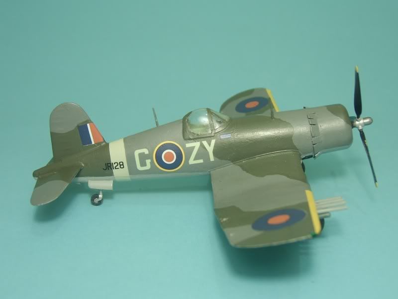

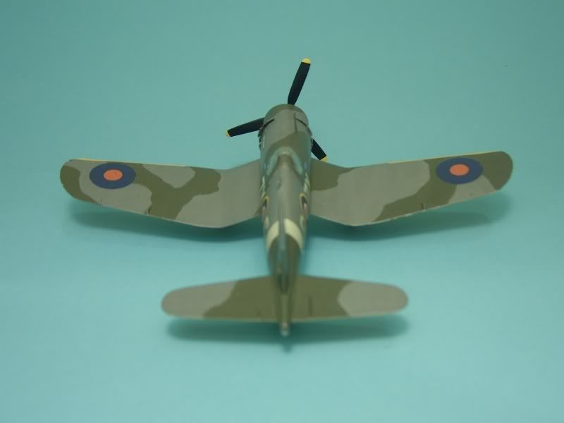

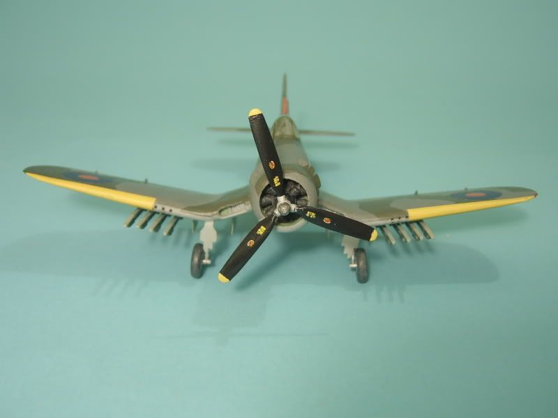

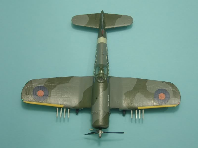

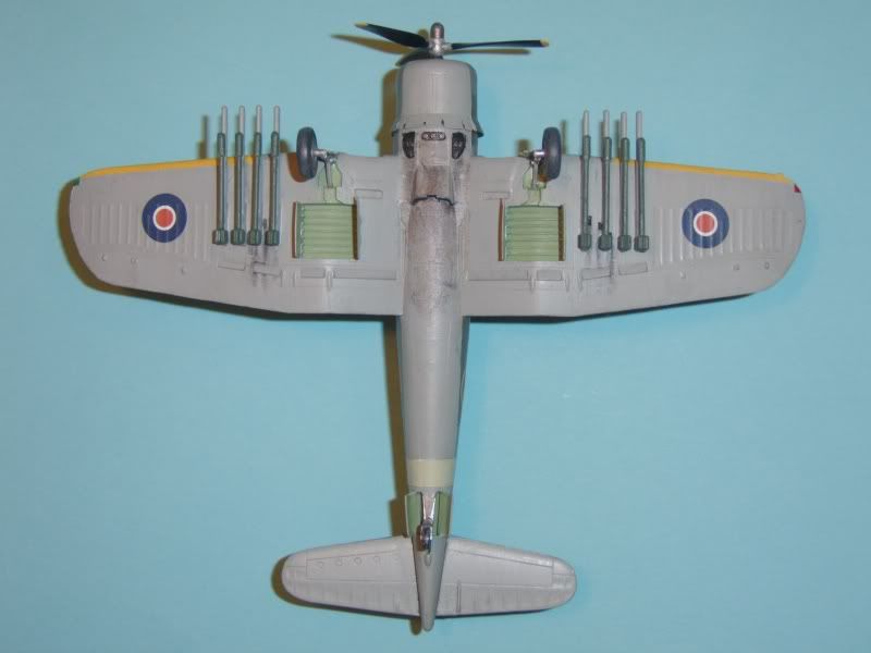

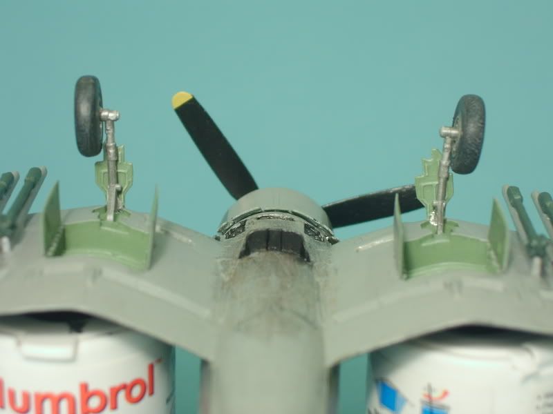

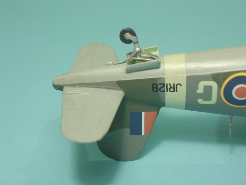

The kit is the Hobby Boss F4U-1 Corsair, with a few minor mods to turn it into a land based aircraft.  It was intended to be a quick build, but took me a while longer than I hoped, as always!  To portray a land based version of the Corsair, I shortened the tail wheel doors (too much in hind sight) & filled the gap that the arrestor hook would fill.  I also added a lighter set of main undercarriage, slightly modded.  These also came from a Hobby Boss kit, the P-40M that I whiffed as a floatplane & it was fortunate that these were left over as they operate in the same manner as the Corsair's undercart.  The only trouble with them is they are quite thin & have started to bend already.  I robbed some British 60lb rockets from the Airfix Beaufighter, for no other reason than to give a different look to the usual American RP's seen on bothe British & US Corsairs.  This made life a little difficult as it meant detatching the tray that was unique to the Beaufighter & filling in the location slots on the Hobby Boss kit.
I had a few problems of my own making, including thinking I could get away with priming the surface.  When I masked the undersides, I realised that paint was pulling off & I had to prime the upper surfaces, which left a paint step. It isn't too noticeable looking down at the model on the bench.  I also should have painted the yellow wing strips & the sky fuselage band first, although suprisingly these didn't cause me much bother.  Although it doesn't as look bad in the pics, believe me the canopy is a mess & it's something I want to sort out for future models.
I used some decals from the Airfix Typhoon which had a Jekyll & Hyde personality, they were beautifully matt & thin, but they were hard to budge once on the model & their thinness caused them to fold & tear easily.  This called to an end my first choice of 183 Sqn.  The B roundels had a slight white ring on one side which wasn't apparent until I got them on & an attempt to clean them up made things worse.
I had a whoops moment with the prop.  Put it down, couldn't see where it was, then I found it, right were I put my hand down! :banghead:  Several attempts to glue it failed so I had to drill holes to pin two of the blades.  The only probs I had that weren't of my making were two of the cowl flaps broke off with minimal handling & needed replacing with plastic card, & the forward door for the left undercart would not go on straight no matter how much I coaxed it!
The aircraft a Chance Vought Outlaw Mk.I in the markings of 247 (China British) Sqn RAF.
I like that Simon  :thumbsup:  I think it would have been more than capably carrying a load of RP's like that.  Out of interest, when reading the P-47 in Action book it sort of insinuates that the RAF used these types of RP's on the P-47 in the Far East so I loaded one of mine out like what you have done here.  Definitely looks plausable.

Robert, I remember reading something similiar, basically that the ordanance would be swapped over some times & I vaguely remember reading that the USAAF used the 60lb RP on occasion, although I could be wrong.  It kind of makes sense, the US RP's & the British 25lb were designed for armour IIRC, the 60lb'ers were used if you just wanted to blow a big hole in something & I don't think the Americans had an equivalent?
