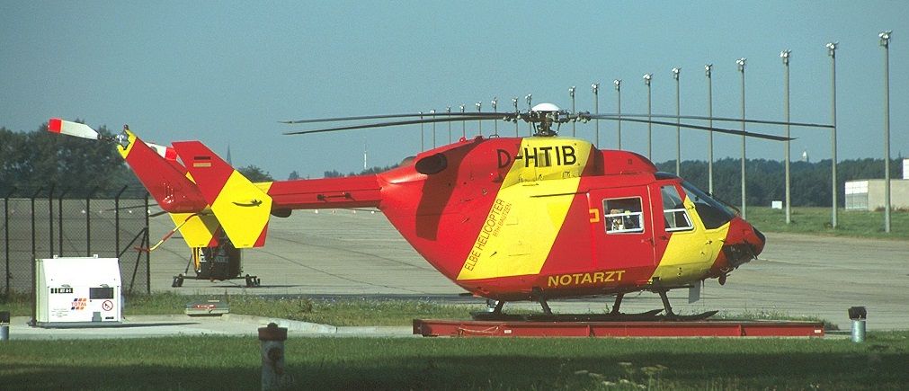

Following my recent trip to Germany I've developed a bit of a thing about ADAC helicopters (more about them elsewhere)
I've bought various 1/72nd scale BO-105s, BK-117s and EC-135s and have ended up with a spare BK-117, which I intend do do as below
From those of you with much greater experience of undercoating and masking for 'bright' schemes as below ......any tips please?
Probably spent more time than is healthy painting a Bear's bottom!

"Good luck"?  :o
Common sense would suggest a yellow base coat overall on top of a very light primer base, then masking the stripes and add a coat of red.

Despite what you might think, the best colour for an undercoat for yellow is PINK, not too dark a shade.
The red would also go perfectly well over that.
Jim
I thought I'd seen about pink as an undercoat for yellow very recently on here? But I can't think what the model being discussed was?

Yup, pink is probably one of the best undercoats for yellow, especially if using a brush. Make sure that as Jim says it's not to dark a shade though. I have a bottle of Vallejo Pink which I then use in a ratio of about 1 pink to 4 white to get my base coat.
As for masking ? You could always "seal" the edges of the masking strip with Klear or similar. You mustn't be heavy handed with it and in all honestly you need to be minimalist with it, otherwise you will pull paint up, but with care it will work on something like that where it might be difficult to seal the masking strip properly simply by burnishing.

Another way to seal the edges is to give the model another light coat of the masked-off colour AFTER the masking's applied. That means that any runs or bleeds match the masked off colour instead of contrasting with it. In this case, you'd spray overall yellow, then mask off the yellow stripes, then give it another coat of yellow, then red. Any leaks would be yellow-on-yellow and therefore ignorable or at worst, easier to clean up.
Okay - I think I follow that - but why doesn't the final coat of red not leak also in the same place as where the second coat of yellow might?
Sorry, good question (didn't explain that too well) ! The red doesn't leak because the second coat of yellow has already sealed up the gaps in/under the masking. We're generally talking about tiny gaps in corners or slight creeps where the edge of the masking tape isn't burnished down properly. The second coat of yellow should be more than enough to seal such gaps: if they were any bigger, you'd see them and do something about them at the masking stage.
You have to be careful not to overdo the sealing coat mind you, otherwise you end up with a massive step at the mask line.

Runs and leaks happen when masking isn't perfectly sealed to the surface right? Either there's a panel line going under the edge, or there's an internal corner that you just can't get the tape fully down into, or there's a gap between pieces of tape that you missed burnishing down, or something else like that. These tiny gaps let (in this instance) red from the second coat leak onto the masked-off yellow from the first coat. Because the gaps are small, the red also seals those gaps, so that, if you were, for instance, to spray black on next, the black wouldn't leak under the masking in the same way.
The trick is to exploit this sealing effect in a positive way. If the next coat of paint after the masking is the same colour as what's under the masking (yellow in this instance) then a) the leaks won't matter because they'll be the same colour as the first coat, and b) the leaks will seal the gaps so that when you put the red on it won't be able to leak.
Thanks Weaver, your further explanation of your initial explanation clarifies that nicely for me  :lol: I presume the same masking approach would work perfectly for things like RAF Target Tug aircraft etc
