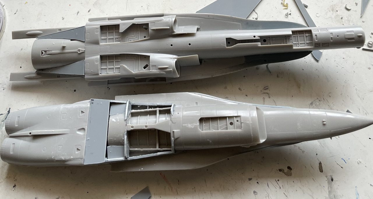

I have the idea of a single engine F/A-18 and a twin engine F-16 for a long while. Finally, I'm motivated myself enough to make both. Both are from Hasegawa in 1/72 scale. To my surprise the width of the mid-aft sections of both aircraft are almost identical, at least in 1/72 scale. Fusing the fore section of the F/A-18 with the aft section of the F-16 is a breeze. I couldn't say the same for fore section of F-16 with aft section of F/A-18, there are simply not enough contact points to glue them together securely.

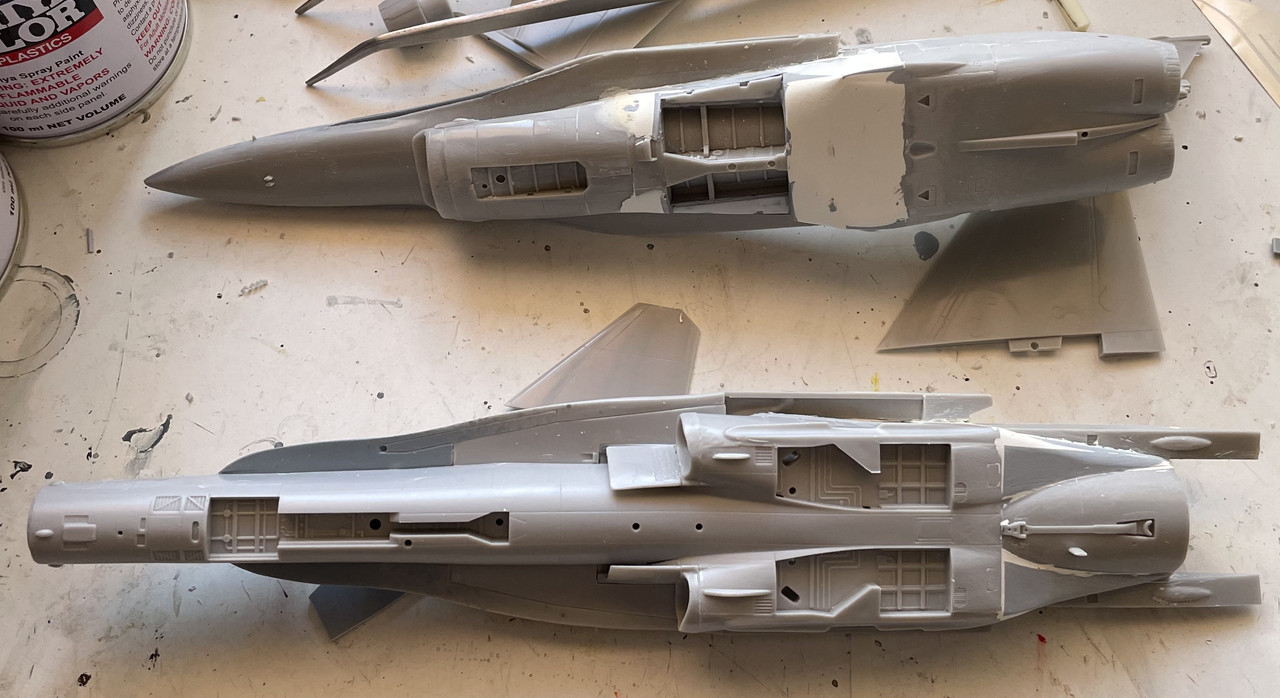

After applying some putty and sanding, things started to look better. The F-16TE continued to be a nightmare to work on. I had to reworked it a few times to a point I nearly wanted to chuck it in the bin. but the F/A-18TE went on smoothly
Firefox
Finally, both started to look good. more putty and sanding. Originally, I planned to re-do the F-16TE main landing gear housing. But the time spent on the re-work in the beginning meant that I have to leave it as is and applied a simpler solution as seen here.
