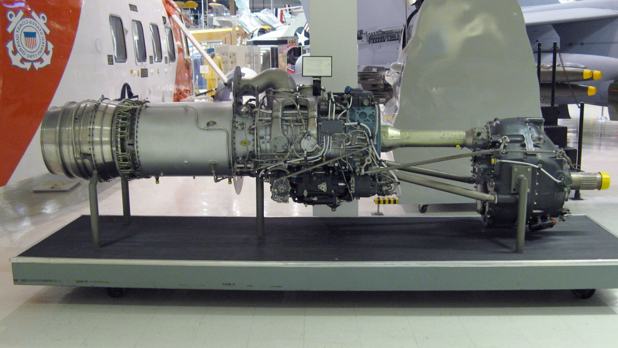

Quote from: jcf on September 13, 2022, 09:55:35 PM
Many times I've looked at pics of that engine and thought "why"...........
Quote from: kerick on September 27, 2022, 09:20:17 PM
Mounting options, rotate the gearbox 180 and you have an installation for a low wing aircraft.
T56 from a P-3.
I always wondered if the whole engine assembly was flipped for that. The thing I wondered the most was why that driveshaft was so long. Logical engineering reasons I'm sure.
Quote from: kerick on October 06, 2022, 05:27:28 PMI always wondered if the whole engine assembly was flipped for that. The thing I wondered the most was why that driveshaft was so long. Logical engineering reasons I'm sure.
Airflow into the engine; air comes in via a chin (or top) intake, then has to be made to flow up (or down) around the driveshaft so that the air enters the engine relatively evenly across the face of the inlet; otherwise you end up with significant stresses all through the engine, from the compressor blades, through the combustion chamber & on to the turbine blades; which would lead to extreme vibration & then bits of metal being ejected at considerable velocity out of the fuselage, or out of the nacelle into the fuselage.
I guess I didn't realize the intake face was in that position but where else would it be?
Quote from: kerick on October 08, 2022, 09:49:04 PMI guess I didn't realize the intake face was in that position but where else would it be?
Well the PT6 intake is at the back end of the engine, exhaust at the front.
#13
Intake for the Bristol Proteus is also at the rear, unlike the PT-6, it is also a full reverse flow
engine which exhausts at the rear. The installation in the Bristol Brittania, for example, has
an annular intake at the front around the full circumference of the nacelle.
And the A.S. Python also had the intake at the rear, plus the reverse flow idea with exhaust at the very rear with a similar burner arrangement.
