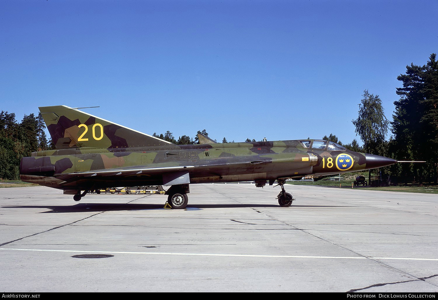

Finally a good excuse to apply the famous and complex "Fields & Meadows" paint scheme to a Draken model! However, this "combo" actually existed in real life, but only on a single aircraft: around 1980 a J 35 B (s/n 35520), aircraft "20" of F18, was painted in this fashion, but AFAIK it was only an instructional airframe.
You find some pictures of this aircraft online but getting a clear three-side view (esp. from above!) as a reliable painting benchmark is impossible. However, a complete paint scheme of this aircraft is provided with one of Mistercraft's Revell Draken re-boxings (not the one I bought, though), even though it is mismarked as a J 35 F of F10 in the instructions. One of the common Mistercraft errors, err, "surprises" (*sigh*).
Finding suitable model paints for the elaborate scheme is not easy, either, and after having applied it several times I stuck to my favorites: Humbrol 150 (Forest Green, FS 34127), 75 (Bronze Green), 118 (US Light Tan, FS 30219, a bit light but RAF Dark Earth is too somber) and Revell 06 (Tar Black, RAL 9021) on the upper surfaces and Humbrol 247 (RLM76) underneath.

- The "fields and meadows" camouflage was actually tested on TWO J35B, one of them on your pic above, Thomas. And they were flown in that disguise, even if not much. As we know, the camouflage was quickly transferred to the AJ37 Viggens, then in service since four years, and final testing was done on that platform.
