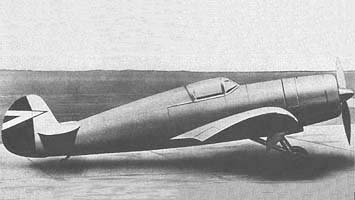

This fighter plane was basically a He 112 B, throughly adapted to local construction principles and capabilities. The wings were wooden versions of the He 112s complex planform, the fuselage was made of a plywood over a steel frame. Overall, shapes and dimensions were very similar to the He-112, but under the hood the Hungarian aircraft differed in many details, and the use of wood raised the weight markedly.
The WM-23's engine was to be a domestic product, too, and the choice fell on the 14 cylinder two-row radial WM-K-14B, a license-built version of the 1.020 hp Gnome-Rhone Mistral-Major. Due to the extensive use of wood, it would seem that this 'simplified' plane would be inferior to the highly sophisticated He 112. But in fact, the higher powered engine made, thanks to the airframe's excellent aerodynamics, all the difference and the WM-23 proved to be even faster than the original He-112. Furthermore, the indigenous design did not lack any substantial maneuverability and the simple radial engine would also ease field maintenance and reduce vulnerability, since the complex and touchy radiator system of the original Jumo 210 could be omitted.
The proposed armament comprised two synchronized 8mm Gebaur machine guns in the fuselage and two 20mm MG 151 cannon in the outer wings, even though the first prototype only carried a pair of 12.7mm Danuvia (Gebauer) GEP machine guns.

The prototype WM-23 was flown for the first time in September 1941, and demonstrated good flying characteristics, but suffered intermittent aileron oscillation. It took a while to figure out a solution for this problem, and the development program, in which a second prototype joined, was further hampered in the late spring of 1942 when the starboard aileron detached in a climb of the 1st prototype, forcing the pilot to abandon the aircraft.
Nevertheless, work proceeded slowly with the second aircraft, and in April 1942 the WM-23 was, after some detail changes like a modified cowling and re-contoured stabilizers, cleared for production. This basic fighter variant was officially designated WM-23A.

The Hungarian WM-23 might appear obscure, but it actually existed as described and made it to the hardware stage in the form of a single prototype. I stumbled upon the aircraft in a Squadron Publishing book about the hapless He 112, and found the idea of a radial engine variant interesting. I had a spare Heller kit in my stash, and also found a suitable donor engine – so the decision to build/simulate an in-service WM-23 was made.
As already mentioned, this is the He 112 B kit from Heller, a simple but very nice offering from the late Seventies. You get decent interior detail, but raised panel lines, and the kit was originally built more or less OOB, with adaptations to the real WM-23's outlines.
First of all, the original inline engine was replaced by the complete nose section from a vintage LS Model Ki-100, which was in itself modified with an opened front end, an engine dummy inside, and new cowling ring and an improvised three blade propeller.

Further mods to come closer to the WM-23 and away from its He 112 ancestor, the canopy was cut into three pieces and the originally fixed, rear part was replaced with a spine (actually a part from an Academy MiG-21F drop tank) and merged with the fuselage through PSR work.
The flaps were cut out and mounted in a lowered position, and, finally, the He 112 B's relatively huge stabilizers were replaced by much smaller, more rounded-off parts (IIRC from an AZ Models Spitfire V).

Once the basic build was done I was a bit puzzled, though. Something was not right, the proportions did not look good. At first I blamed it on the hunchback look of the added spine – but there was something else... I had some schematic drawings of the WM-23 at hand and realized that their printouts were almost exactly 1:72. So I matched the model with the aircraft's supposed outlines and found that the real aircraft had a much shorter rear fuselage section! On the positive side, anything else, esp. the implanted new radial engine, was a very good match.
1:72 Manfred Weiss WM-23A 'Ezust Nyil'; 'V-519' of the Magyar Királyi Honvéd Légierő (MKHL; Royal Hungarian Air Force), 2/3. Vadasz Szadad 'Ricsi'; Mátjásföld/Budapest, late 1942 (Whif/modified Heller kit) - WiP
by dizzyfugu, on Flickr
Anyway, in order to mend the issue the only option at this stage was to cut away a ~7mm plug from the fuselage and blend it over with more PSR, sacrificing much from the fine but risen panel lines on the kit's surface. Hrmpf...!
It worked well, though, more or less, and now the aircraft looked much more balanced! Further detail work concerned the characteristic exhaust arrangement on the flanks. Hollow steel needles were used for the MG 151/20 barrels in the wings. Cockpit and landing gear were taken OOB, I just added a pair of outer covers and some details inside of the landing gear wells, everything scratched with styrene strips and sheet.
