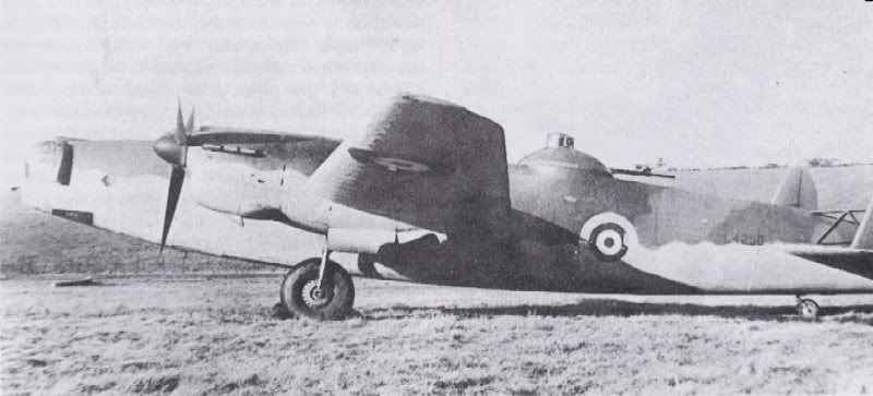

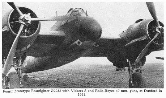

Incidentally a Beaufighter was trialed with twin 40mm cannon in a similar configuration.
Came across that Beaufighter prototype, too. In Australia, IIRC? Looks pretty harmless, though, the guns are pretty much buried in the lower front fuselage.

Quote from: Dizzyfugu on June 29, 2017, 07:06:49 AM
I can't find the photo I've seen at the moment, but my reference says it was tested at Duxford (doesn't mean there wasn't another one, perhaps "unofficial" ?). It had Vicker's and Rolls Royce guns fitted, both of which had been especially designed for it. Trials went well and the Vicker's was the winner. Beau never got it though, but the Hurricane did.
