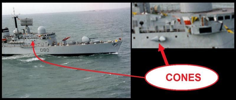

I would get the flight deck on pretty soon, the fit is not great and you'll need to do a little work to blend it in to the rest of the fight deck to get a seamless join.
Nice work so far and yes that's the way to build them spraying the detail parts on the sprue, spray the etch to as its easier to touch up than to completely paint once attached. See if you can get gator glue as they do a version especially for PE its more forgiving than Super Glue. Look forward to seeing it done  :thumbsup:
If you want to do her actually in the Falklands campaign, don't forget the black stripe on the funnel and the Union Jack on the bridge roof!
If you want to be really pedantic, she also had the conical TV aerials rigged on the sides of the forward superstructure when she was hit. You can see them in the pic you posted, but I think I'm right in saying they arn't included in the kit.

You're welcome. Given how vague some OE bits are on 1/700th ship kits and how simple the aerials' shape is, you could probably just carve them from sprue and they'd pass.
Give the size of the cones in 1/700 I would possibly stretch sprue, trim off the string and shaped the tip to a cone before trimming whilst wearing a good set of magnifying specs as they are tiny in scale !

A fair point. Does anyone have any photos showing more of the ship relative to them? I'm having trouble visualising the location in that Getty Images photo.
Zac in NZ
https://linktr.ee/zacyates
#11
They're visible in the photo you posted Zac: just below the 20mm Oerlikon.
