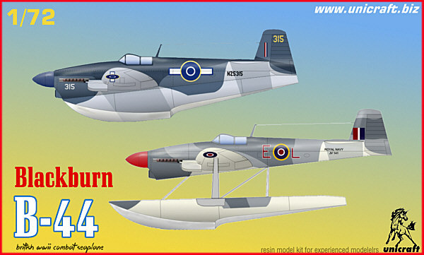

I feel it's always nice to have pictures so we know what we're talking about.
Never heard of it ! Looks strange in both configurations. Kinda like a Spitfire as well.
The B-44 was a lot bigger than a Spitfire, not the least because it was effectively a Firebrand with a retractable hull grafted onto the bottom.
The Firebrand was a BIG aeroplane for a single engine, single seat 'fighter', 51 ft. span and 11500 lbs. empty!
Got to admit, the retractable float is a clever solution to how to have a single-engined fighter floatplane and not suffer the massive drag from a separate float.

Actually it was to have an elliptical wing Kit, it looks more like a P-47 wing, or a Fairey Firefly wing
http://www.unicraft.biz/on/b44/b44-dr.jpg
Kendra/Robyn should be able to work it out from here
Yes, I saw that, but that was presumably because its role was as an interceptor rather than a torpedo truck like the Frirebrand. The rest of the B.44 was based on the Firebrand, it's mentioned in other places and the fuselage and tail are pure Firebrand.
While the retractable float is a great idea to reduce drag, it does rather give it the look of a pregnant guppy.   I'm wonder if a better idea might have been a retractable float with an inflatable top?   Make the bottom, planing surface of metal but make the top inflatable so when it's retracted, it collapses and folds down much smaller?
That's a good idea! It introduces another possible failure, though - if your float bursts, or is punctured by a bullet, or if the compressed air bottle and/or hoses fail, you can't land. And that's on top of the float retraction mechanism.
Quote from: pyro-manic on December 12, 2014, 04:57:22 PM
Always a problem with flying boats - you get a hole in the hull and you're stuffed.   The inflatable upper surface could be made self-sealing for the small holes.  Anything it can't fix, a non-inflatable one isn't going to be any help anyway.   The inflatable section could be compartmentalised anyway.   As for the retraction mechanism, thats a problem in any modern aircraft, whether it's wheels or floats.
