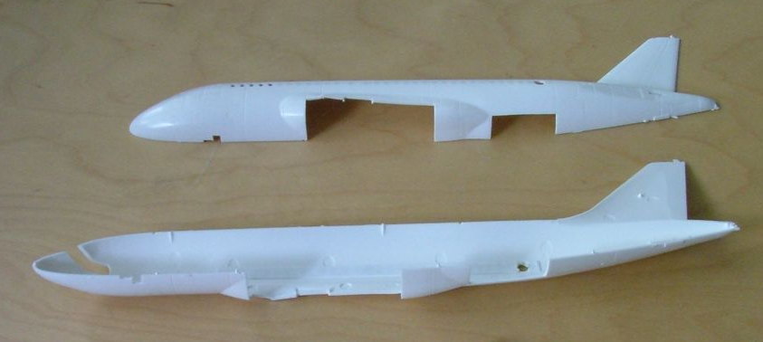

Here are the fuselage halves, with the windows filled in, a large hole for an observation window drilled out and the torpedo bay doors removed. I've also prepared some plexiglass rod in a dome shape for the observation window.

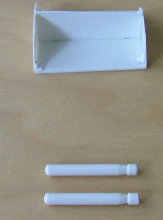

The torpedo bay and two of the torpedos that will go in it. The Airbus website shows 8 torpedos that are stacked in two layers. The torpedo shapes are meant to represent a Mk-46 or Mk-54 torpedo (although I haven't been able to find complete photos of the Mk-54, the nose is always covered up).
Interesting that the weapons bay is where it is, I think the 737 Mil version (P-8?) has it in the same place too. I can't help thinking there'll be a serious CoG change when they drop something though. Is that mentioned anywhere in the specs?
The location is a consequence of the aircraft construction, I guess. Any closer to the CoG and you'd be inside the wing box.
The website mentions that there are extra fuel tanks in the cargo area, maybe there's an arrangement to pump fuel aft when a weapon is released.
