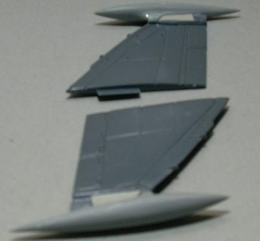

Just to begin:

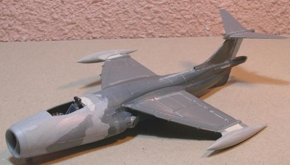

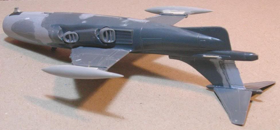

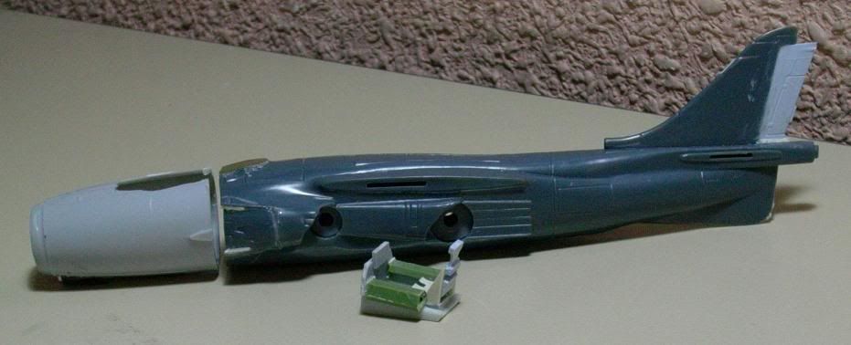

First steps of Camm Ca-7
#3
That is actually a pretty darn good fit!!! Wouldn't think that would work so well! ... May have to try something like that someday myself  :cheers:
Also which aircraft did you use for the front?

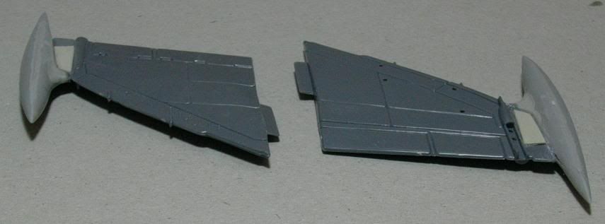

Somehow, I don't know why, I consider those curved lines around tip tank as British Coolness. :party:

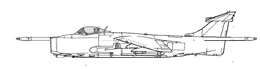

This looks like an evolved version of the Yak-36:
Or was that the plan all along?
I have to admit that the boom can look very cool; but I think that I will not install it because I do not see its practicallity.
Great project!  :thumbsup:
IIRC, the boom carried the forward reaction control jets, the idea being that if they were further away from the C of G, they would have more leverage for the same power. This mattered a great deal when engine power was marginal and they wanted to bleed as little air as possible for the RCS. The Harrier had a long enough fuselage and a powerful enough engine that it could get away with having the front nozzle under the nose.

I think, more or less, the same. :thumbsup:
Mr.Creak
The Harrier is also helped with regard to the length from CG for puffer pipes in that it's a four-poster, as opposed to Freehand's two-poster lift engine.
