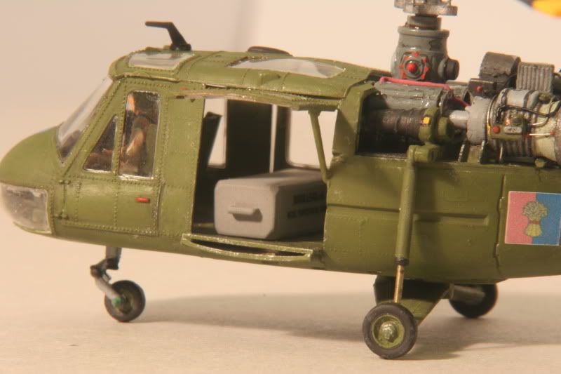

Another option for appropriate types is heavy cargo. I did this for my Avro-Cierva Dragonfly, because I eventually intend to have it flying in a diorama, so I didn't want to add any permanent weight. The cargo is removable:
The box is just Evergreen glued around a collection of lead strips.
I think somebody else did something similar with a fixed-wing model, but I can't remember who - sorry.
